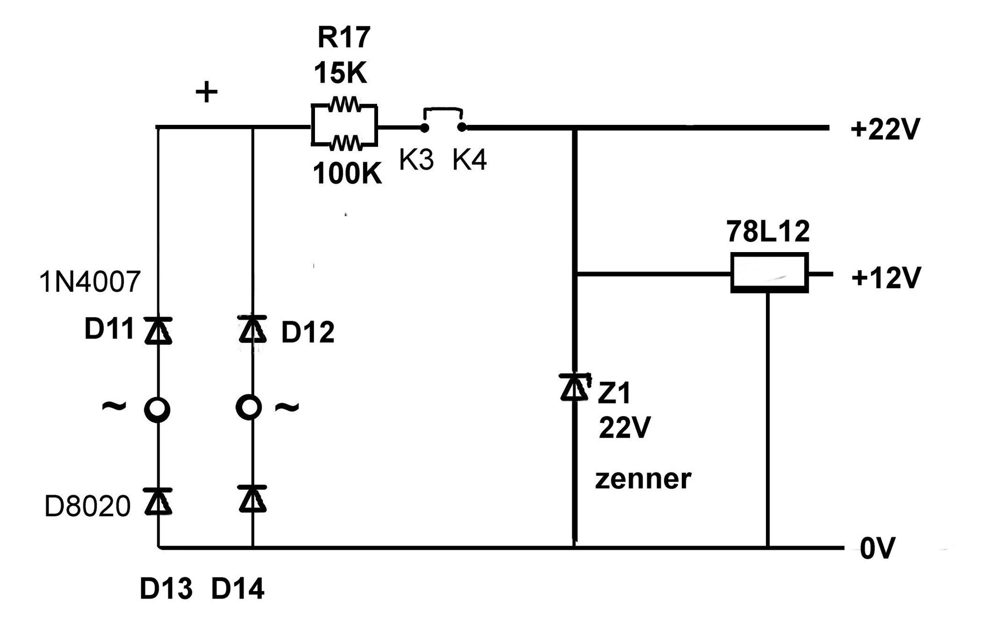

    looking at the circuit diagram I linked to
    this a simplified diagram of the low voltage supplies to the control circuit

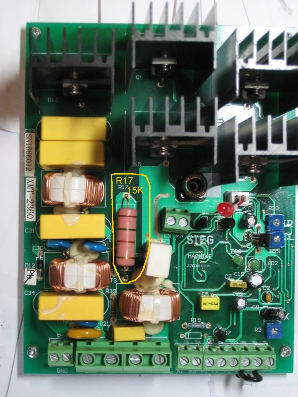

    R17 is the large resistor on the board
    its value is 15 K (15000 ohms)
    in parallel with a 100K resistor that gives you a total of 13K
    if you get more than 13K then R17 will need replacing
    has R17 changed colour ?
    the resistors drops the rectified mains down to 22V at terminal K4 is linked to K3
    with K3 & K4 open circuit I would of expected you to have 200V DC
    if terminal K4 was shorted to earth
    a number of semiconductors will need checking
    starting with Z1 the 22V zenner and the 78L12 regulator IC
