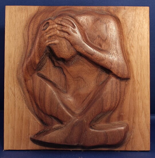

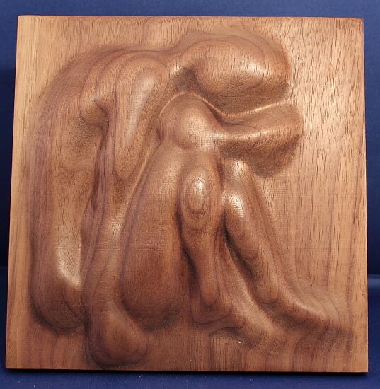

    I used Zbrush in the past and it works fantastic. You need to save as a height map or Alpha. I then used Aspire, which you can create GCODE from Alpha maps in the photo relief tool. Example below. Its really simple.
