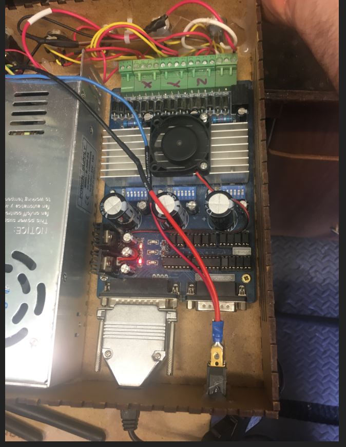

    I purchased a 2nd hand 300x400 cnc router that has the USB to parallel port conversion. See pic.
    The previous owner was using madh3. Saw it running and have no issues parting with my Pennines..
    So. I got it home, had a few health issues and then now finally after what seems like months I get it connected and downloaded the Mach3 software..
    However connected the machine and my PC (windows 10/64) identifies it's there but I can't find the driver so I can connect.
    It's identified in the device list as "CNC control via USB"
    Would appreciate any help that you guys can direct me too..

    When you say Mach3 and usb to cnc, do you mean you have a UC 100 ? This would replace the parallel port connection. If this is indeed the case, you will find what you need here :- http://cncdrive.com/UC100.html
    If not the UC 100, then you would need to explain in more detail.

    I really don't know what it is, it doesn't have any writing if details on it.. it's a plug that fits in to the printer port on the board and has a USB port on the other end to allow me to plug a USB lead in to it.

    Just clicked the link, it does look similar but it's all steel and has a micro USB plug on the input end..

    Picture of the adaptor and box.

    Sorry mate, I can't help you with that one A quick google search has turned up this page though :- https://sites.google.com/site/usbres...all-usb-driver
    Please don't take this as the correct driver for your controller, but it may help you a little. I'm sure one of the guys on here will be able to advise you better.

    Thanks for the reply, I had seen that in my searches.
    However it refers to putting my disk in to upload the driver.. the disk I don't have I'm afraid.. so was hoping someone on here has had a similar request..
