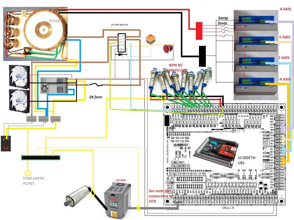

    I purchase the UC300ETH-UB1 combo for my home build cnc, to drive 4x4NM stepper motors with
    4x AM882H
    1x72Volts PSU 7Amps
    2x12 volt psu 330watt
    HY VFD with 2.2kw water cooled spindle
    NPN proximity switches.
    The wiring is a headache for me, and this is what I have design until now, can anyone check and tell if I am at the correct path?
    4x AM882H
    1x72Volts PSU 7Amps
    Not sure 7 amp is enough...
    72v could be a little high 68v could be right to grt margin for back emf
    Limits or home switch if limits don t connect it on you bob'

    I will check it,thanks for the reply!
  5. 1x72Volts PSU 7Amps
    don't connect limits on you bob but a relay cutting the enable and power of drivers
    Also you should use the am882 alarm.
    For vfd to bob use the rs485...
