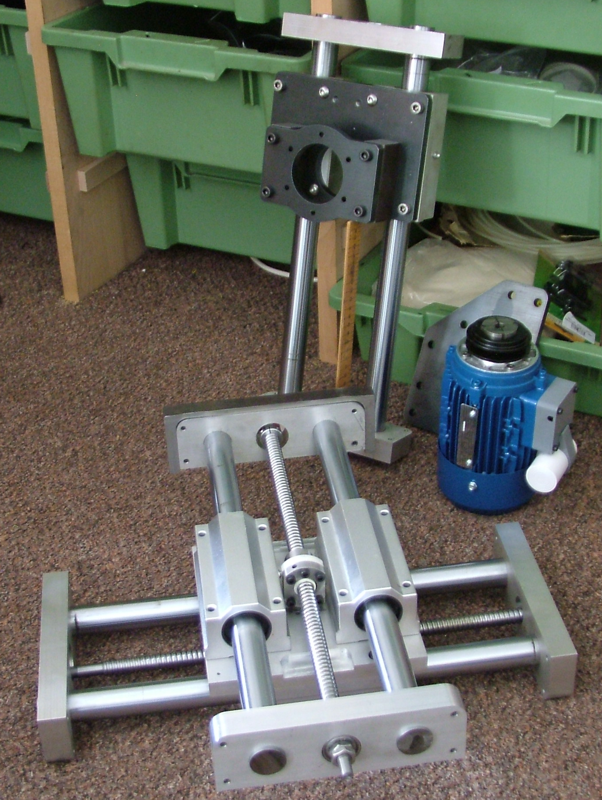

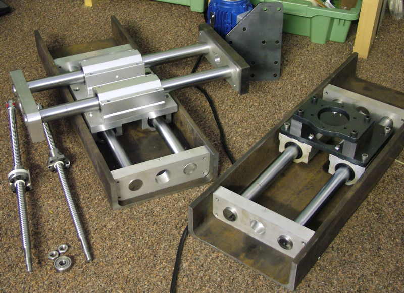

    I had this notion that 30mm round rail bolted to RSJ's might just be rigid enough. I looked at what was available and went for 230x75 parallel flange channel at 25 kg/meter. The rails are all 50cm long.

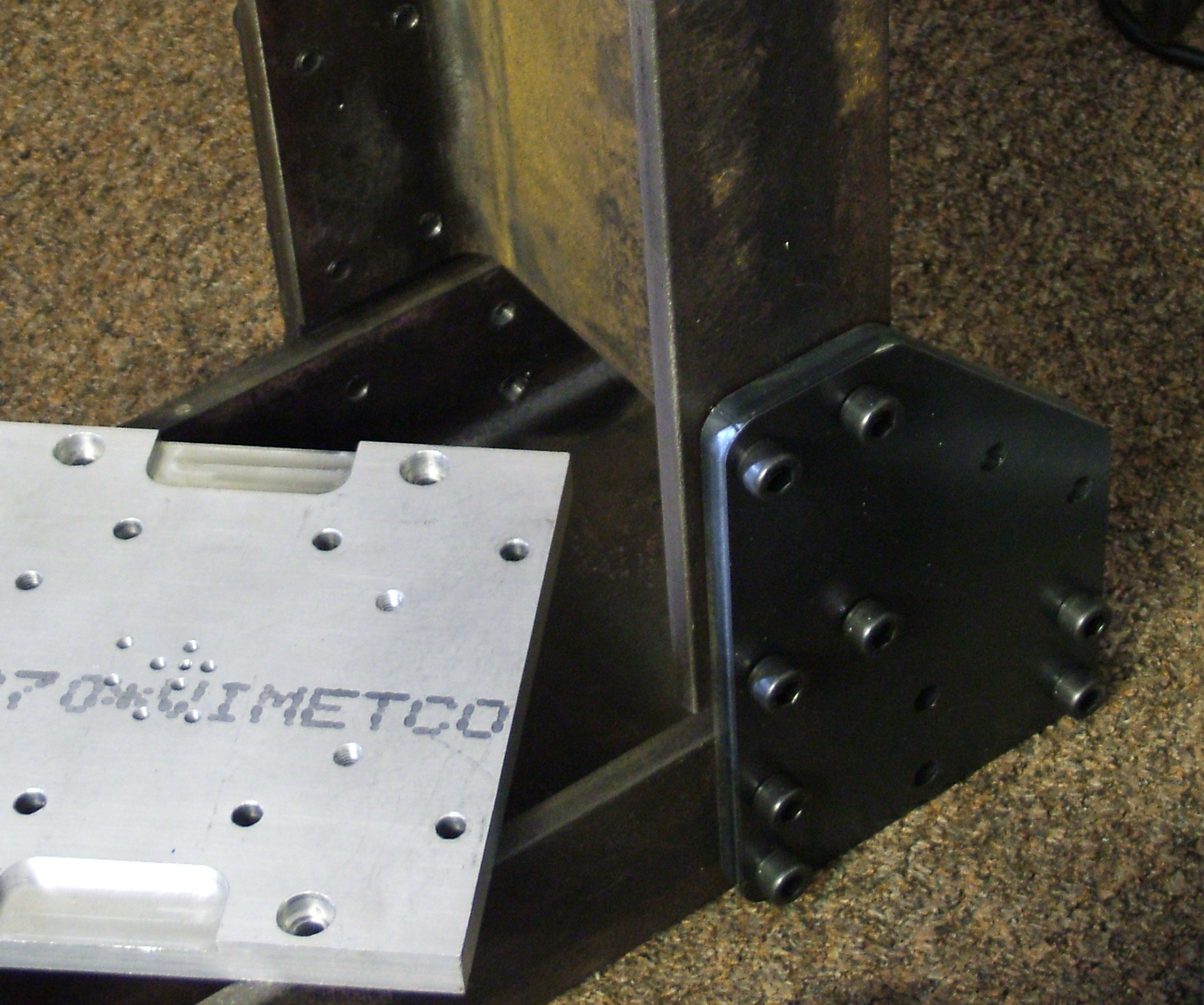

    I machined aluminium blocks to connect rail to RSJ. These fit inside the channel. There's a thin slice of channel draped over one of my blocks in the picture.
    The idea is that misalignment is irrelevant, it is twist and flex that must be overcome. Do we agree?

    On the stiffness then as you say that will matter as the work piece will be pushed away rather than being ground and the effect will be different depending on where the table is on the rails as they are stiffer at the ends of travel. So the workpiece would not be flat but would be dished in the middle. Any reason you did not go for supported rail or linear profile rail?
    Good question. I reasoned that profile rails and supported rails conform to whatever you bolt them to, but round rails have their own built in straightness. By bolting the X and Y blocks either side of the same plate, I think I have defined a flat XY plane and I can grind the table square to that.
    The tricky bit is cutting the inside of the RSJ channel flat and square where the rails connect. There is no sensible reference surface anywhere, tolerance seems to be about 1.5mm. I am hoping for consistency.
    I got a wonderful gadget from RDG Tools, a sort of spring loaded centre. This held the m30 reamer amazingly square and true when finishing the end supports. I can slide all 6 onto the same pair of rails and they happily slide about and butt up against each other. I was not expecting that, good tool.

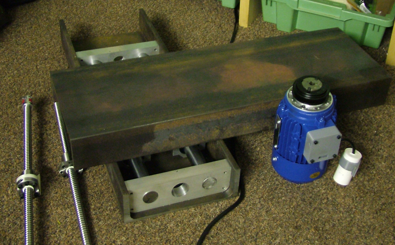

    Tried adding some RSJ's, not cut to length yet.

    I tried cleaning them with a knotted wire brush on my angle grinder and they laughed at me.
    I might need to take them over to Newhaven and get them shot blasted, getting fed up with washing my hands every 5 minutes.
