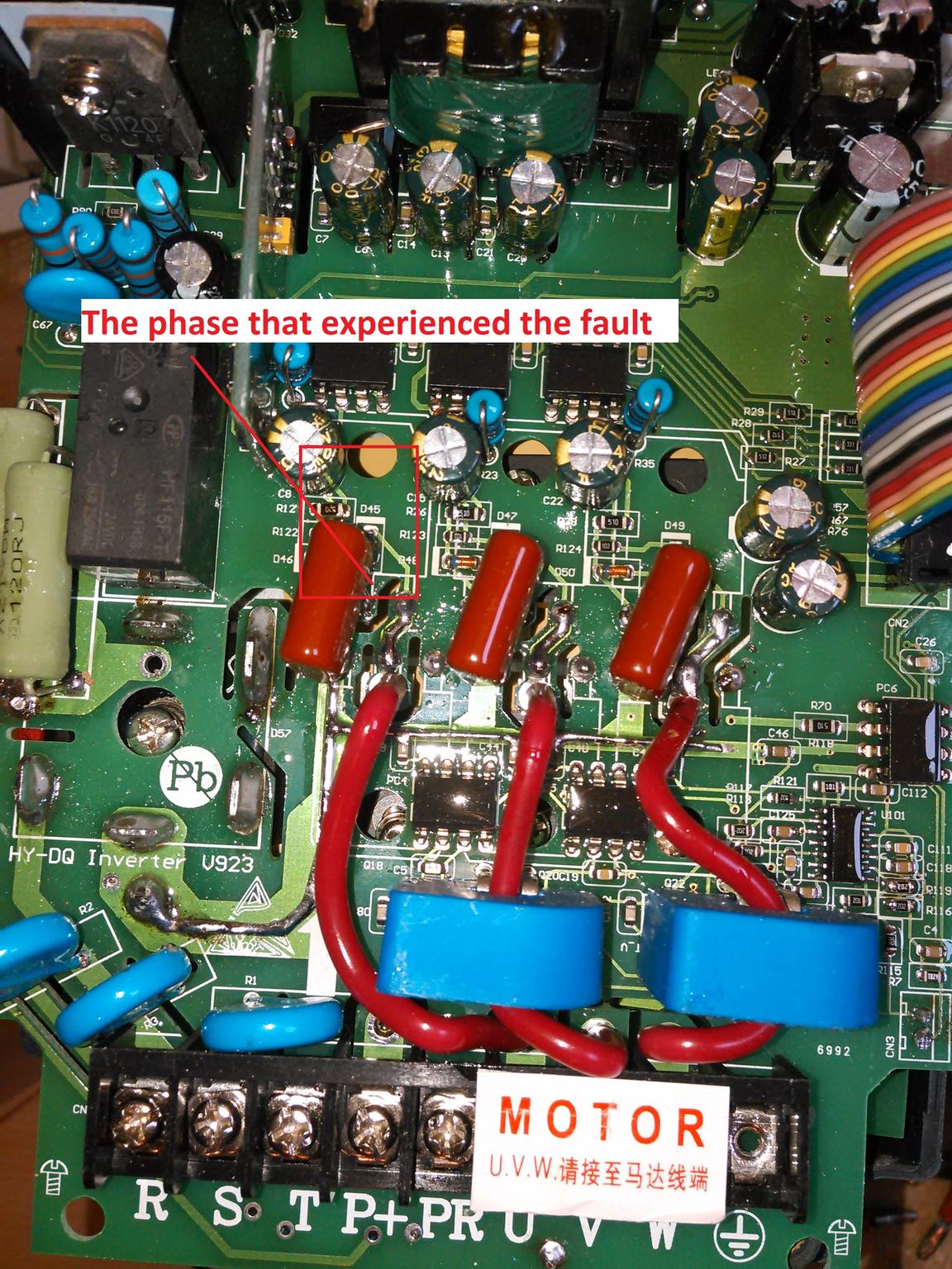

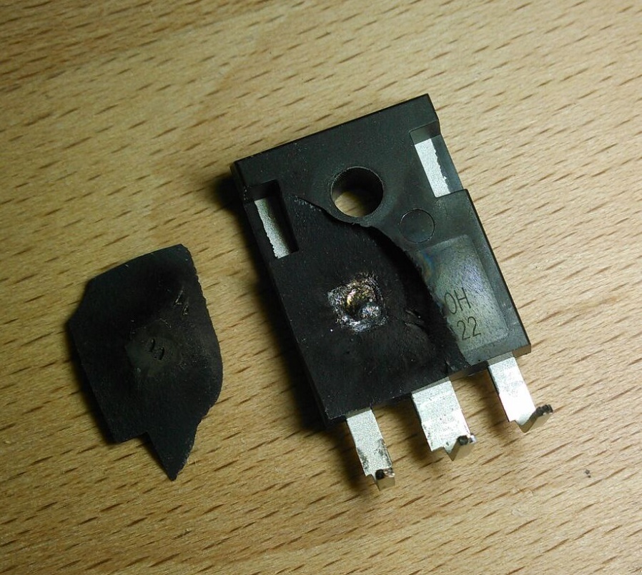

    I really doubt that I can return it as the seller doesn't reply my messages. But I just checked the VFD and found a transistor exploded.

    This is the model number: kdg15n120h ( documentation)
    What do you think ? Is there a chance to save the VFD by replacing this transistor?
    Thanks for your help.
    You could try replacing the bit, they are cheap enough ($25 for 10 from China), but don't be surprised if the damage goes back a little deeper than that one component. For the cost of the bits, it is worth a punt. Check your circuit board tracks haven't been fried as well !

    Of course you've blown it up at exactly the wrong time - about the start of the Chinese new year and the black-hole of all internet orders. I can't see a UK supplier but it might be worth looking up an equivalent.
    He's in Toblerone land so UK supplier won't do him much good anyway.! . . . . I'd have small wager this will come back to life with that part replaced and I'm sure there be supplier in Swizyland.!! . . . . If pays my Air fare and Lift pass I'll take him my spare and go boarding while at it. .
    Post some part numbers for similar ones you can get locally and I will comment on if they are likely to be suitable. You should use the multi-meter on diode and resistance test to poke around for damaged parts. Does the VFD display an error with the IGBT now removed?

    I just begin to check the circuit. By now, tracks are surprisingly good, but there is some strange connections... I will continue to test the circuit.
    I checked the part in china but you're right it will be difficult to replace it with the same model.
    It would be awesome if you could advice me :)
    A good shop in Switzerland is Distrelec. I've searched for some replacement parts (http://www.distrelec.ch/search?q=iGB...=4&pageSize=10) and I think about this one maybe: http://www.distrelec.ch/fr/igbt-to-2...=50&simi=97.47
    Should I replace all IGBT or only the broken one ?
