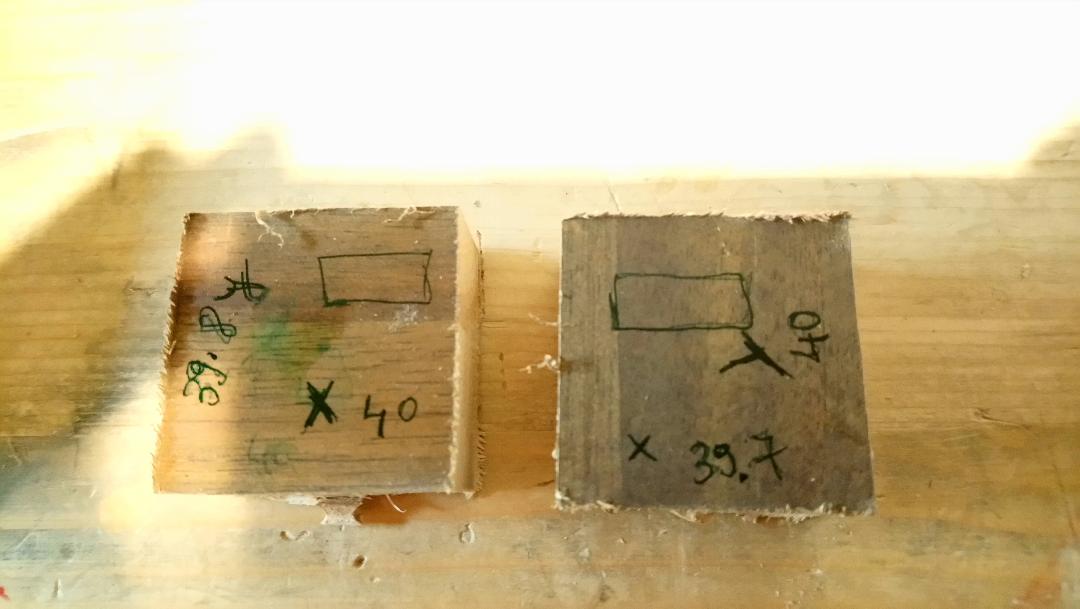

    Hi all!
    I have a "small" problem with my DIY CNC. For some reason, I'm not able to get the right dimensions when I cut a 40x40 mm square in wood. I get 40 mm when I cut along the wood fiber and 39.7 when perpendicular to the wood fiber.I have tried to reduce the cut deep from 2mm to 0.5 but the result is almoust the same.If I cut in mdf ,I will get 39.8 mm on one axis and 39.9 on the other(so here the differences between the axis is smaller).
    The backslash on all axis is less than 0.03
    The deflection is around max 0.04-0.05mm when 15 kg applied on each axis
    I'm running Uccnc with ETH400 and on each axis, I have a DM856.
    Also 2.2 China spindle+VDF "NowForever"(China)
    The cause of my problem can be the high noise made by the VDF. Probably I'm losing steps (when high cutting force), but I'm not sure about it.
    Any idea?

    It's more likely to be spindle deflection.
    You say you've measured deflection on each axis, but what about on the spindle nose/cutter with the spindle at cutting depth?
    I already checked the spindle and has no runout(0.01-0.02) and also no deflection. The cutter is a 4mm x22mm (not the best quality) and for sure will deflect. Tomorrow I will check this too.
    However, the cut was done first at 2000mm/min and second at 1000mm/mm and decreasing the feed rate /deep of the cut improve the result, but not dramatically(from 39.7 to 39.8).In case of cutter deflection changing the speed/deep should improve the result.

    Yes, it will return to the position, so it's not the noise.
    It was from the cutter. When I changed to a new one(3.175x9mm) the situation improved to 40mmx39.95mm.Now I have to find a 22 mm cuter that will not deflect so much because the 9mm that works it's too short for what I want to cut
    Bad news!!... Yesterday I made a mistake. The cutter was not 3.175 but 3mm. After changing in the Estlcam the cutter diameter to 3mm (the real one) I get again wrong dimension.This cutter it's 9mm long so the deflection is minimum at 1000mm/min.
    I really don't understand what is happening.

    Today I discovered that my VDF was set on CCW rotation and the cutter used for MDF was a right hand one. After changing to CW on MDF I get the right dimension.
    However on the wood plate on a 40x40 square it's all perfect, but when I switched to a bigger 80x80 square I get again wrong dimensions 80x79.8.
    Normally it should work also on a bigger square but at least half of the issue was solved.
