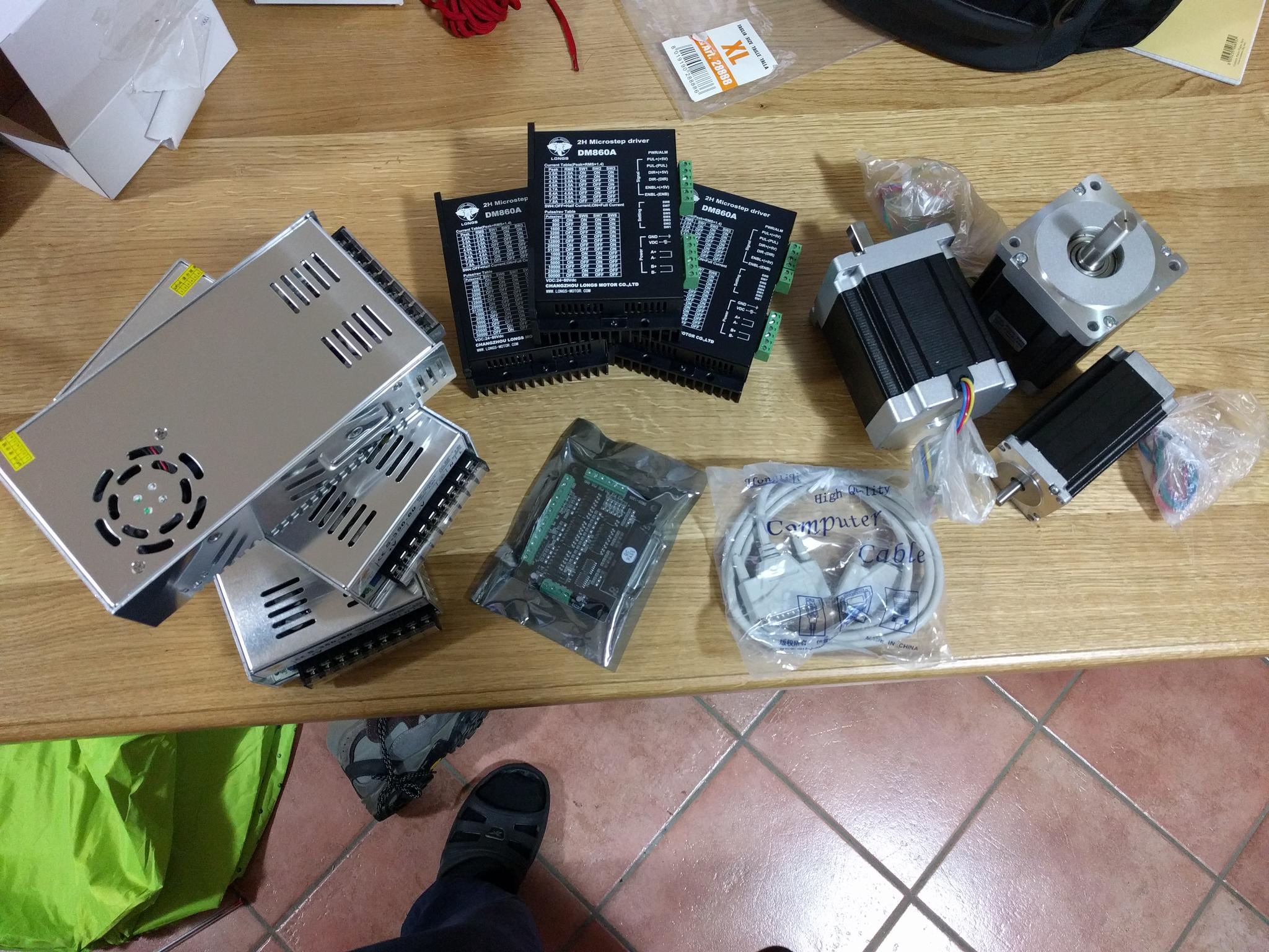

    The engines are:
    - 2 Nema 34 1232oz.in 5.6A 4 leads (X axis & Y axis)
    - 1 Nema 23 425oz.in 3.0A (Z axis)
    The drivers are DM860A, one per engine.
    - 3 Power supplies 350Watts (60VDC / 5.83A)
    - 1 Breakout Board DB25-1205
    Mach3 management program.

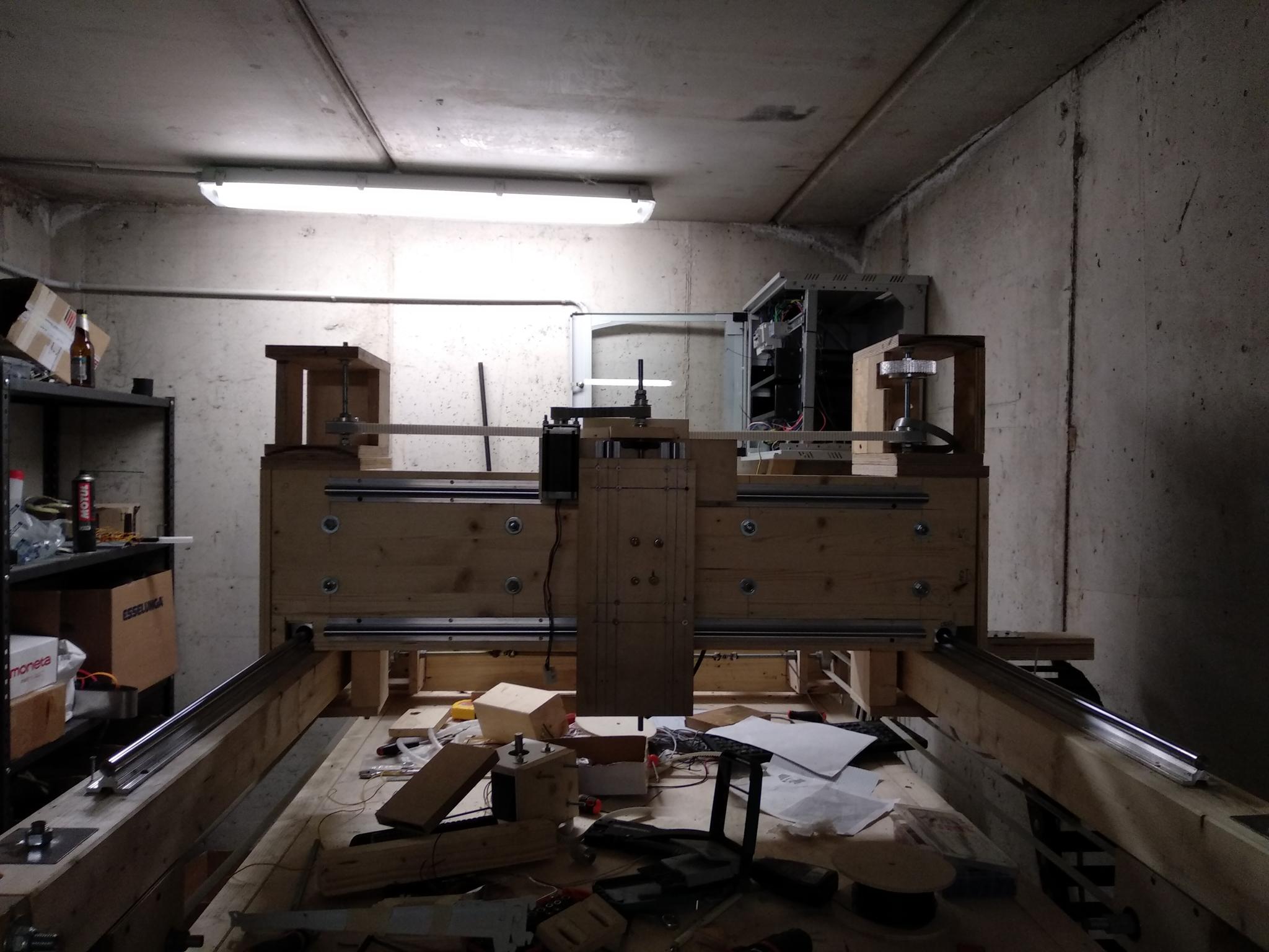

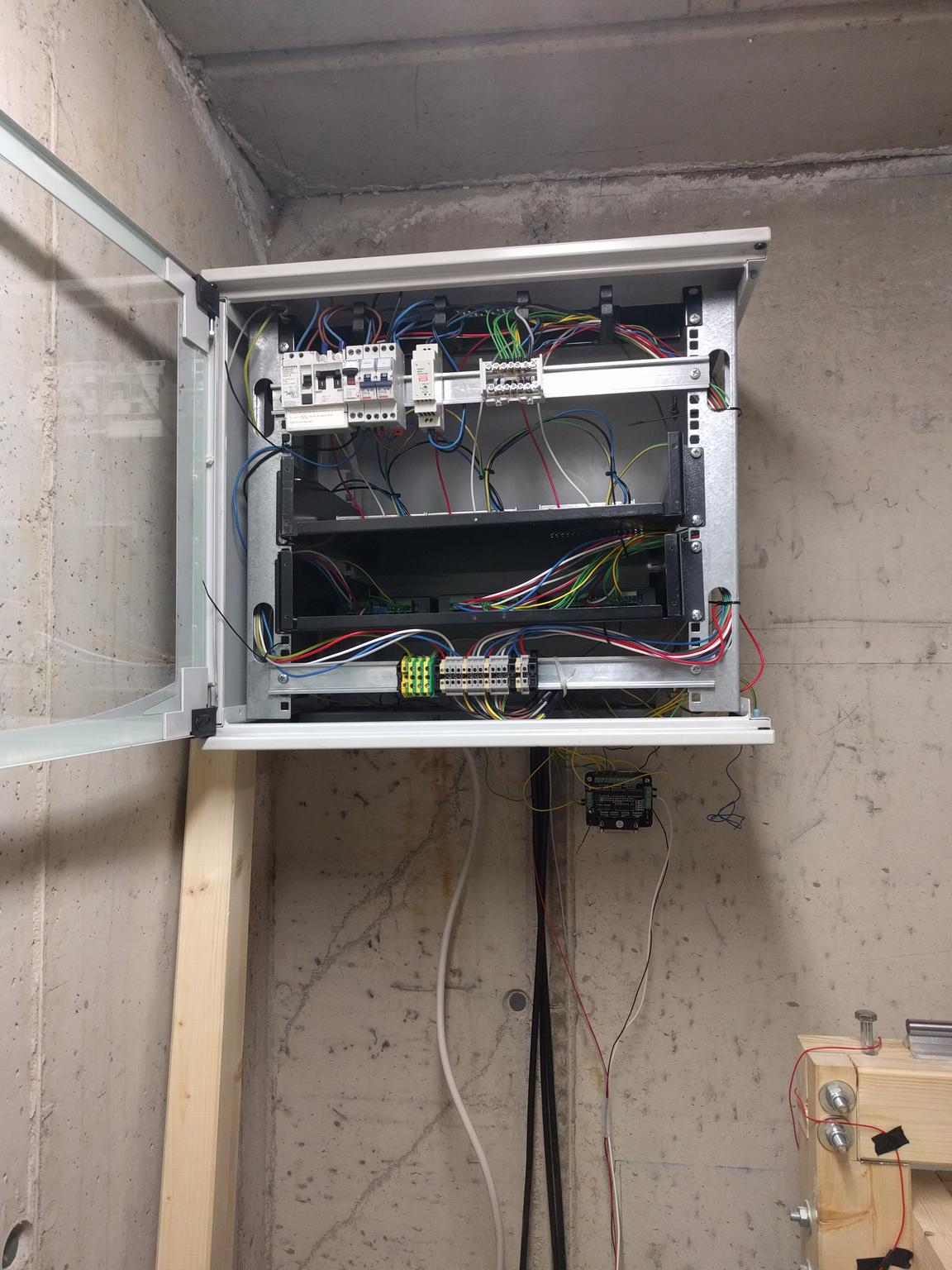

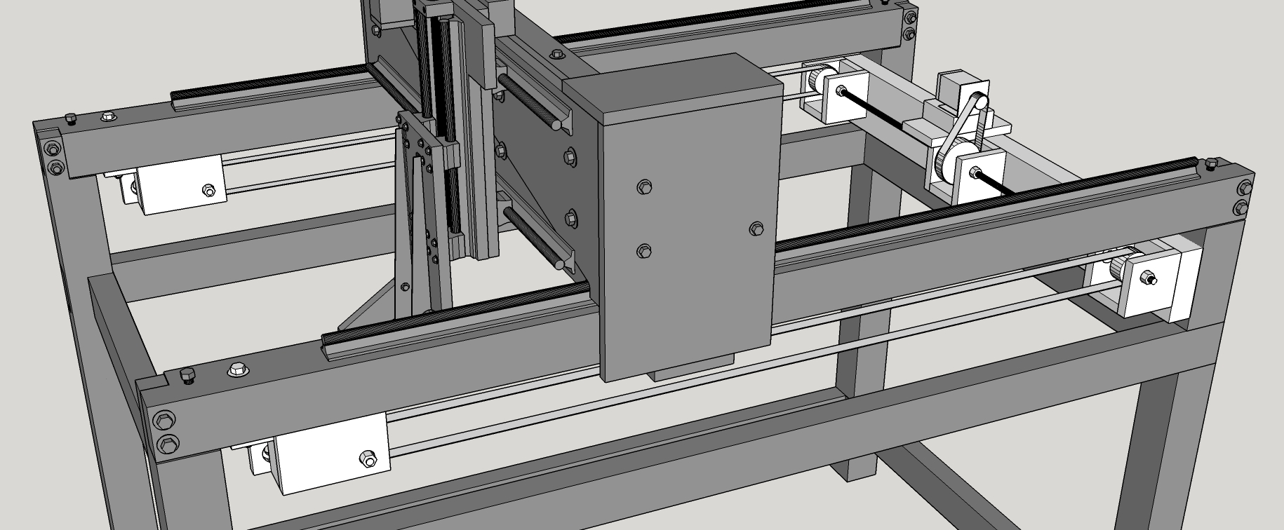

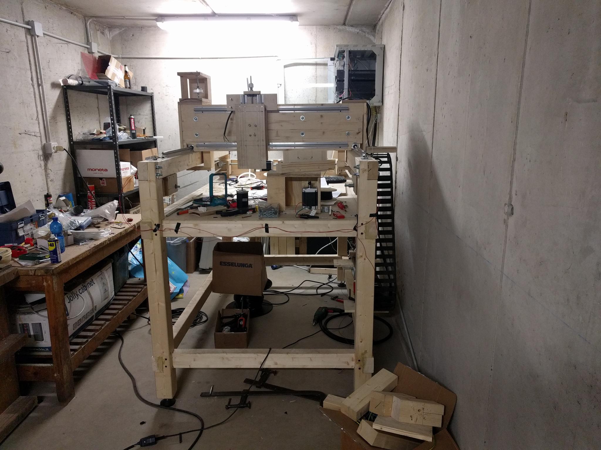

    For a better understanding I am attaching some photos of the work (now it is completely assembled and wired but I have no more recent photos)

    I thank all those who can help me in advance.

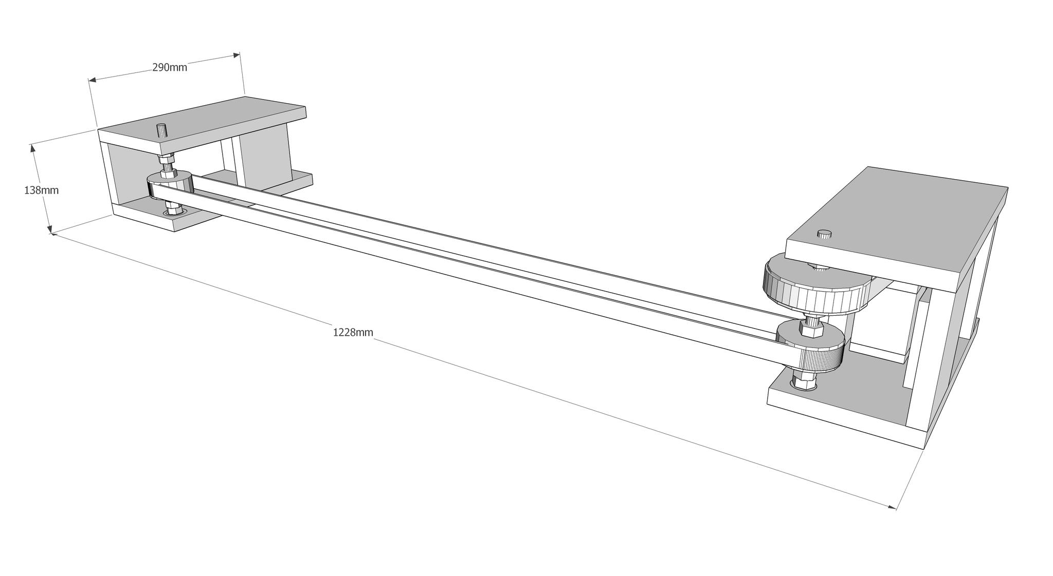

    My transmission of the X axis is made with:
    - M12 screw
    - a pulley 20 teeth 5 pitch on the motor axis (I have to check if it is 20 or 15 teeth)
    - a 60-tooth pitch 5 tooth pulley on the M12 screw
    - two 40-tooth pitch 5 pulleys connected to the ends of the screw
    - two 40-tooth pulleys step 5 for "neutral"
    I attach photos:
