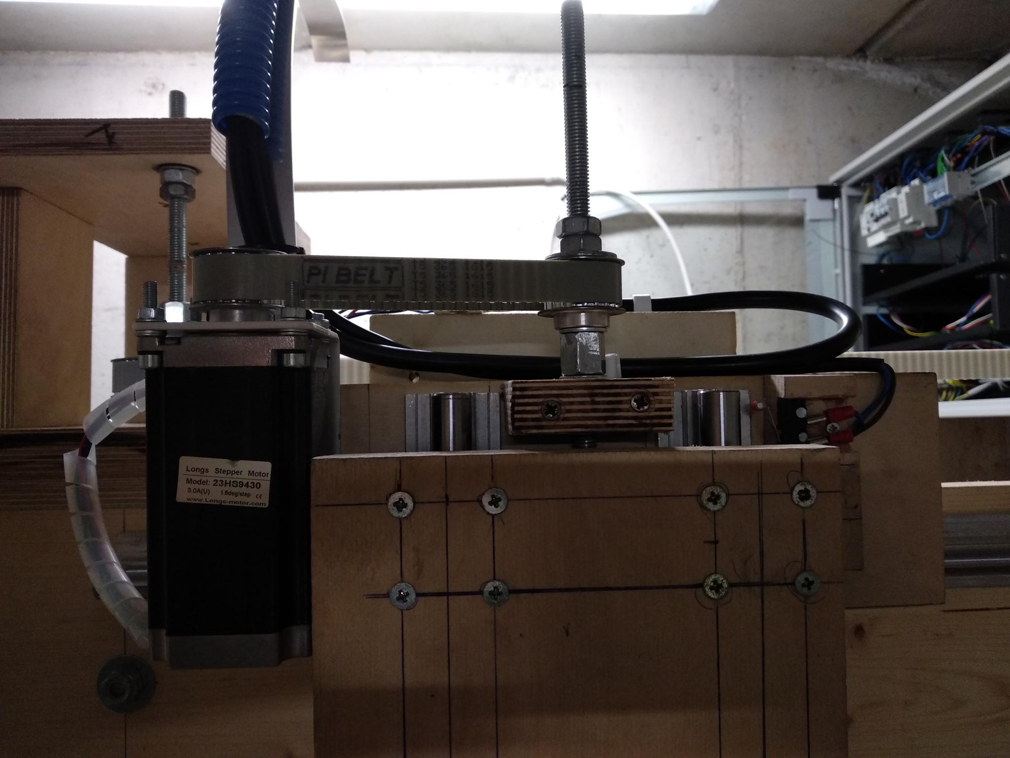

For the Z axis I have:
- a pulley 15 teeth step 5 on the drive axle
- a pulley 20 teeth 5 pitch on M10 screw
I attach photos:
