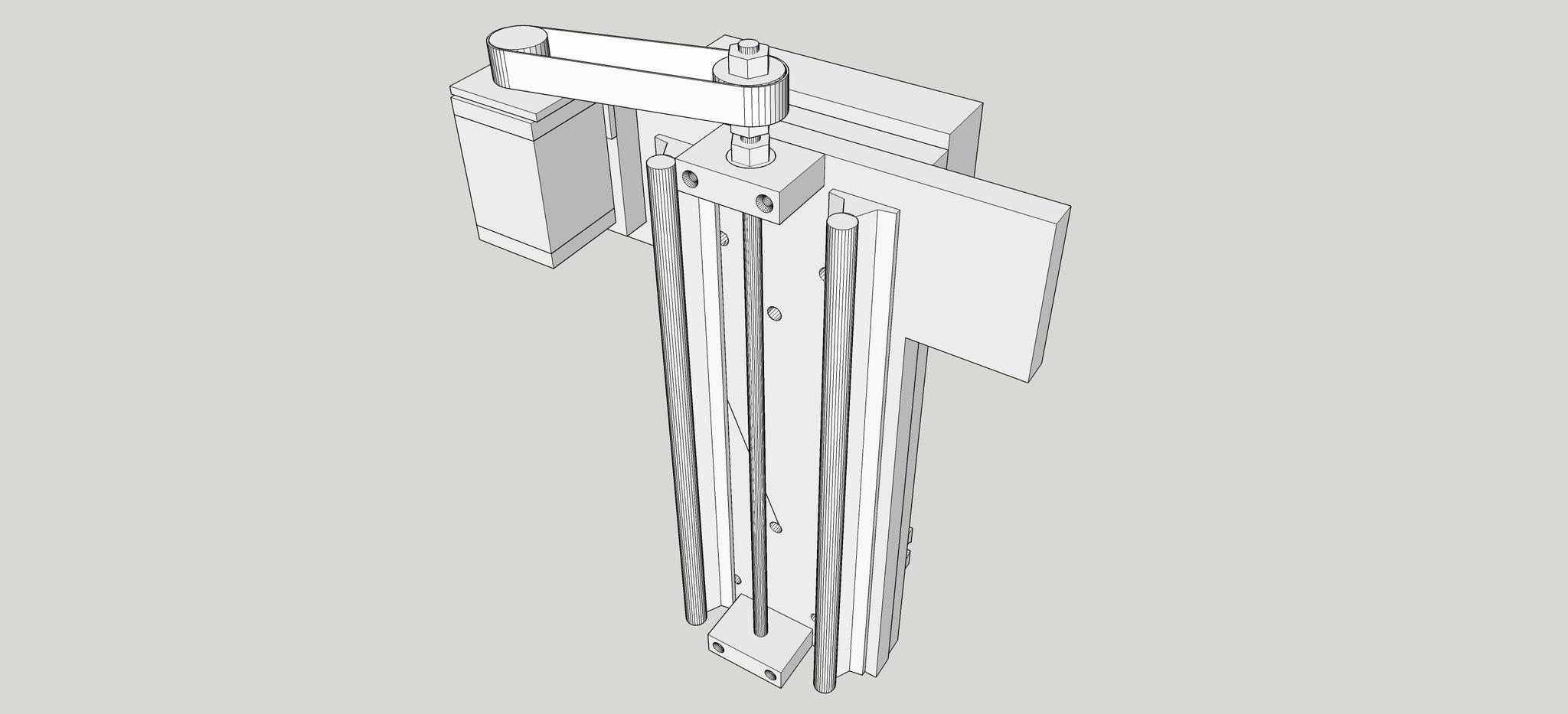

    For the Z axis I have:
    - a pulley 15 teeth step 5 on the drive axle
    - a pulley 20 teeth 5 pitch on M10 screw
    I attach photos:

    OK, so X and Y are belt drive and are a different problem.
    On your Z axis you say M10 screw. Do you mean a piece of threaded rod with the normal coarse pitch of 1.5mm?
    If this is so then on your Z axis 200 steps -> 15 (driving pulley)/20 (driven pulley)x 1.5 mm of movement = 1.125mm, so steps per mm is 200 / 1.125 = 225 (note this is steps per millimetre). If you then use microstepping, you will have to multiply that by the factor you set in the driver DIP switches. (other forum members - could you check this as I am tired today, I have done some work and I am not used to it )
    I will get to the X and Y later.

    Hello,
    yes, it is exactly a piece of M10 threaded bar.
    So for the Z axis I was able to calculate it like this:
    driving-pulley / driven pulley x 1.5mm (threaded bar) the result is divided by 200 (physical steps)
    and in this case it would be just like you wrote:
    15/20 * 1.5 = 1,125mm 1,125 * 200) 225.
    Assuming to set the driver through the dipswitches to 1/4 (400) I have to make 225 * 4 = 900.
    Or if set to 1/8 (800) 225 * 8 = 1800
    This value is what I have to set in the motor tuning section of mach3 for the right Z axis?
    Is this calculation valid even if the pulley on the threaded rod has not been tapped but is held in place by nut-locknut?
