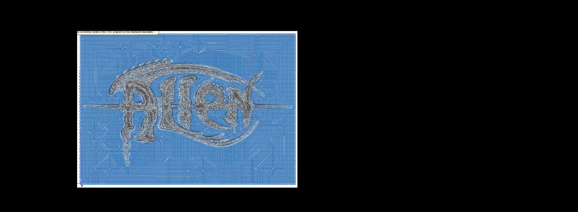

    Sceenshot of mystery pimples in toolpath

    The mystery pimples are single white pixels, which are difficult to see. I have blacked off the major stars with 'Paint' but the little ones are everywhere.
    If you want to improve the doctored version and send it to me, then it only takes a couple of minutes to convert it.
