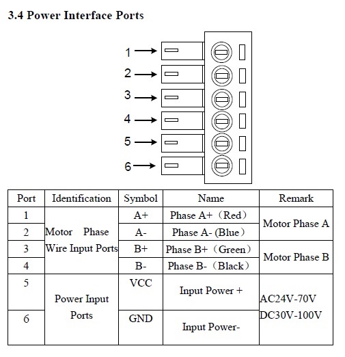

    My drivers (JMC 2HSS86H) can be run with 24-70V DC or 30-100V AC.
    Are you sure you have this the correct way round
    This is from the manual but im still leaning towards going DC.
    After all, its quite fun building the PSU...

    Quote Originally Posted by JW1977 View Post
    So yes you had it the wrong way round. I would up the toroidal transformer to 25- 0 - 25 which would give you about 70v dc when rectified . good vid here. https://www.youtube.com/watch?v=4OoQ...zD30sZjtp_VyqY
