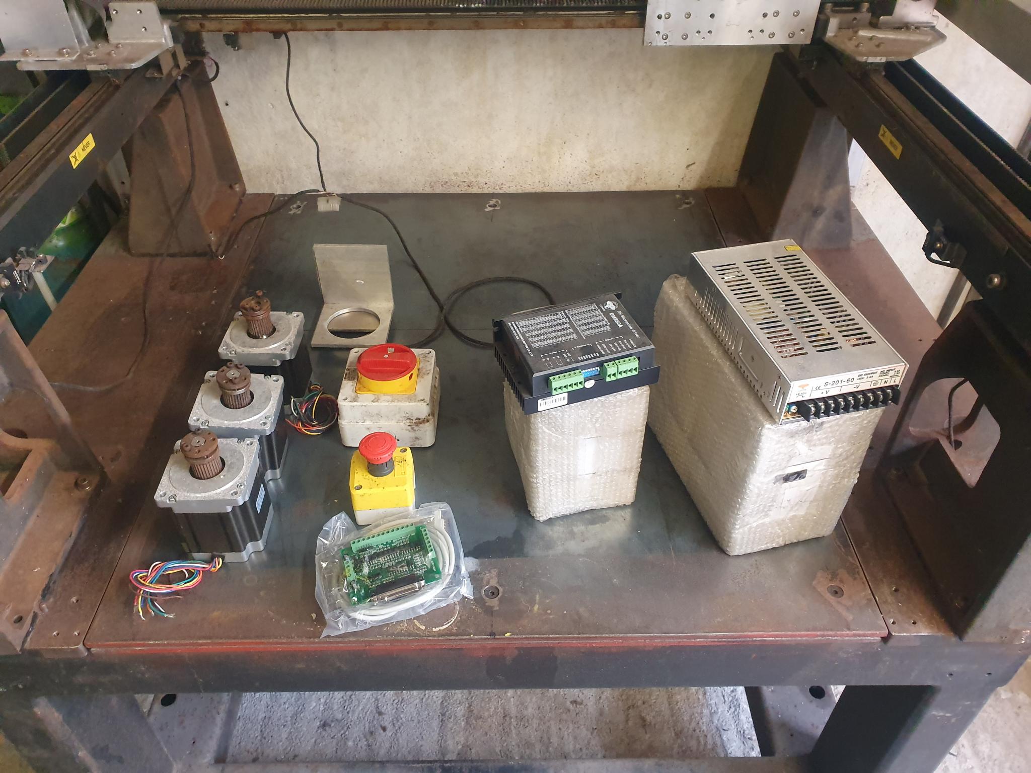

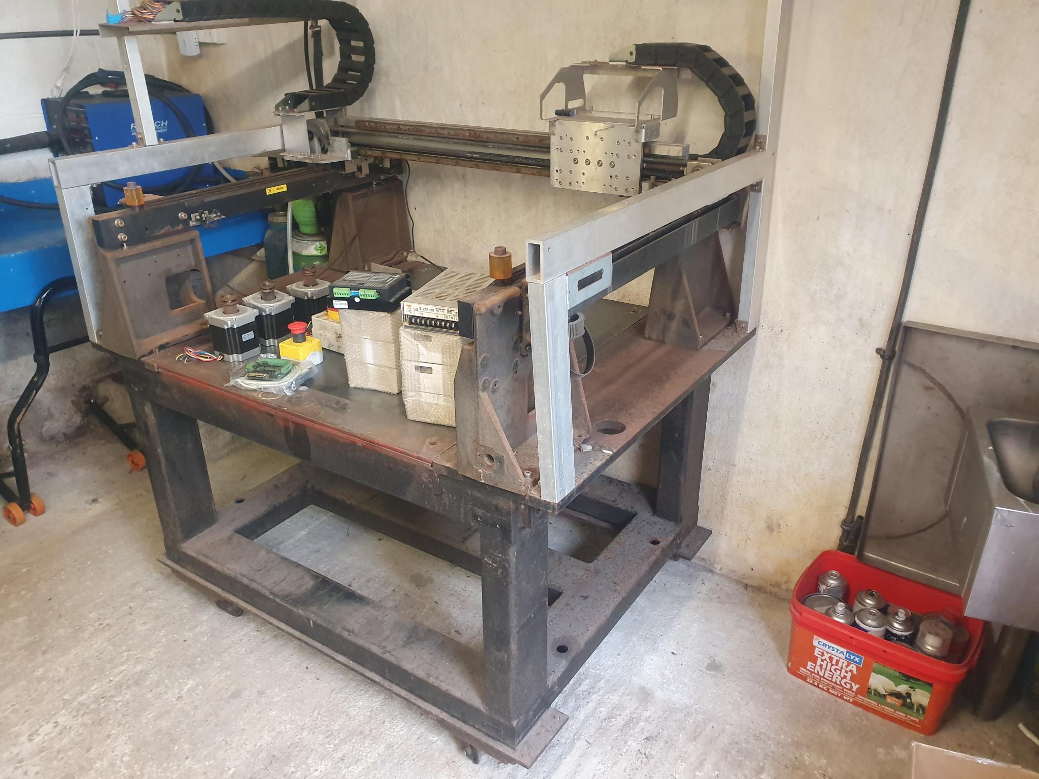

    I have a Machine at home am working on photo below
ID:	27610   Click image for larger version.
