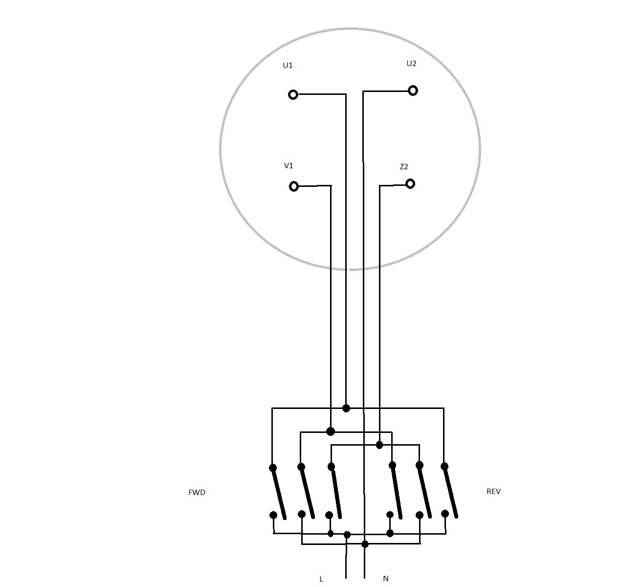

    So this is what I think I need to reverse the single phase with the two contactors I have in the machine:Click image for larger version.

    The schematic - yup, though I'd be interested in the 1c1/1c2 arrangement - these are contactors?, what actuates these? a mechanical forward/stop/reverse switch? in which case this can be re-used - which is what I think you're after?
    The other thing is to look to see if you can only energise the start coil whilst the run coil is energised - again, can be done with the 1c1/1c2 arrangement, depending on it's behaviour.
    My bad - 1C1/1C2 are the relays shown at the bottom of the schematic?
    Then use two pairs of the 1c1/1c2 contacts to provide the change-over for the start coil, and the remaining contact for both 1c1 and 1c2 wired in parallel to provide the live supply to the motor run coil.
  7. #6
    Yes, 1c1 and 1c2 are the fwd/rev contactors operated by microswitches which are in turn operated by the motor control lever on the carriage. See bottom of schematic. Obviously they are never both closed!
    You're right, I can use the third pair of contacts to switch the run coil on/off, which I haven't shown in my sketch.
    Cheers!

    Updated.
Name:	single phase wiring3.jpg
