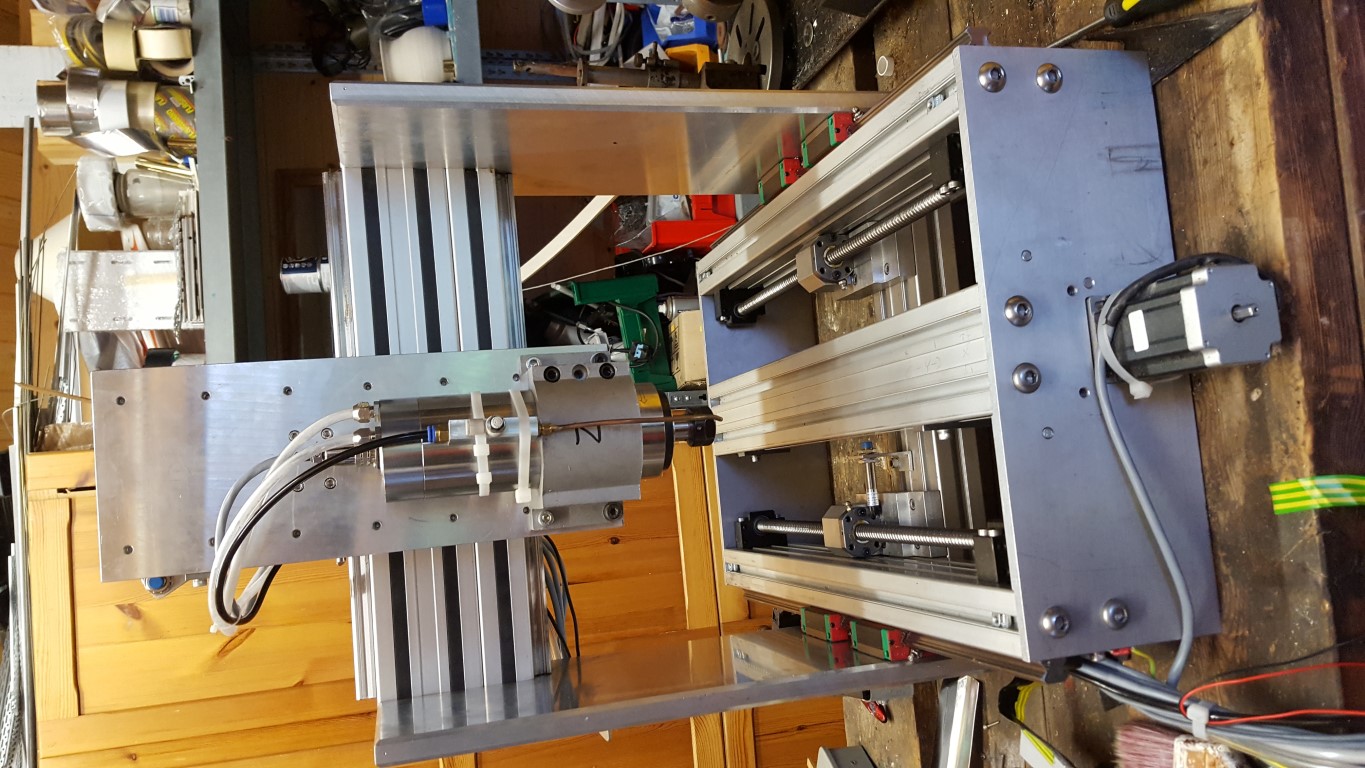

    Just bought a used gantry router. It's a custome made machine, but appears very well designed and is very chunky. It's basically a 3040 on steriods. (i'll stick some pics up later...)
    Now it's in situ, what checks should I do, no make sure its all square and hasn't suffered any issues from transit?

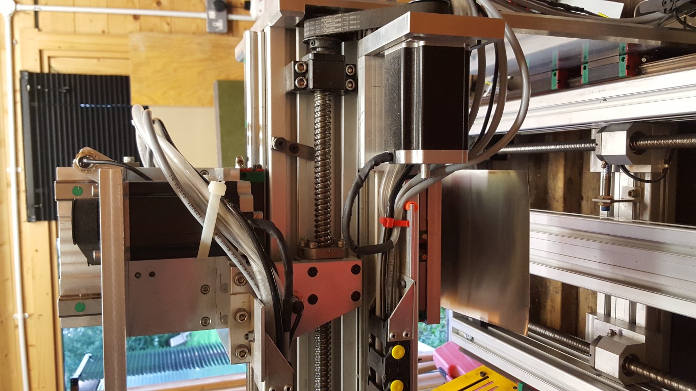

    Some pics of the beasty.

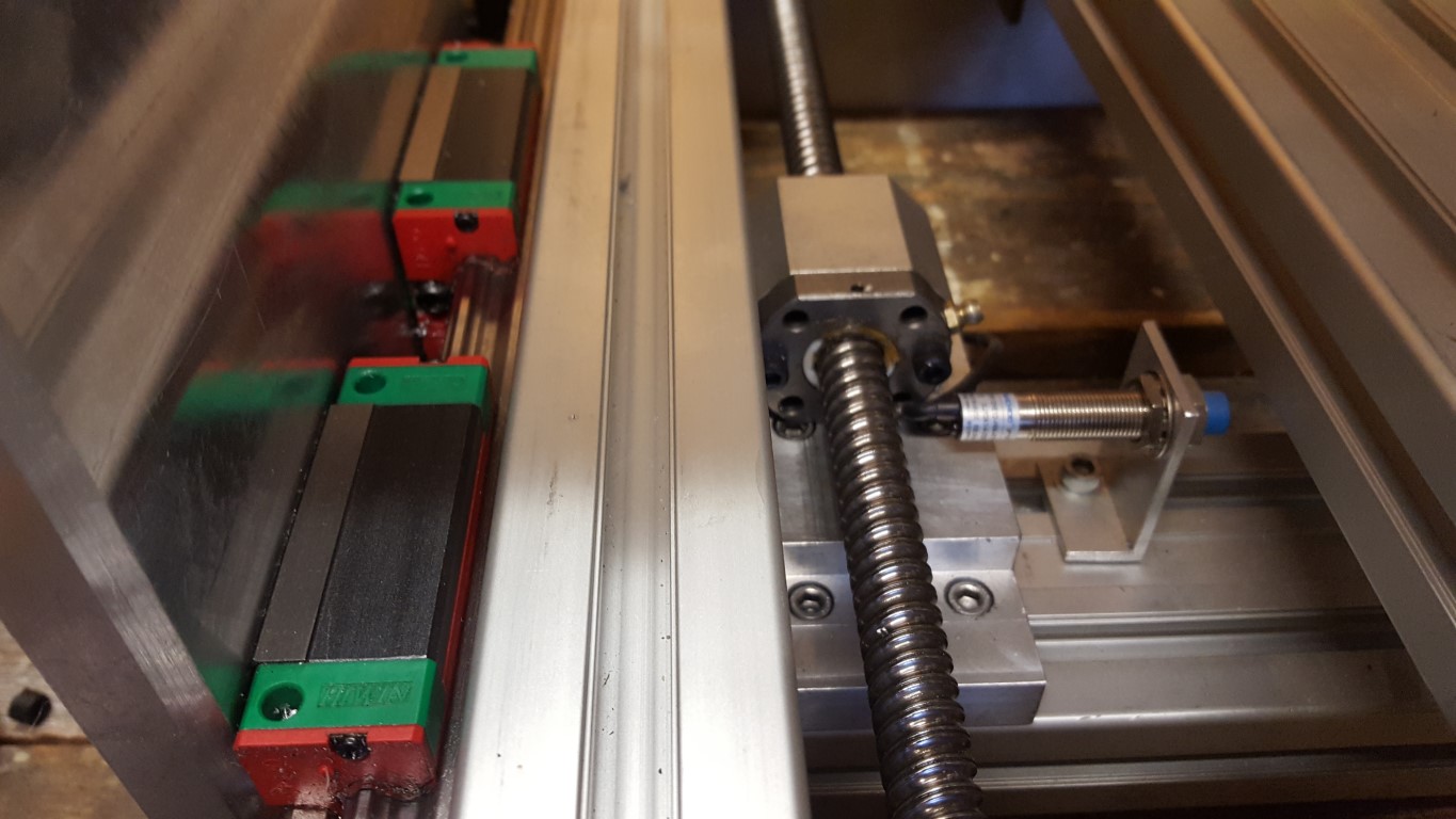

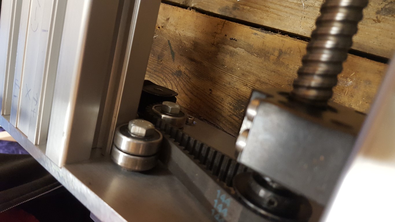

    Hiwin rails and slides all round. 16mm ball screws.
    Z axis has moving rails, which is good.
    It's made partly from extrusions and partly from plate.
    Gantry uprights are quite tall and might be a bit floppy but they are 20mm thick.
    Everything feels nice and tight where it needs to be.
    Bed is not shown, it's a slab of 15mm cast iron with an ali plate bolted onto that, which has been drilled and tapped in a grid.
    Spindle feels smooth and vibration free.
    Appears to be set up for spray mist. There's a line running to a valve mounted (or rather strapped on) on the front of the spindle which would take a liquid feed I assume. There's only an air line there at the moment.

    Came with laptop and mach3 2.0, collets and a few endmills too.
    VFD is a Schnider ATV12 and stepper controllers are CWD556's. The motion controller is a UC100.

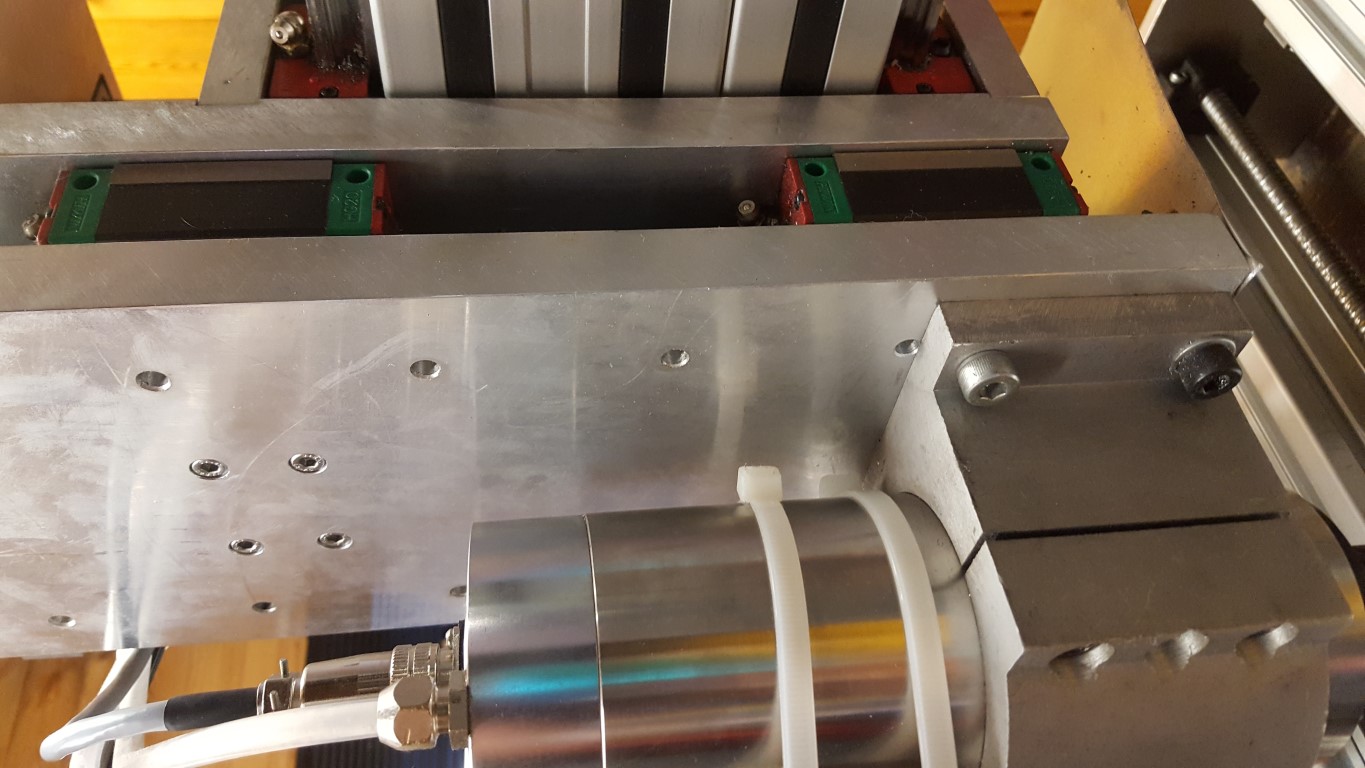

    I've been checking out the machine some more. Mainly tramming today.
    I found that it was out a little.
    Adjusting the spindle mount to get it perpendicluar to x axis (left/right) is pretty easy, but is there a prefered method to adjust the other direction?
    My tramming arm is 100mm long, so over 200mm I am seeing 0.2mm 'nod' forwards. I was thinking I just need some very thin shim stock under the bottom bolts of the spindle mount?
