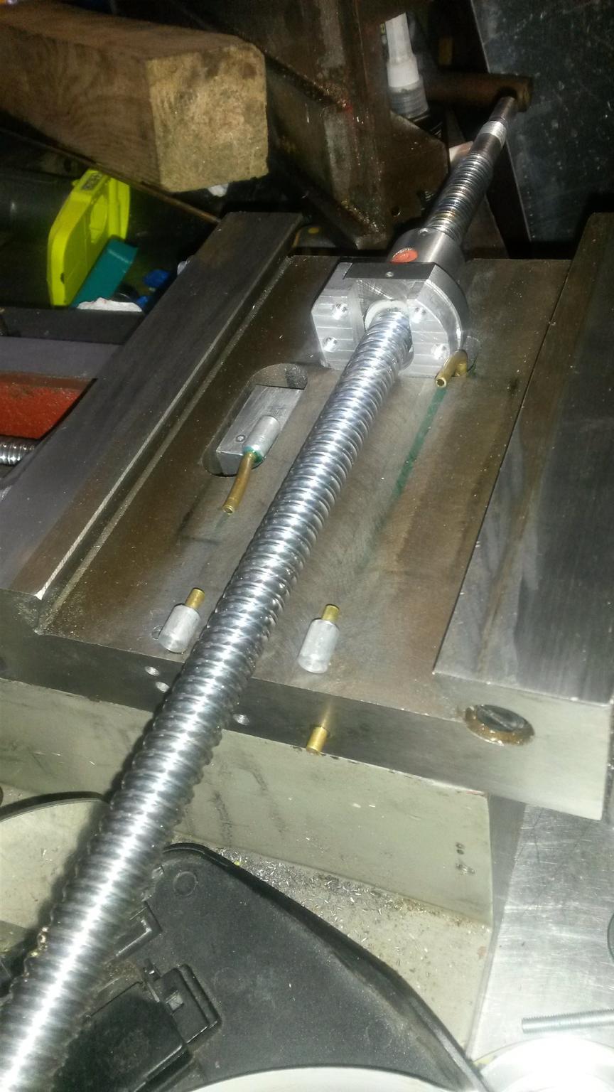

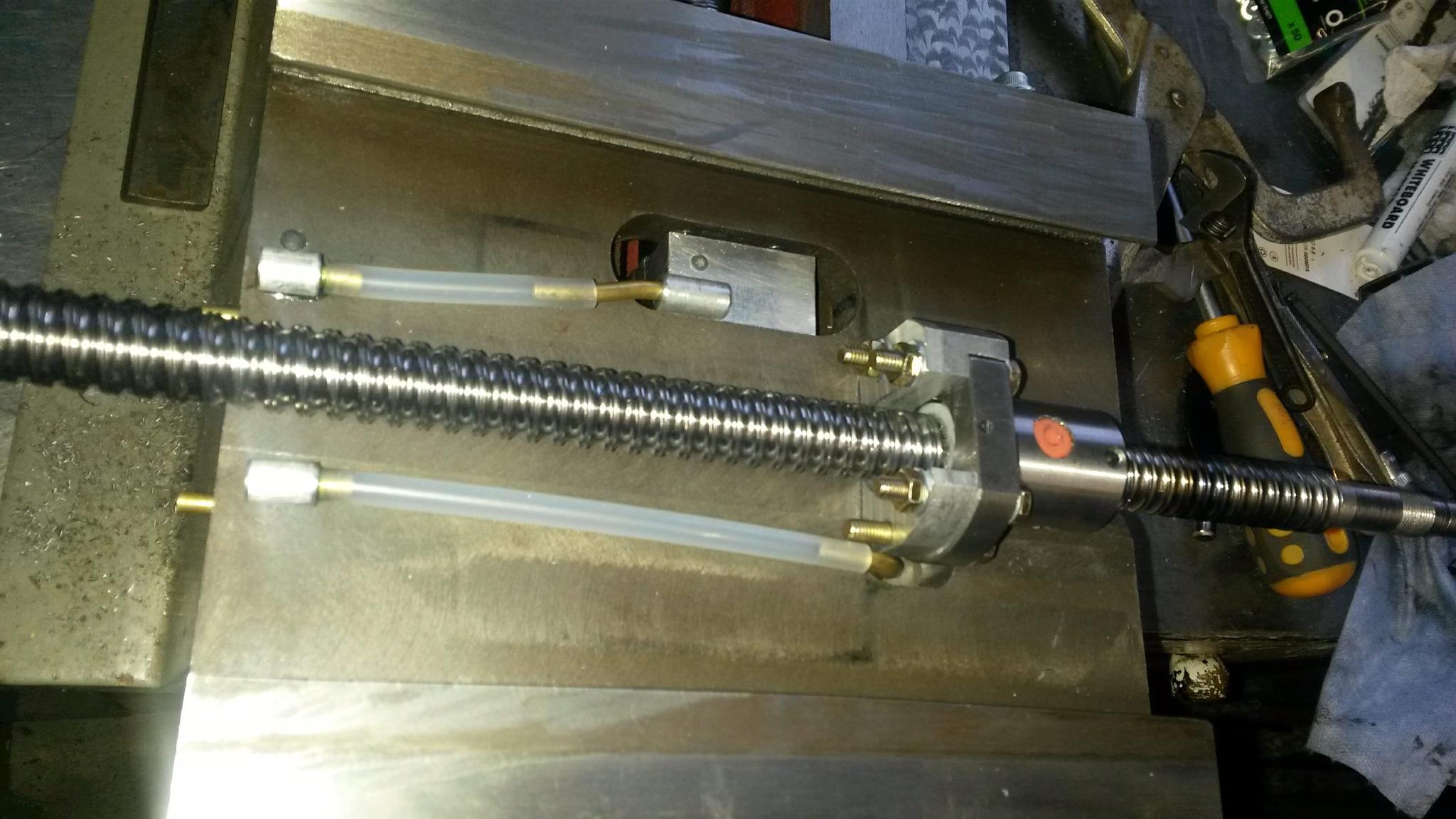

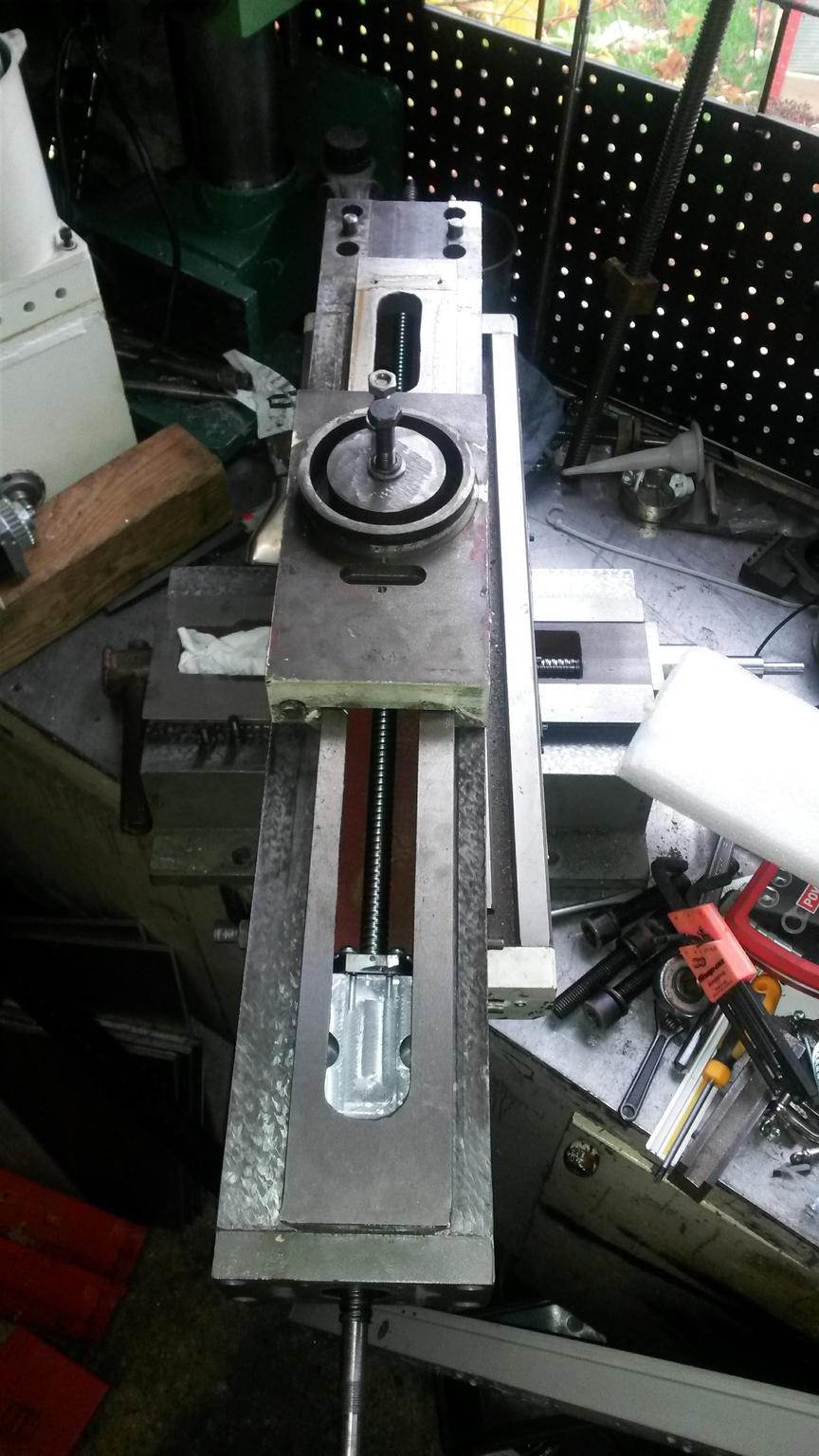

    X & Y Ball Screws, Ball Screw mountings, End Bearings and lubrication for X & Y Ball Nuts completed -

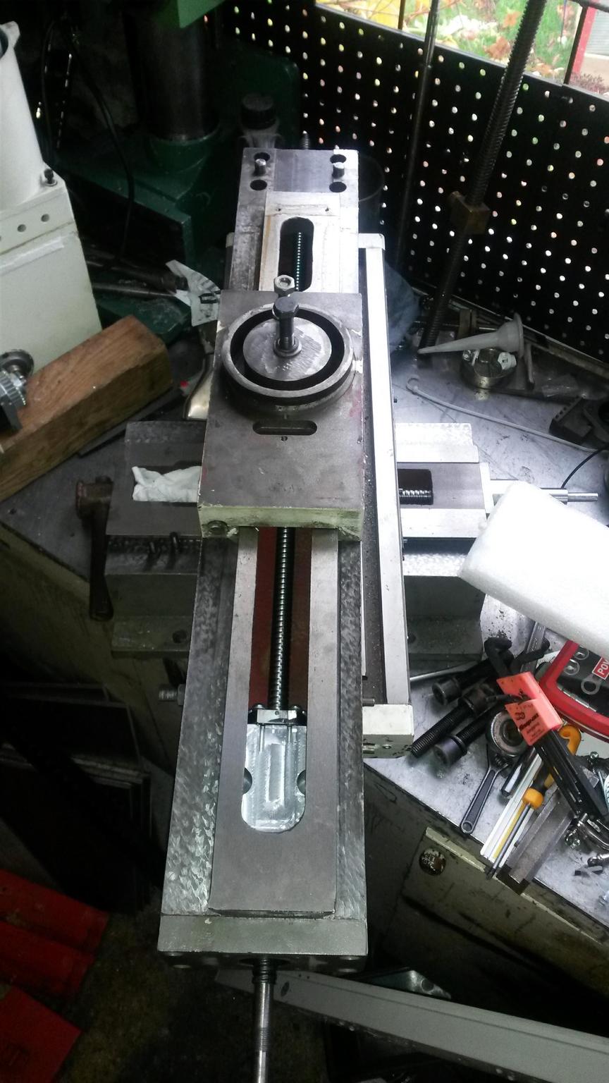

    Y-Axis assembled, assembling X-Axis, oil system in, nearly ready to fit the table.

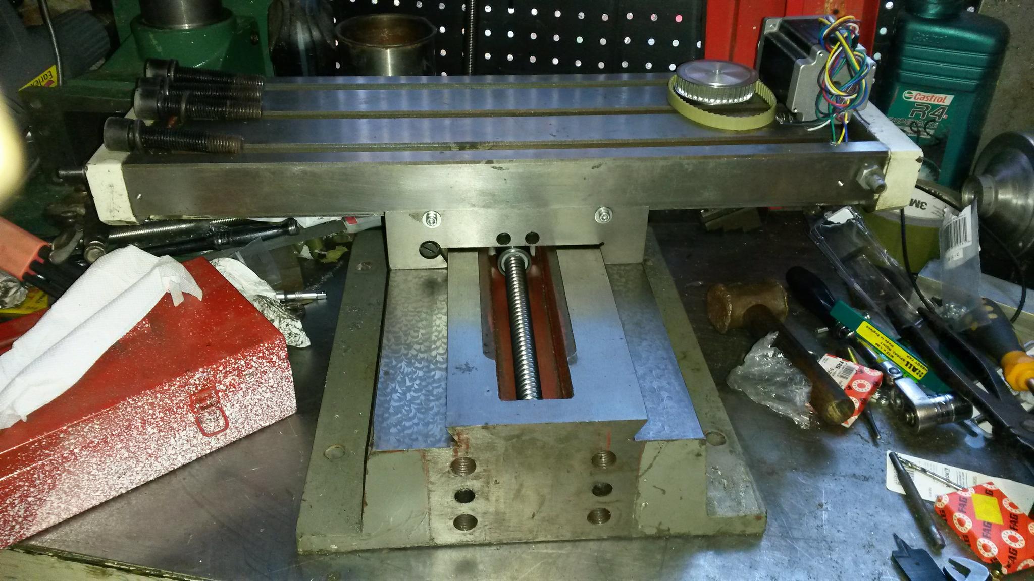

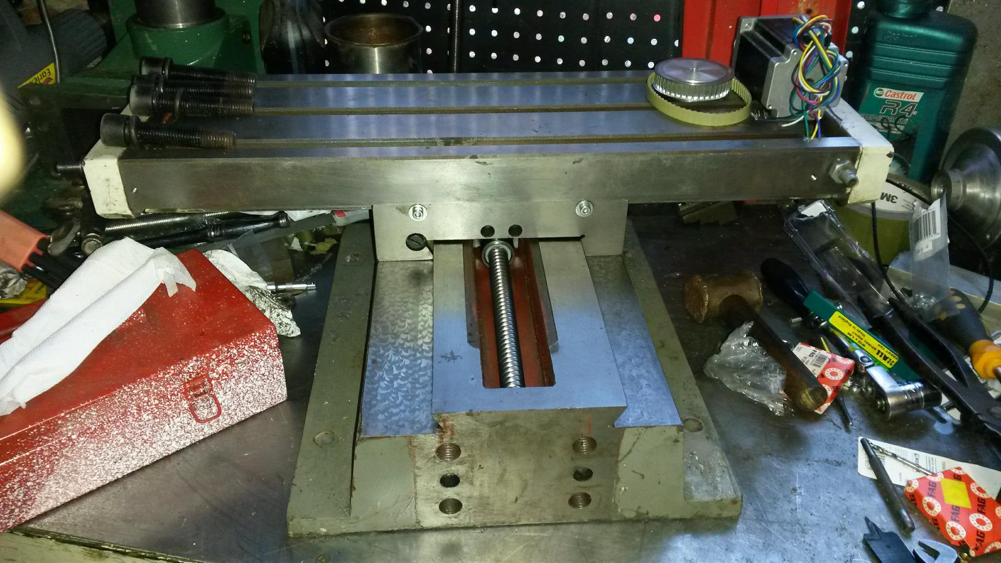

    Once the table is fitted it's time to see what needs doing with the column :D
    Table fitted.

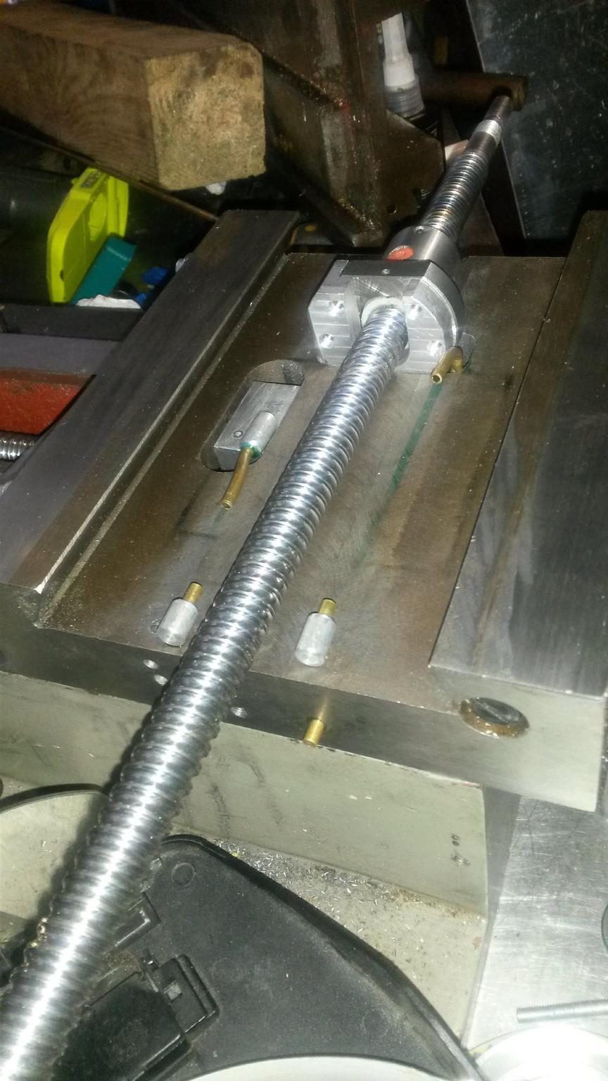

    Column stripped, offering up the Ball Screw and Ball Nut Assembly and working out what's required to connect the Ball Nut Assembly to the vertical slide.
    I'm leaning towards a solid connection to the vertical slide rather than the "Peg and Socket" arrangement used in the standard column assembly.
