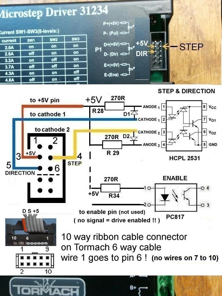

    adding more detail to post 7 for any one wanting to use a BOB with opto-isolated outputs and stepper drivers with opto-isolated inputs
    the problem with the BOB supplied as part of the kit is ue use of the slow PC817 opto-isolators used for the outputs
    I would expect the DM860A stepper drivers would have a PC817 on the enable input and a high speed isolator like a HCPL2531 for the step and direction inputs
    as used on this Tormach driver input
Name:	10 pin connections 3.jpg
    the diagram is from
    https://www.cnczone.com/forums/torma...ml#post2107952
    if I used a breakout with opto-isolated outputs then I would look for a BOB like this -
    https://cnc4you.co.uk/resources/Brea...ard%20HG08.pdf
    or this
    http://www.electronics-lab.com/proje...r-cnc-routers/
    they are just two of example found
