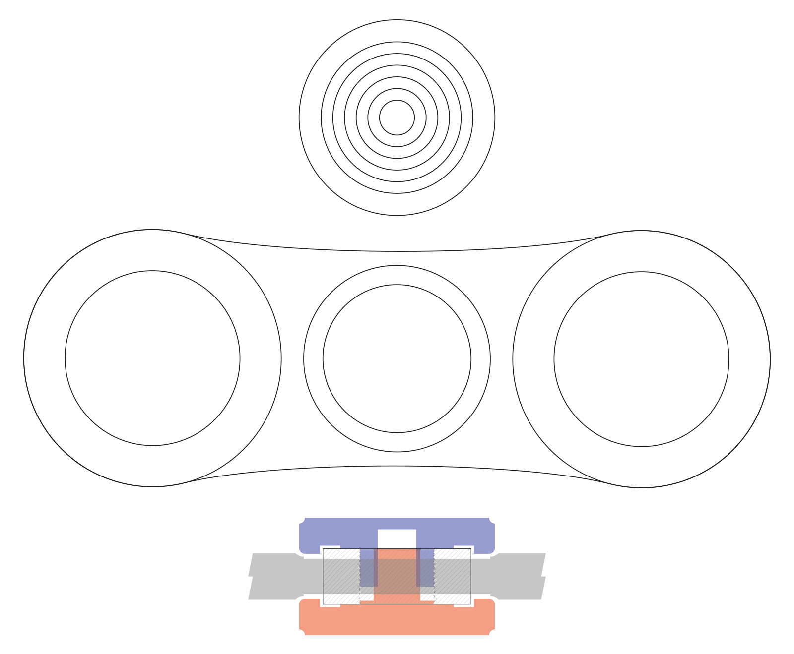

    Didn't have the first clue about these things, but after a bit of searching (both the internet and my offcuts bin) I decided on a lightweight 7075 body, CZ121 brass weights and a miniscule R188 stainless/ceramic hybrid bearing. I kept the design deliberately simple, as my main priorities here were about focusing on decent interference fits for the weights and the bearing and having the thing actually function! - I may re-visit this project at a later date and try a more 'interesting' shape, but for now I'm okay with the (elegant?) simplicity.

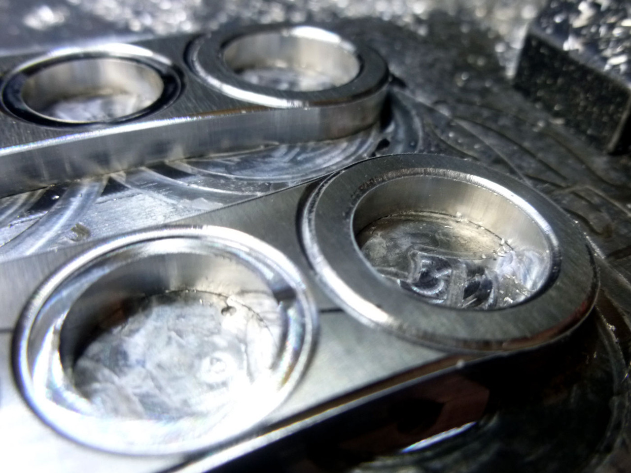

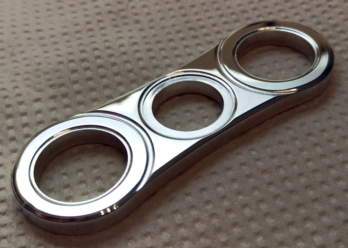

    Here's a vid of the 7075 body being machined:
    ..and a couple of pics of the results:

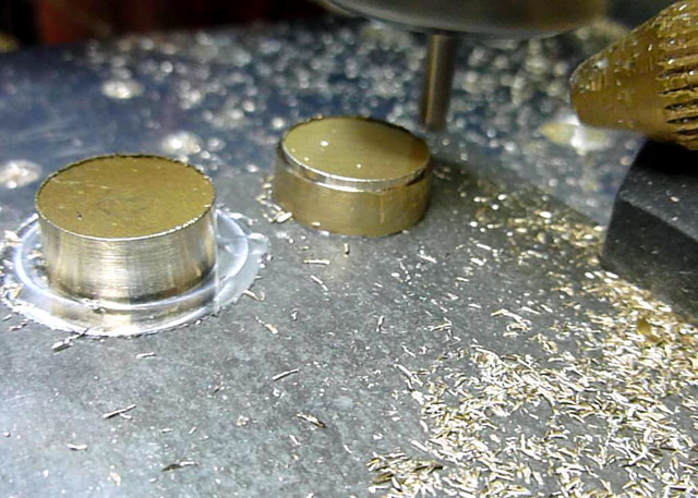

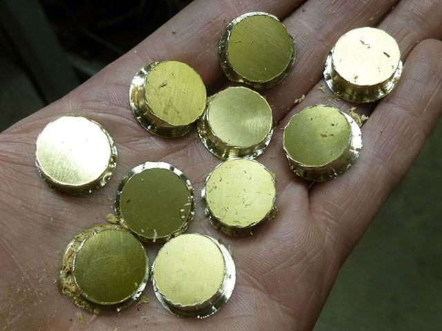

    Then it was the brass - I used a hole-saw to cut out some blanks from a piece of 1/4" scrap - then machined 'em to size - well, 0.025mm undersize with a couple of spring passes.

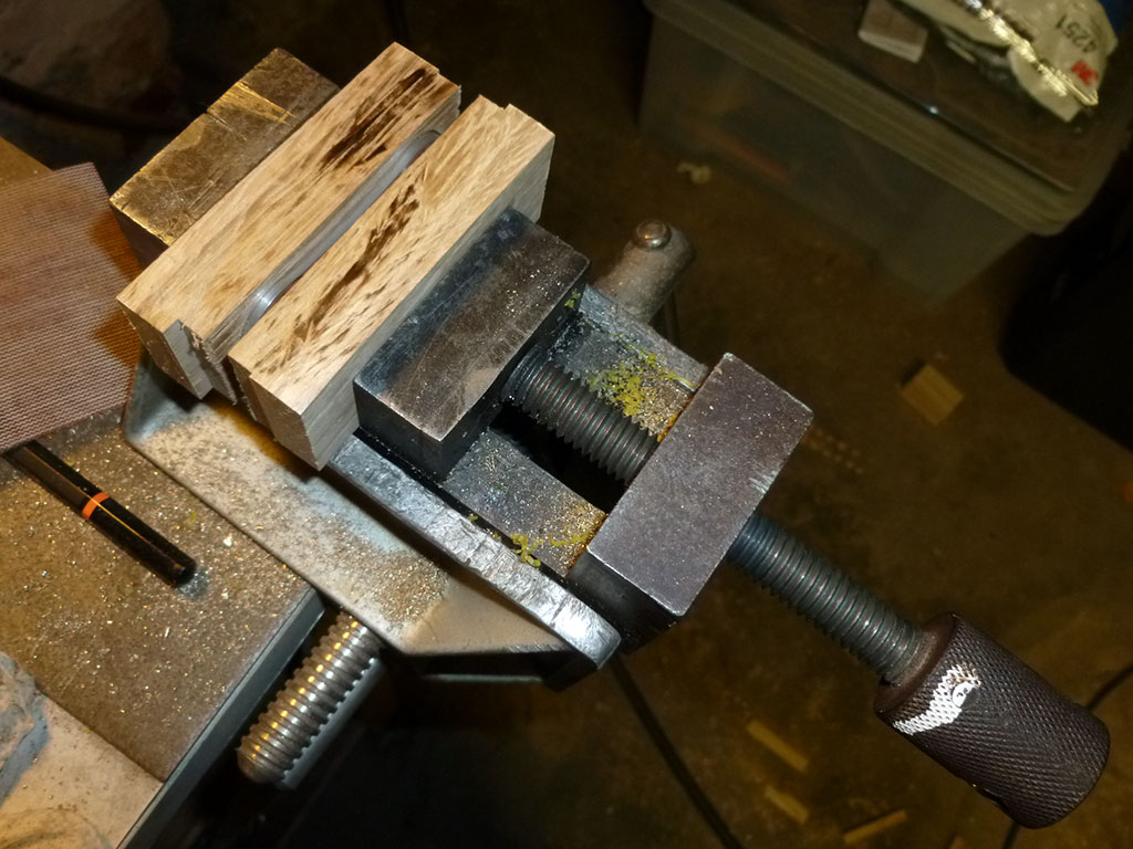

    Once that was done, I made a little press out of some oak:
ID:	24177 Click image for larger version.
    Here it is in action:

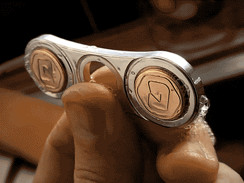

    Then it was a case of jigging that lot up and engraving the lad's initial (G) onto the brass, along with a bit of a ball-nose chamfer. Don't have any video of that, but here are the results, fresh from the kitchen sink:

    The design relies on a couple of little 'shelves' that clamp the inner race of the bearing. Then there's a bit of clearance within the interior of the rest of the cap - the inner race is a bit baggy by design, so you don't want the outer race that partially protrudes from the body fouling the caps.

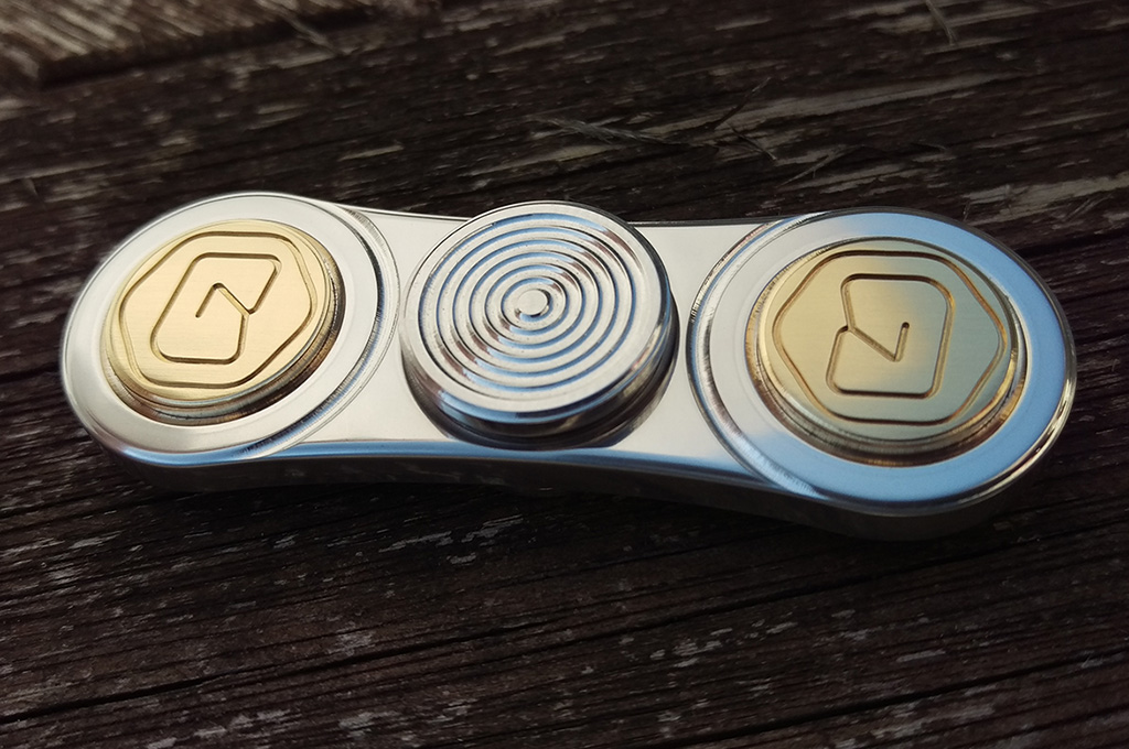

    Once these were polished I pressed in the bearing with no issues - and fitted the caps. The finished article:

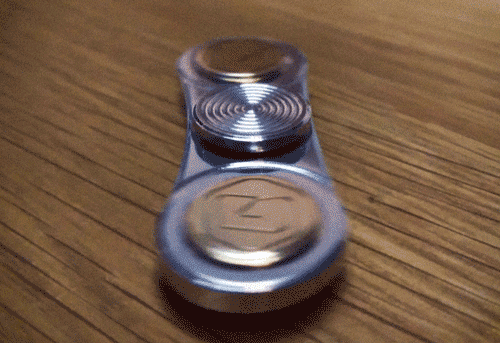

    And who could resist revving it up with the air line..? Not me:
    That's only at 2 Bar... <Opens it to 8, thinks carefully, then closes it again..>
