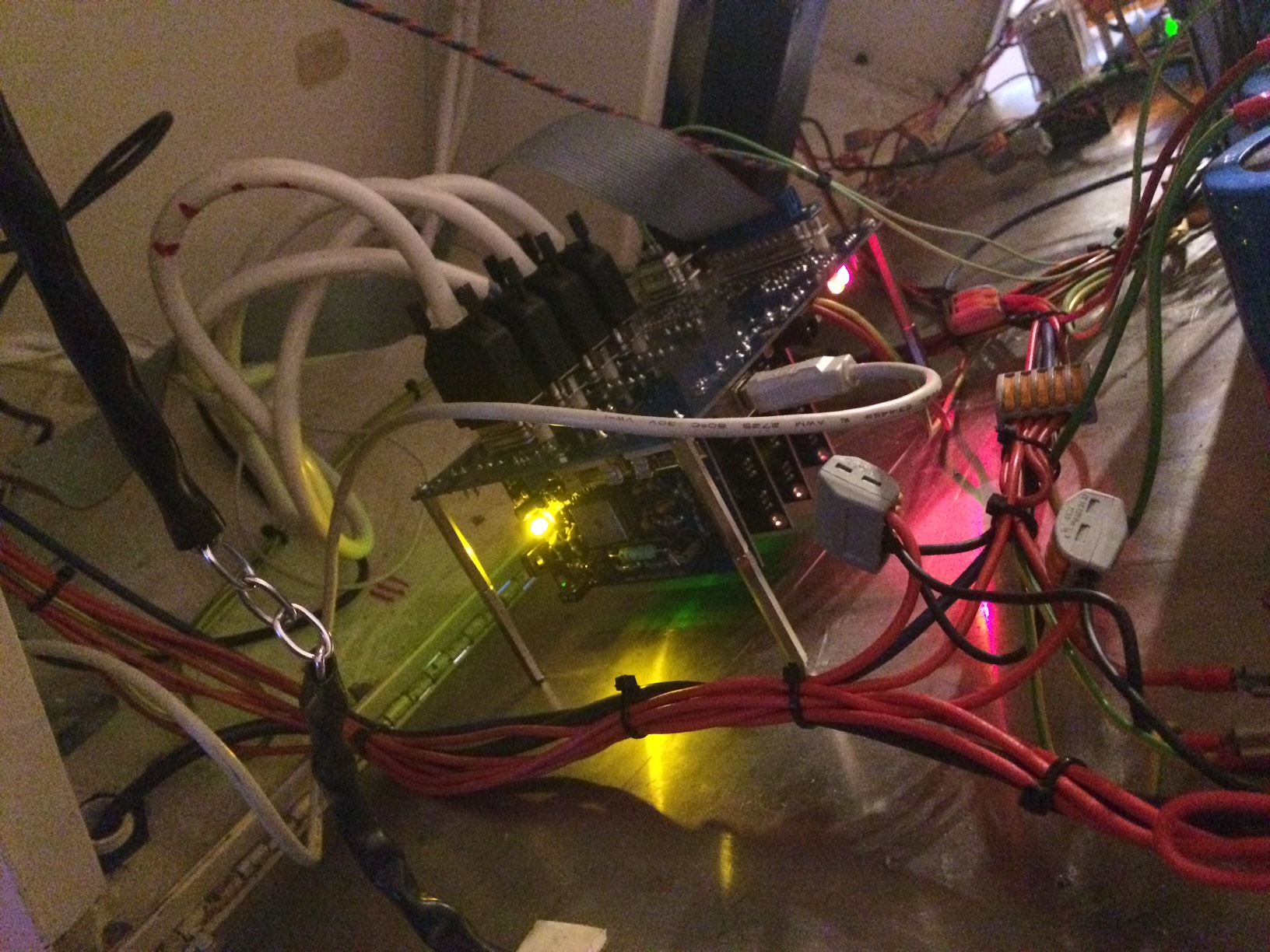

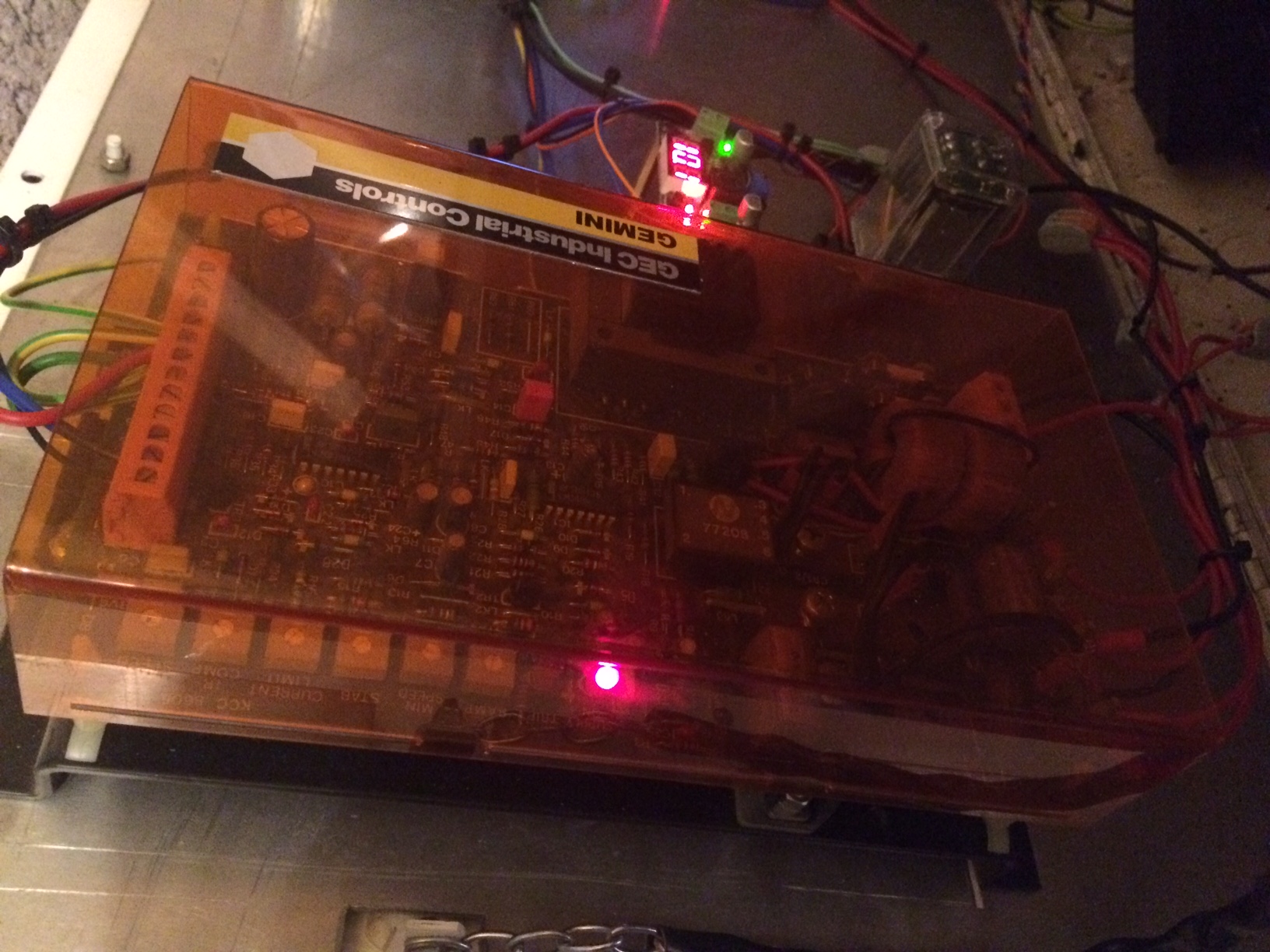

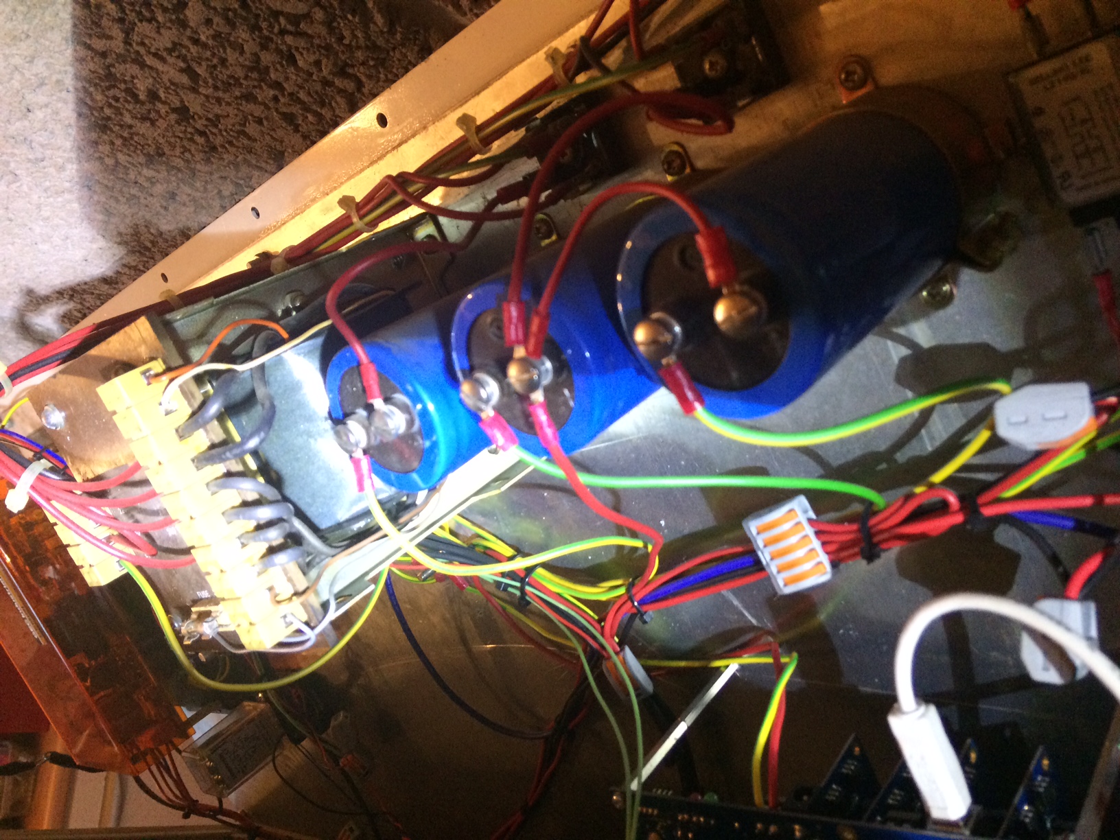

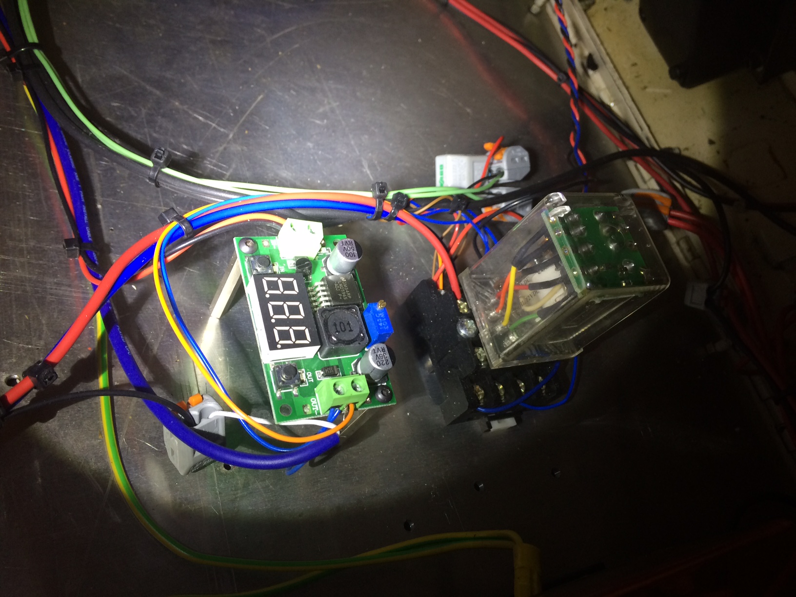

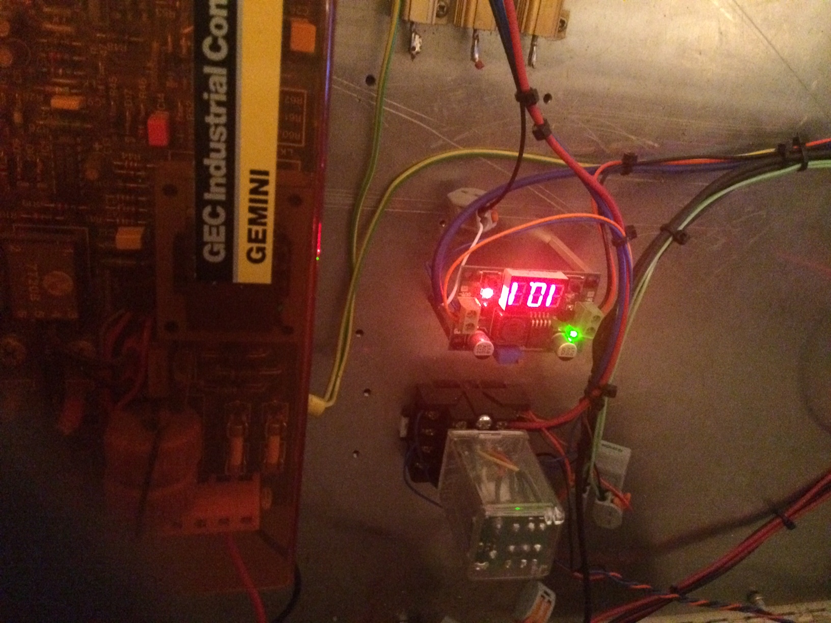

    Right-oh. I hear you. I dropped the back off the machine and it's packed PACKED with electronics. Lots of leds lit up, a Gemini controller, boards left, right and centre, miles of cables and a small digital display the reads '10.1'. The list of gizmos goes on and on and on. So, I'm going to try an post pics.
    Strap yourselves in...

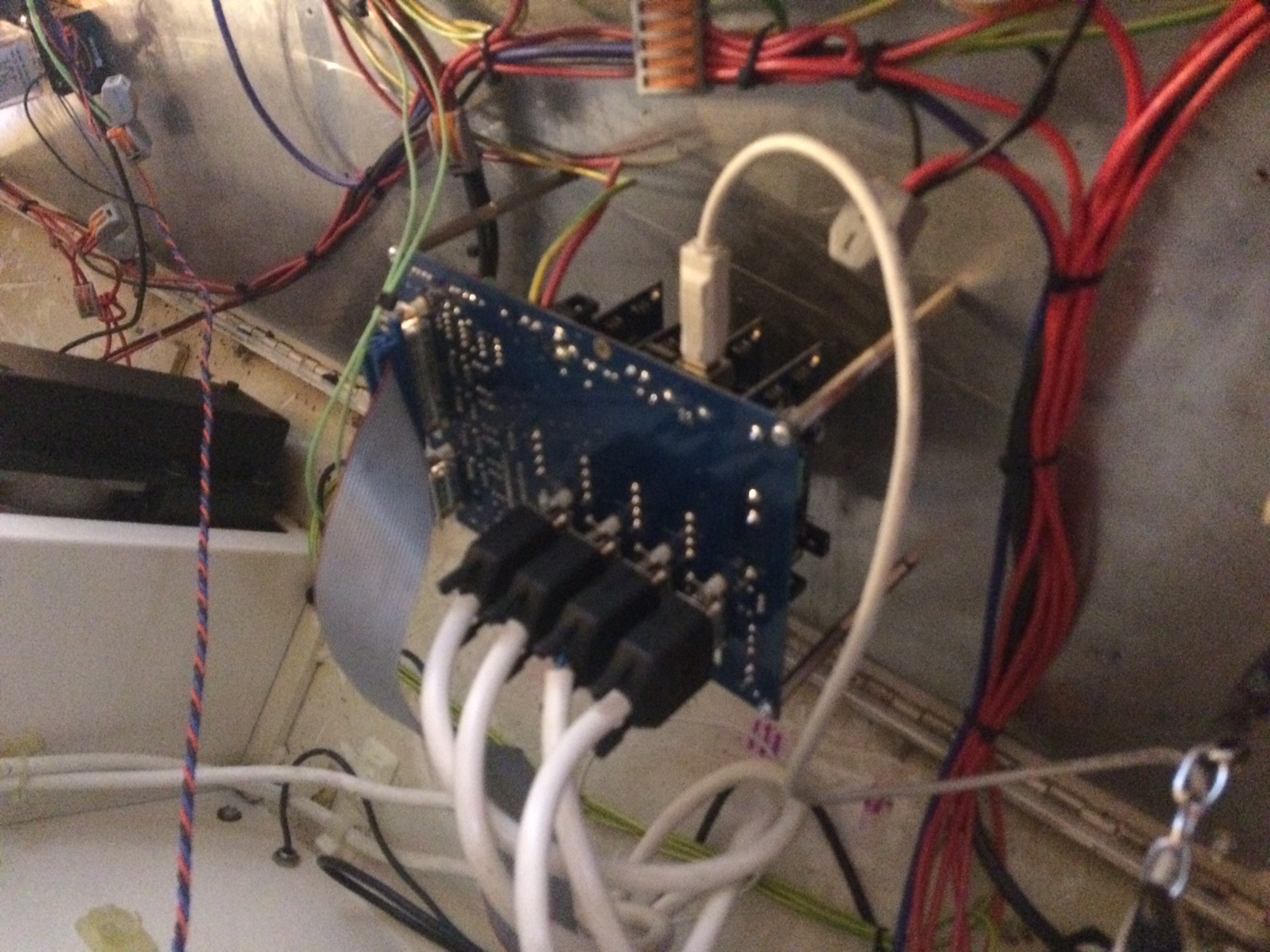

    The only things I recognise is the Boxford power supply and the gemini controller, and maybe that 10.1 disco light is a voltage controller. The motion controller board - ???? Presumably the USB connection just provides 5v for the optos and the rest is a standard LPT connector that you infer is run by a USB to Parallel adapter (UMMMM).
    Anything printed o the board in pic 2 ?
    Fairly recent conversion, judging by the Wago connectors.
    Did you see it working before you bought it ? That is the pivot point as to where to look.

    Can't see anything printed on the board.

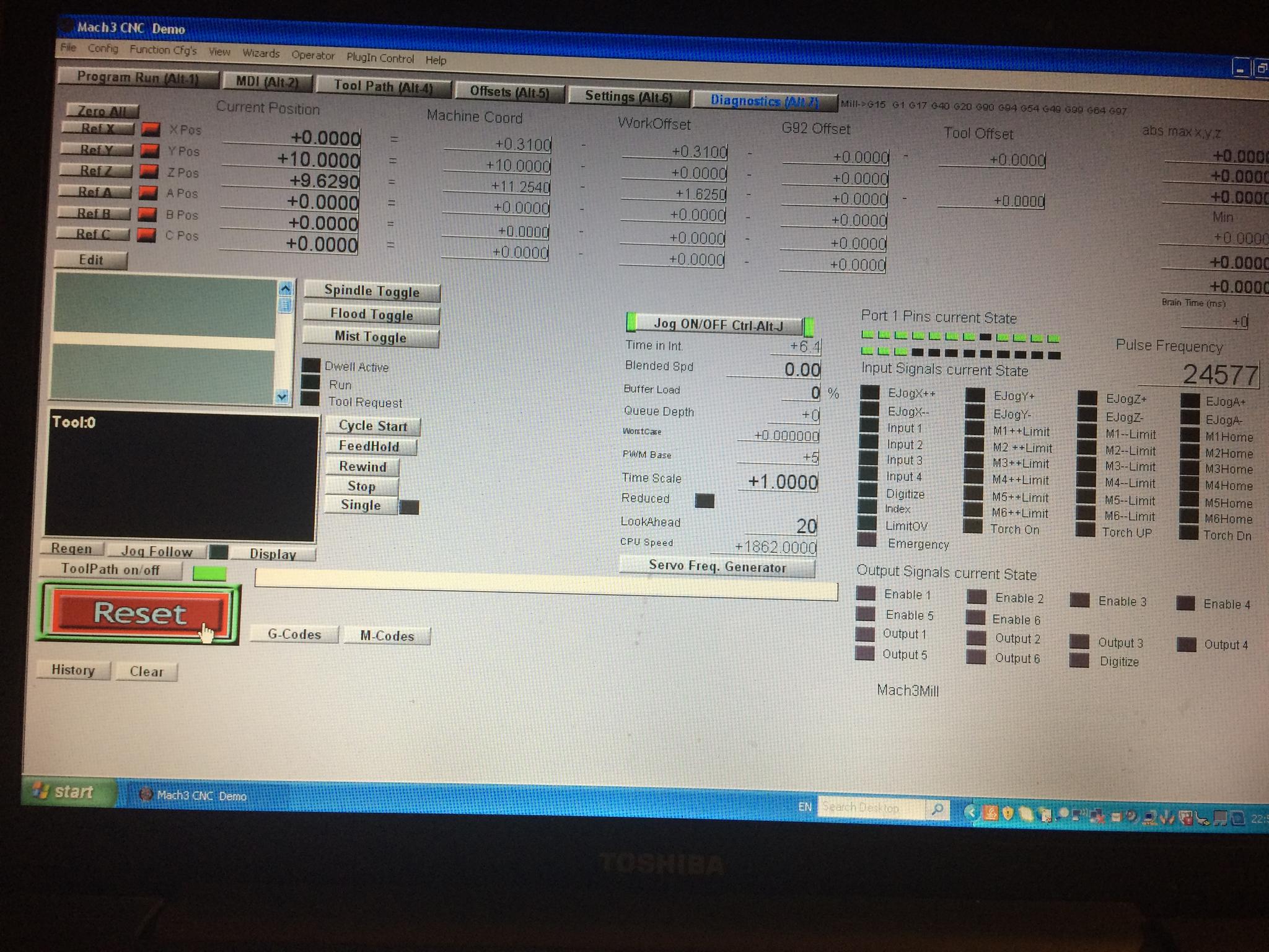

    Tell you what, though, I've made some kinda progress this evening. After a bit of research aided by wine, I discovered that Mach3 isn't that keen on 64bit processing. So, in a fit of being productive, I dug out an aged laptop. After doing a Windows XP re-install, checking that it's a 32bit outfit, I then installed a Mach3 demo. I plugged it all into the mill but still nothing happened. However, after a Driver Test (all excellent, I'm reliably informed) the diagnostics seems to confirm that the port 1 pins current state is lit for eleven of the twelve bar of lights. If I enable port 2, the bar underneath lights up with three greens (pic attached). Pulse frequency is 24599, give or take.
    There's clearly something happening but still no life from the mill motors. I expected it to burst into life after inputting a few G-codes but it's still treating me like a contemptuous cat. Yes, e-stop is all green.

    First of all, it is not advisable to use a laptop to control Mach3. Mach3 takes over the printer port and needs full control. Laptops have power saving features that interfere with this. You may find this out later, but for now, it'll do to get you up and running.
    Have a look at this ftp://ftp.machsupport.com/Docs/Mach3...20Tutorial.pdf It is worth going thru the steps to get your steppers stepping. Do you know what pins your machine uses - useful info to have this written down.
    Cheers,
    Rob
    PS I have never figured out what those green thingies mean on the diagnostics screen.

    I bought the machine on good faith. I had never seen it running but my gut (since proved correct) was that the machine was well-cared for and had a boatload of money thrown at it with a full and comprehensive conversion package from Mike Gaynor at Routeout CNC. It came with loads of add-ons and spares. It just needed correctly configured.
    SOLVED!
    In short, two things:
    1. I needed to download and auto install the driver for the UC100 that I'd identified as a motion controller (and not simply a port adapter, as I initially thought).
    2. The charge pump setting wasn't configured correctly, in fact, it wasn't configured at all!
    The thing burst into life once that was set. (Grateful thanks Mike Gaynor!!) Now I'm in the process of tuning the motors. I'm running two laptops, side-by-side. One is the control/default; the other is for tweaking/meddling, and I swap between the two to identify what the changes do to the CNC, if that makes any sense.
