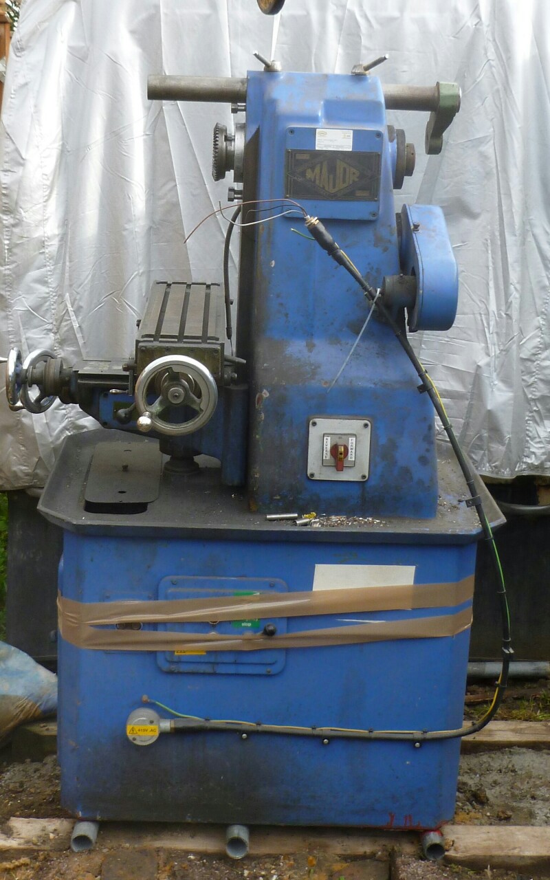

  1. Can anyone point me at info for a Richard Haighton Ltd 'Major' Horizontal Mill?
    I've been offered this one (which I mistook for a Tom Senior) and I'd like to know a little more about it.

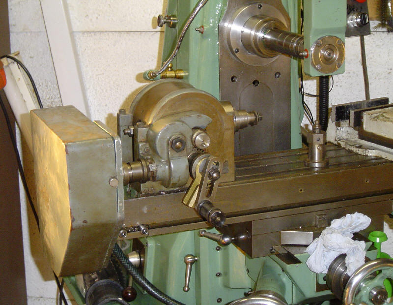

  2. Well, I found out it is an rather unusual copy of a Hardinge UM so I bought it to keep the HLV company.

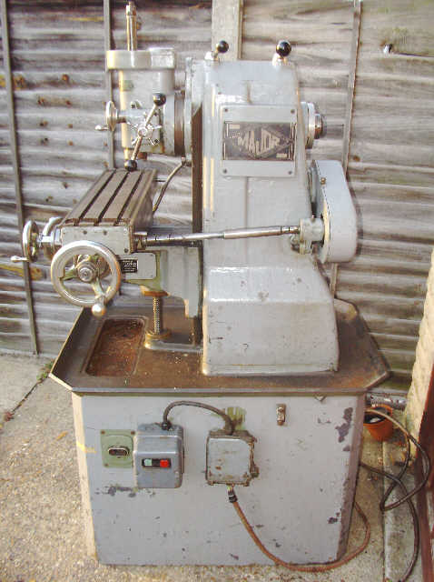

  3. Just a quick update on the rebuild....

    So what are the bearing surfaces like?
    Enquiring minds need to know :naughty:
  5. Quote Originally Posted by Robin Hewitt View Post
    Good - even for a 50 yo machine, better in fact than my RF30
    The vertical column still has the original hand scraping all the way up
