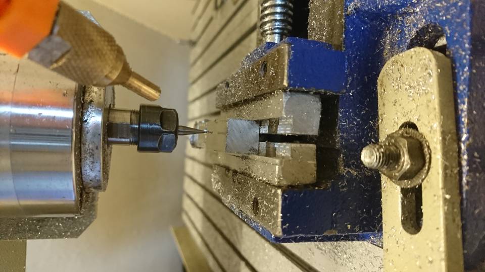

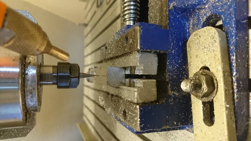

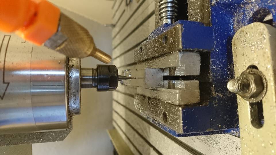

    My 3040T has started to drift right. It starts quite well then drifts .5mm if a rapid change in direction is there or it lifts to make a fresh cut.
    On a simple lego block program the first pass is OK ish. 2nd pass cuts into the brick risers. And is off on the right by 0.96.
    I set new alu Jaws in the vice and machined those manually with toggle. So I know they are true.
    As when trying to engrave it steps each character up 0.3mm or wanders off diagonally.
    Machine settings are
    400,1500,400 all 3 axis mach3.
    I don't know if it's software or hardware that's causing the problem. Screen jog shows on target. Tool tip tells a different story.

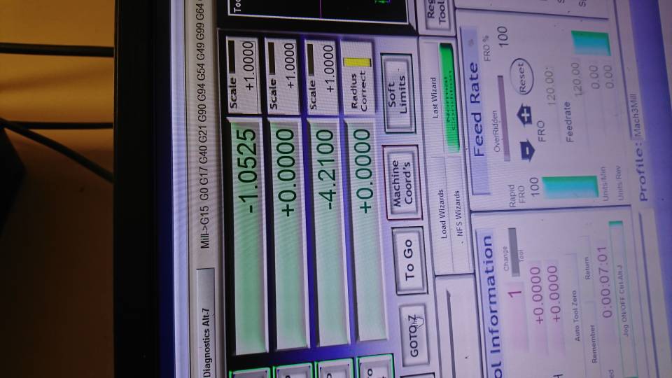

    It's no different, I let it run 1/4 of that process, and stopped it. It's 1.0525mm off from x zero on return to zero.
    So controller issue? Click image for larger version.

    Sounds like you might be losing steps?
    Drop your acceleration and max speed to half what they are currently and re-test.

    I went half speed it went far worse. I upped the feed rate to 279 from 190 and its bang on. Its slower feeds it struggles with.
    I need more confidence in the tooling
