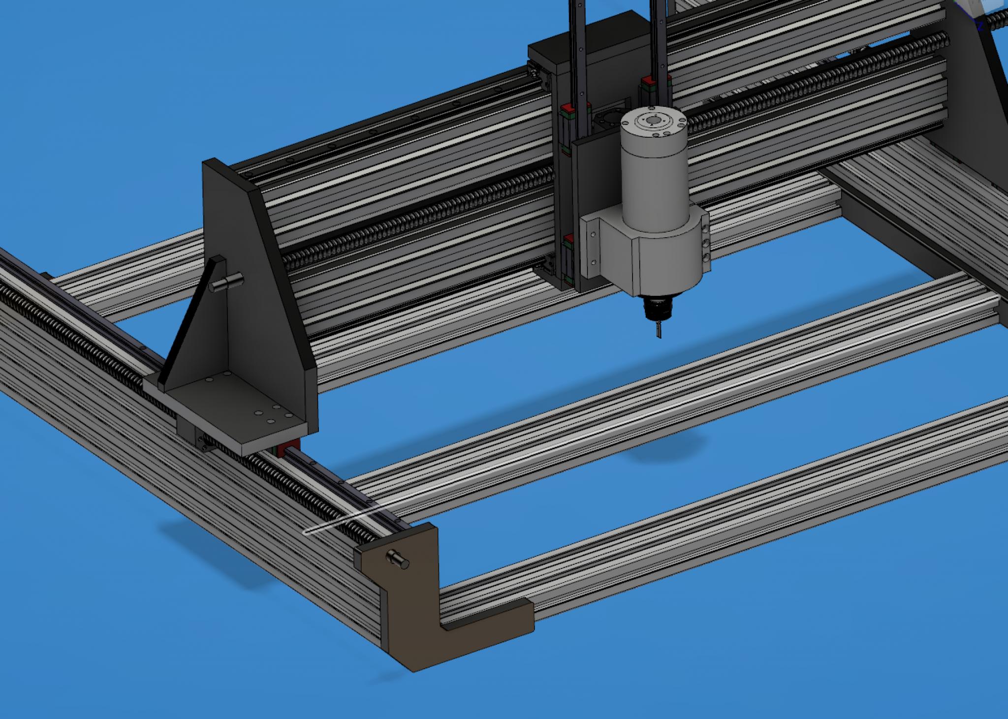

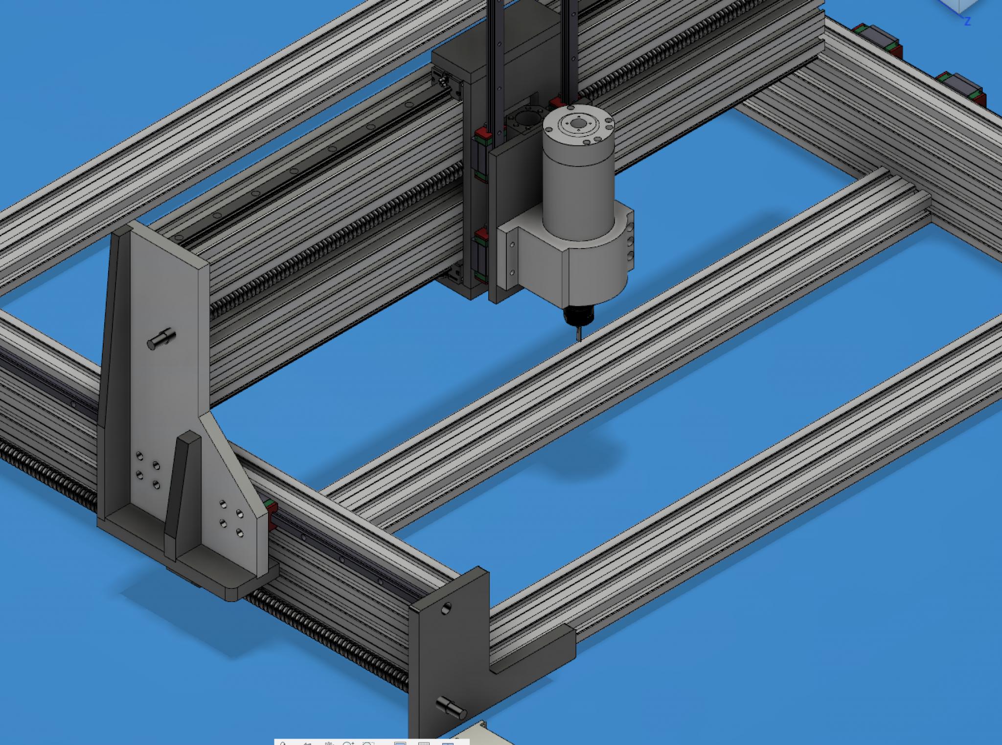

    I have two different Y axis arrangements which I'd be grateful for some input on please. I originally designed my machine with top mounted linear rails but then thought I would give side mounted rails a try in order to lower the gantry by about an inch. The trade-off is that my bed will have to shrink by about 80mm from side to side as I've already got the gantry profiles (I know, design first, shop later - I've now got this tattooed on my forearms!).
    Any opinions about the pros and cons of either would be much appreciated.

    On top of the side beams is fine.
    Using 2 separate extrusions for the gantry is a lot weaker than one big one. If you already have them, it is worthwhile using a plate on the back to join the two gantry extrusions.
  4. #24
    Either of those two setups will work, but unlike pippin I'd favour the second one in which the gantry beam is bolted to the same plate as the bearing blocks. In the first you have an extra joint to complicate things.
    Totally agree on the joining of the gantry beams though, they should be one solid unit, preferably in an L configuration.
  5. #25
    I think that I am leaning towards the second option, it does make sense that the gantry beams and the bearing blocks being fixed to the same piece should be more rigid.
    Great call on joining the gantry beams together, I hadn't considered that at all. I guess a few pieces of aluminuim plate or profile offcuts would do the job.

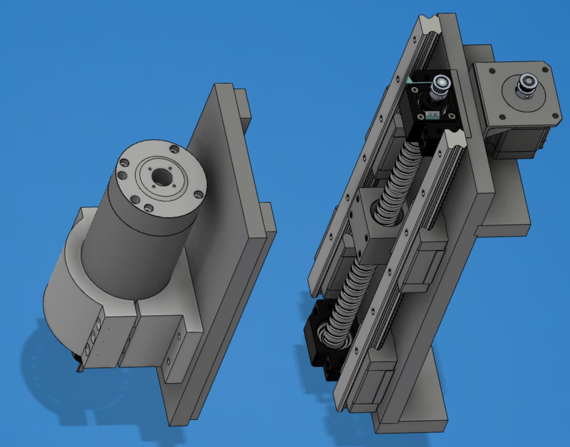

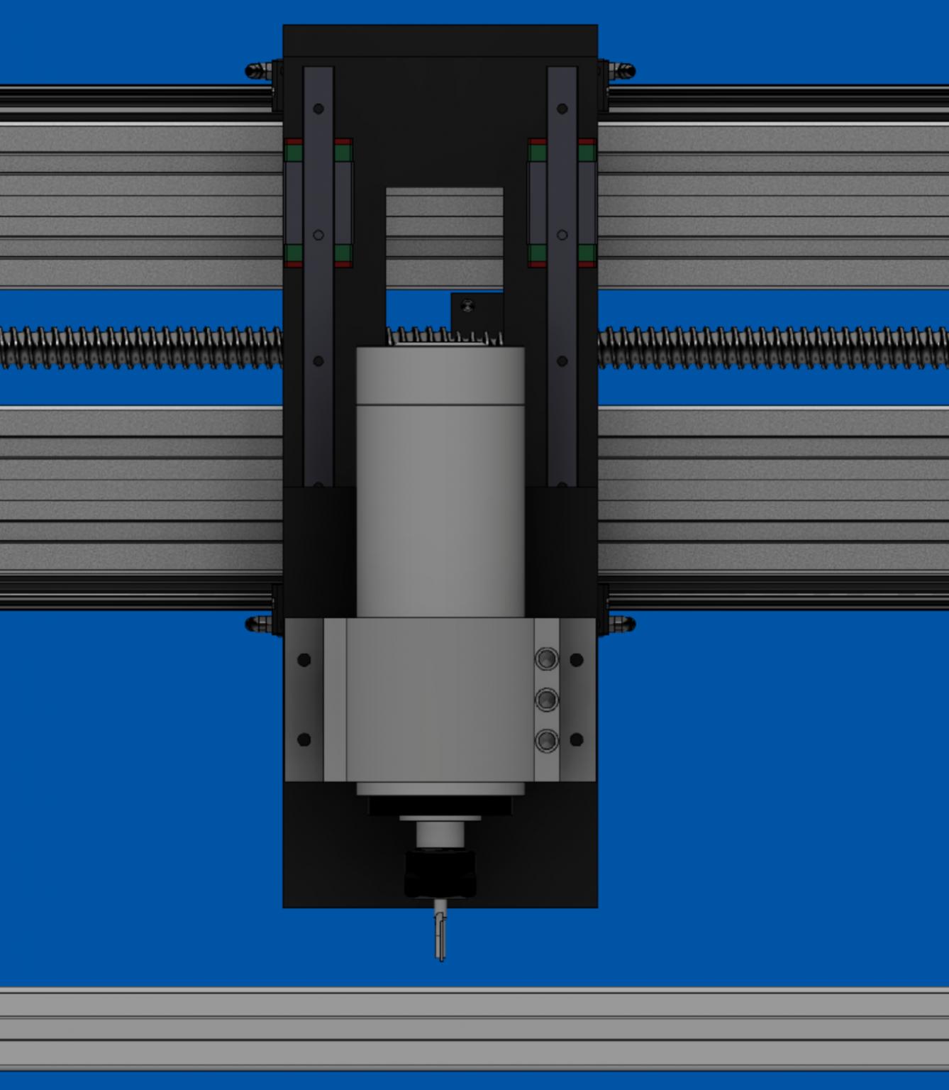

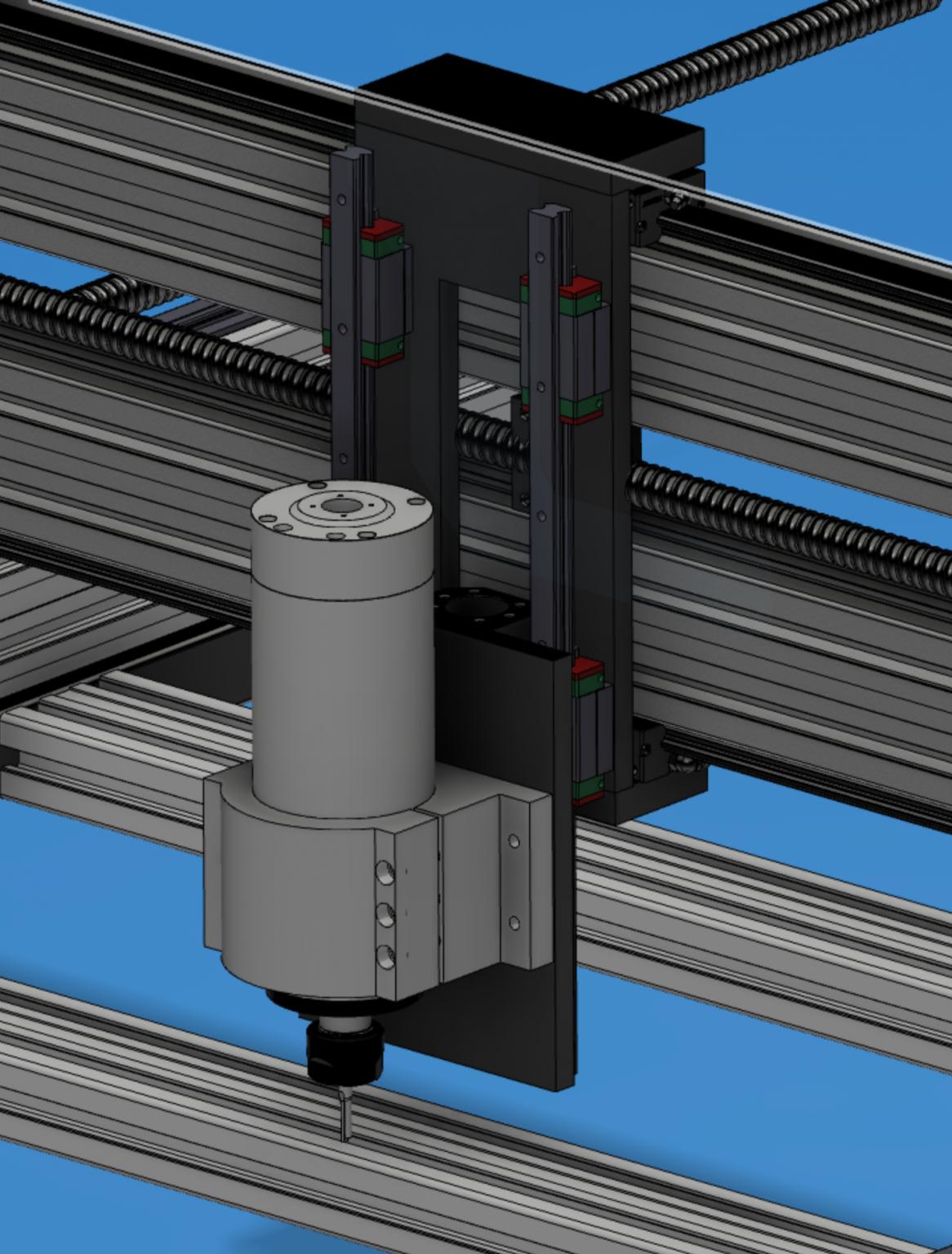

    I've been paying some attention to my X and Z Axes design this week and I'm starting to question whether I have built my gantry too high. The fully extended Z Axis looks like it could be vulnerable to excessive deflection given the amount of extension from the gantry.
Name:	Screenshot 2020-01-19 at 09.54.41.jpg
Name:	Screenshot 2020-01-19 at 09.54.54.jpg
    What I realised is that most of the work I'll be doing will be on relatively thin material (12-40mm) so the router will be operating at full extension most of the time. I also realised that this must be a problem for a lot of machines; do most people raise the bed in order to minimise the deflection of the cutter? I would like to work material up to 100mm thick and I currently have about 120mm clear travel on my Z axis.
    Rather than compromise my design to accomodate thick material do you think I would be better to design a machine to work thin material well and accept that I just won't be able to work thicker material. Being able to work thicker material was a bonus rather than a necessity.

    Well, first I think you need to rethink your Z-axis design because that cannot possibly work how you have it shown now.?
    Regards the Gantry height then it depends on what your cutting. All the machines I build have at least 100mm of Z travel and most have 150mm and will happily cut aluminum at full extension with a reasonable finish quality and accuracy using correct feeds n speeds. If you require a higher finish quality or deeper cuts or higher feeds then yes it's better, even necessary to have a lower machine or if not then a machine that is built much much stronger than your typical router needs.
    To be honest I'm not a fan of the open gantry design you are using with the profiles orientated in the vertical position which is there weakest orientation. Those same two profiles could make a much stronger gantry if you made it an L-shape and put the screw at the rear.
  8. #28

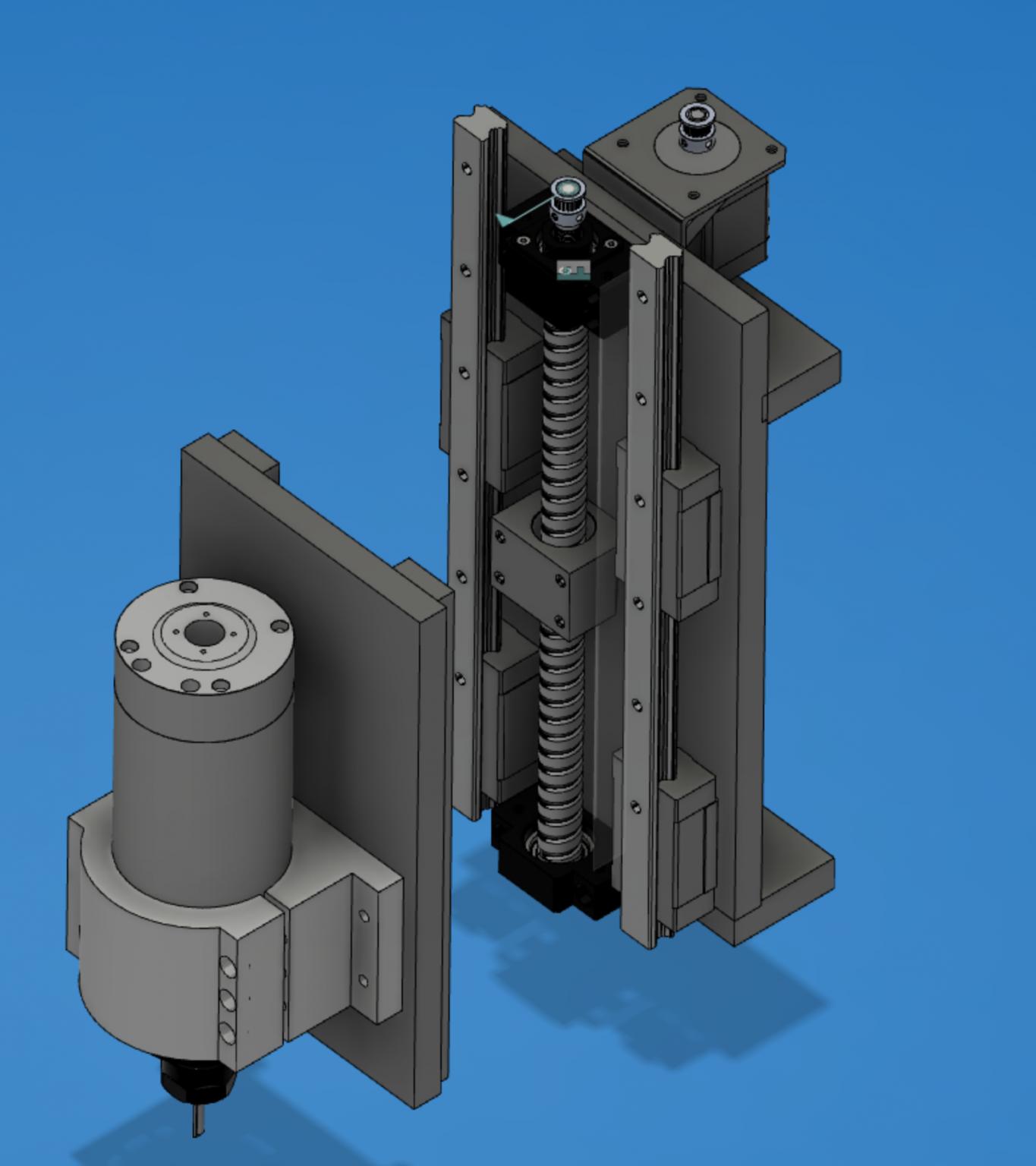

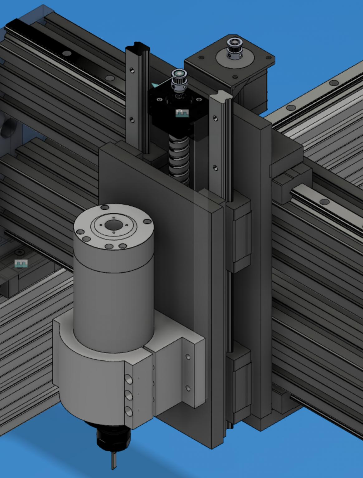

    OK, I've gone back to the drawing board with my Z Axis and had another stab at it.

    With regards to the gantry, the profiles that I have are 80x80 heavy which I intend to brace across the back with perhaps 3mm aluminium sheet or some flat bar. I had thought that would be sufficiently strong for my needs (I'm cutting wood, MDF, ply, plastics and possibly the odd bit of aluminium), do I need to beef it up further?
    Is it the case that you tune the machine's feed rates to the strength and stiffness of the machine?
    I intend to use timing belts to drive 2010 ballscrews on my X and Y axes. Is it worth having two sets of pulleys and belts to gear it down for cutting harder materials?

    I had assumed that your previous drawings with the spindle back-plate were making it shorter so we could see past it, but your latest drawings seem to continue the theme. Are you genuinely planning to have the top of the linear rails for the Z axis hanging in mid air like that? Seems like quite a flimsy design decision for the minimal cost of some extra aluminium plate.
    I'd also doubt that the ballscrew needs to be that long - but I gather you've already purchased it?
  10. #30
    Yeah, I see what you mean about those rails being unsupported when the Z is lowered and yes, I have already got the ballscrew.
    Three options then:
    - Add more plate to lengthen the router mount plate.
    - Consider shortening the whole linear travel by cutting the rails and ballscrew.
    - Buy another ballscrew. (perhaps a 1605 would be sufficient?) Looks like I can get one for about £33 with the supports, nut bracket and coupler so that won't break the bank.
    I had previously wondered about shortening the ballscrew using my ML7. I'm not a very accomplished machinist and my biggest concerns (apart from completely stuffing the job up!) were about the hardness of the ballscrew and whether the action of cutting into the thread might make the cut wander.
