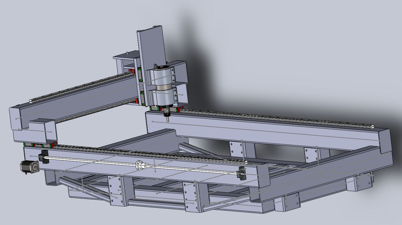

    Hi all, this is the first post of my build log.
    After reading a lot on this site i made some of the build decisions.
    Basically it is a half raised gantry router.
    Planning on 15mm alu toolingplate Z-Axis
    1st.. size.
    - 1500x 800 x 200 mm work area.
    2nd materials to be cut.
    - Wood and aluminium.
    3rd basic building material.
    - Steel box section. 120×80×4mm and 80x80x4mm
    Router type.
    - 4 bearing Chinese WC ER20 2..2kw
    VFD ...
    -Danfoss FC-51 type.
    linear stuff.
    - 20mm rail, c7 rolled ballscrew1610 for Y, 1605 for Z, 2010 for X
    - 4 x nema 23 3 or 4 NM type
    Or maybe 2 nema23 and 1 nema 34...
    Is undecided for now.
    Tools
    -I have no access to mill.
    -I have access to old lathe. but no real experience
    - Basic hand / power tools.
    - Design sw
    Solidworks.
    Cnc controls
    - Eyeballing uccnc300eth
    - Digital drivers 68v diy psu
    So that is the plan.
    I do notice i am refining the plan on the go.

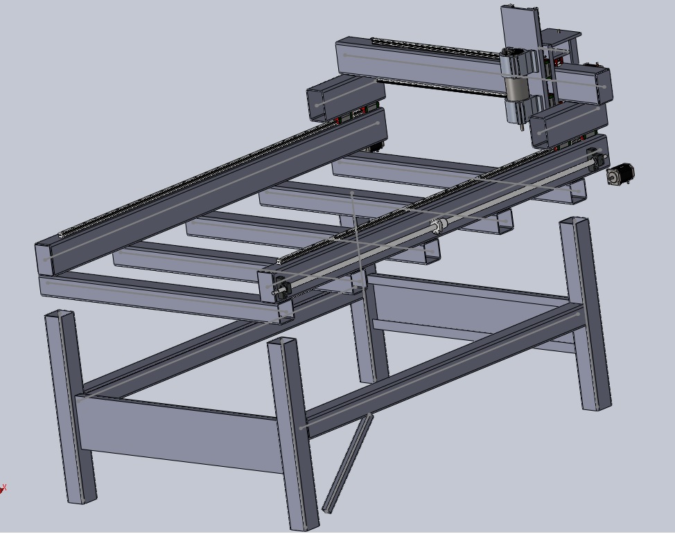

    Yes... pictures... ill try to post on every progress..
    Actually i started work on a design over a year ago.
    1st the plan was to make an adjustable bed.
    This over complicated the design.... or weakened it...
    now the design is more basic.

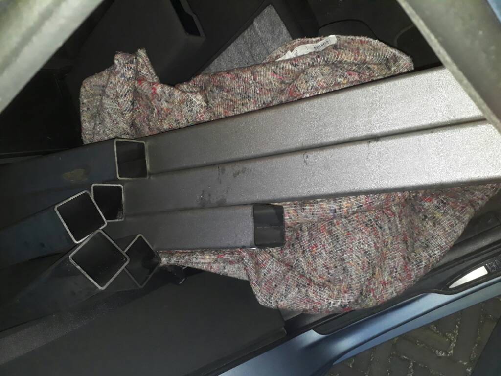

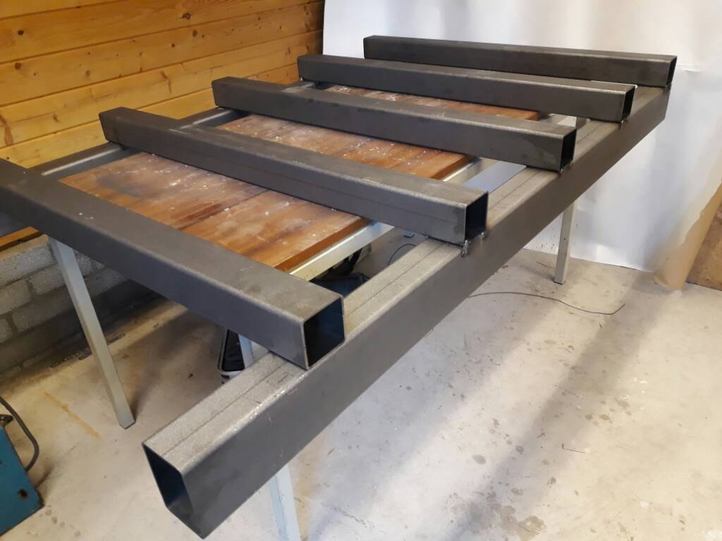

    Buying steel is not a problem.
    Getting 6mtr length box section cut or stored in my shed is..
    Shed is just 5.7m X 3.7m
    So i orderd the steel box section, and some end plates pre cut, ready to weld up.
    A friend of mine works with steel, he is my main supplier for steel related stuff.
    We share a hobby 150 Amp migwelder. (Cebora)
    It was bought for automotive related welding.
    This is what the start of my cnc hobby looked like in the back of my car

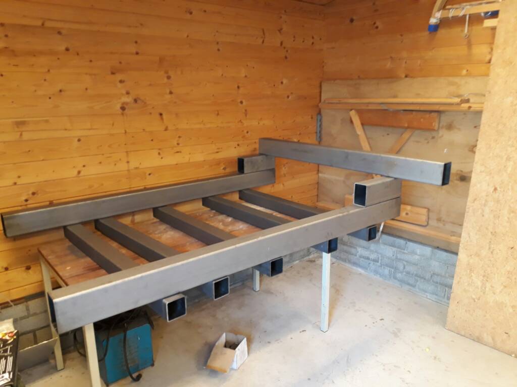

    I spirit levelled the top of a standard used desk for setting up the bed box section.
    Dont ask me why i did not start with the legs of the frame.
    Ok .... its gonna be bulky...

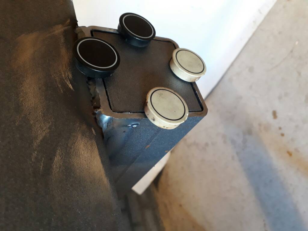

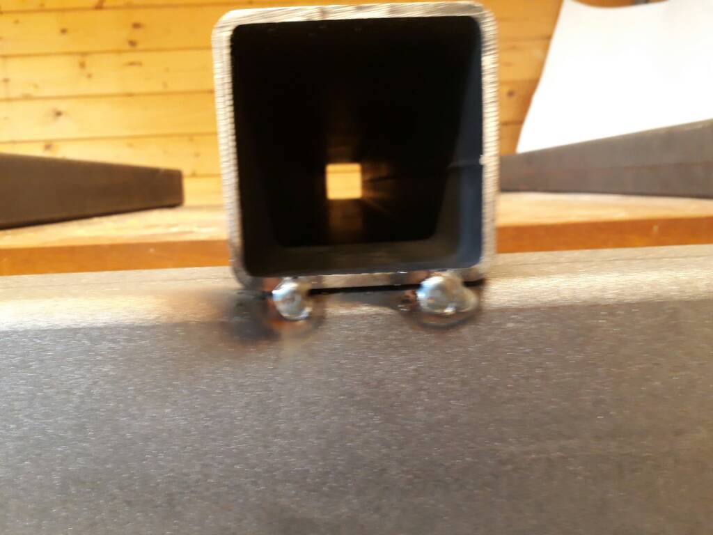

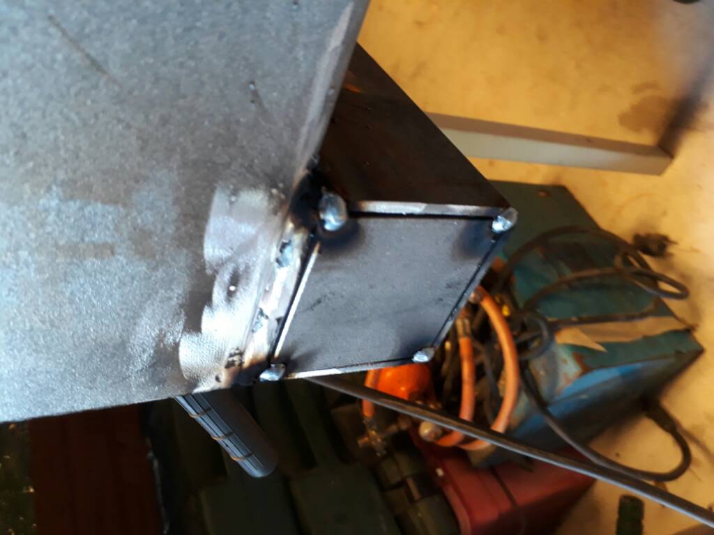

    Tag welding it up
    After final welding i found out warping will happen...
    Total distortion is now +/- 1.5 mm
    1850x1160 mm total size.
    I have read on this forum this could happen... But is was still more than i expected.
    Epoxy has to solve this problem in a later stage...
    More to come.
