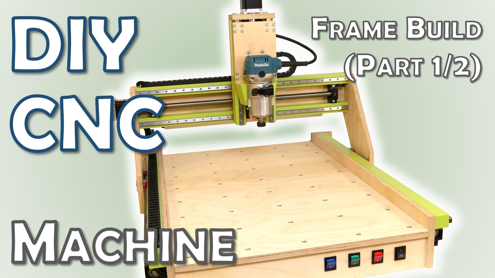

    Hi all,
    I've finished my first CNC build, a three-axis router with a wooden frame. With all my DIY projects I usually try to incorporate natural materials where possible. For the CNC project, it has also helped me to keep the costs in check and the stiffness seems to be quite high. I've documented the building process in the following two videos. For the ones planning a similar build, you can find all the parts links in the descriptions of the videos.
    Since this was my first build I'd love to hear your feedback. Thank you, Roman.

    Nice work Roman. My first CNC machine was plywood and it actually worked quite well and I made a lot of parts with it although in the end I found its limitations and it evolved to all metal parts. Things like relaxation of torque of the gantry screws as the wood starts to compress over time, and frame flex when pushed harder creating oval circles.
    As I’m sure you know the wood stiffness is up to ~15 gPa whereas aluminium is 70 gPa and steel 210 gPa. But you have used good hardware so if you need to upgrade it will be easier. I also started with a router but the noise was terrible so upgraded to a water cooled spindle.

    A very nice build, I'm envious of your woodworking shop! I started with a couple of wooden machines but nothing like yours. The only common feature was the Makita trimmer as a spindle.
    I'd say the weakest part of you build is the use of a single layer of ply for the gantry side cheeks. This will show up when one of your long axis motors stalls and the other does not
    As routercnc says you have a good set of components to allow for future upgrades to a metal framed machine. I managed to scrounge up enough box section steel from the local tip to build all the frame and gantry for my current design so it was actually the cheapest upgrade of all! I've also upgraded to the ubiquitous 2.2kW water cooled spindle recently which is a joy to the ears(and the neighbours) after the Makita.

    Thank you for the feedback Kitwn. Yes, having access to a workshop with professional machines is a nice privilege.
    The gantry sides were my concern as well but it now seems as if the machine had greater stiffness in the X direction than in the Y direction. But as you said, only time will tell and it can be modified.
