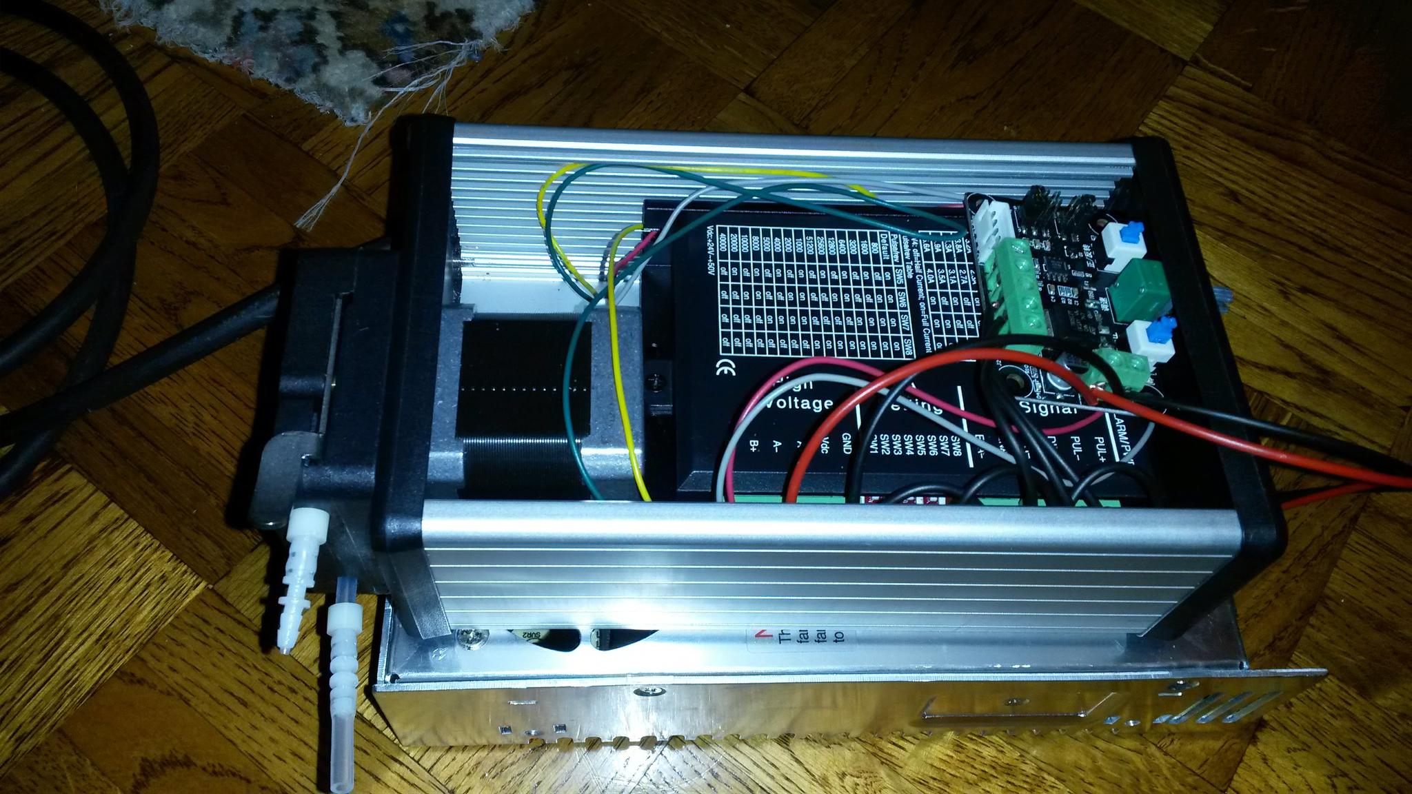

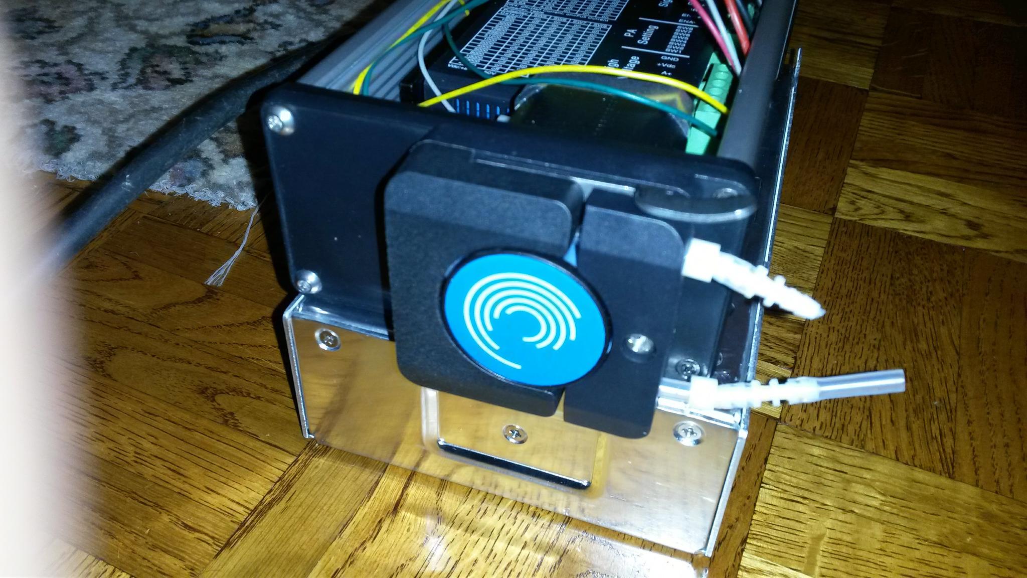

    I've been playing with various solutions to combine air and lube/coolant and have been having some success with gravity feeding the lube using a drip style machine oiler.
    With the lube delivered at the air nozzle there is negligible airborne droplet creation but it's a bit of a pain to get the feed exactly right.
    This is my latest metering system, now I just need to case the PSU and build the new nozzle system.

    Interesting. I was considering how best to do mist coolant so will watch this post. Best option to me seemed to be the pressurised coolant tank arrangement when the coolant is forced into the air flow under pressure rather than drawing it Venturi style with a partial vacuum which I guess this is similar to. But I don’t have an air compressor so no rush to go any route just yet.
    A peristaltic pump with a stepper gives you positive and predictable fluid delivery, no pressurised containers with pressure settings, needle valves, fluid viscosity and so on to upset the balance of perfect lube volume delivery.

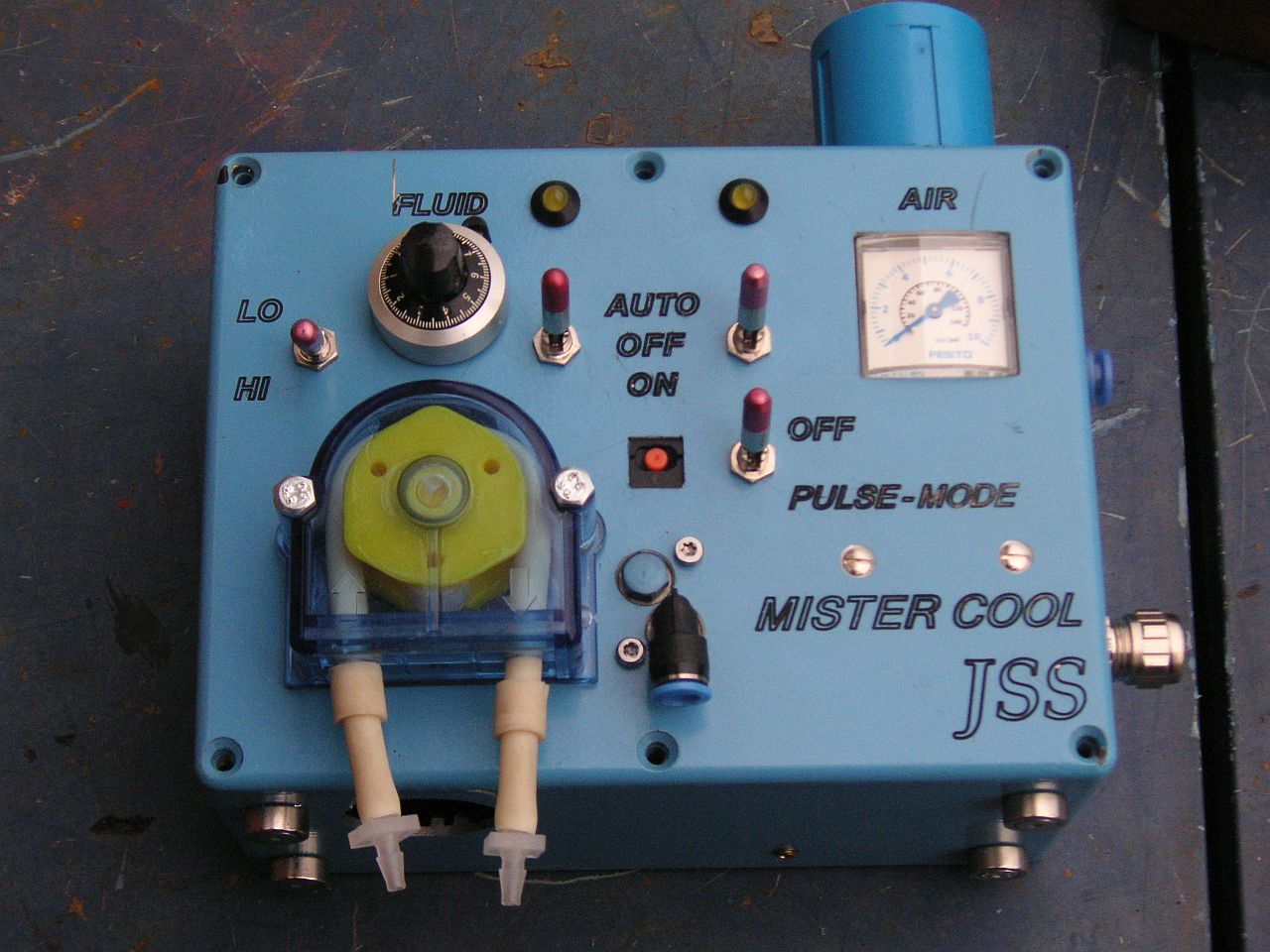

    It's all completed and connected up, right this minute it's lubing, with just enough air to clear chips from the cut, a job cutting parts from 2mm D2 Tool Steel plate with a 2mm 4 flute EM, seems to work nicely :D

Name:	Mister cool-1.jpg

    I'll let you know about Oil and the Silicone Tube.
    On oil introduction, the oil is introduced into a sleeve concentric around the air tube, the oil sleeve is shorter than the air tube and it's position can be adjusted to tune oil delivery but essentially the oil is always introduced after the air leaves the nozzle.
