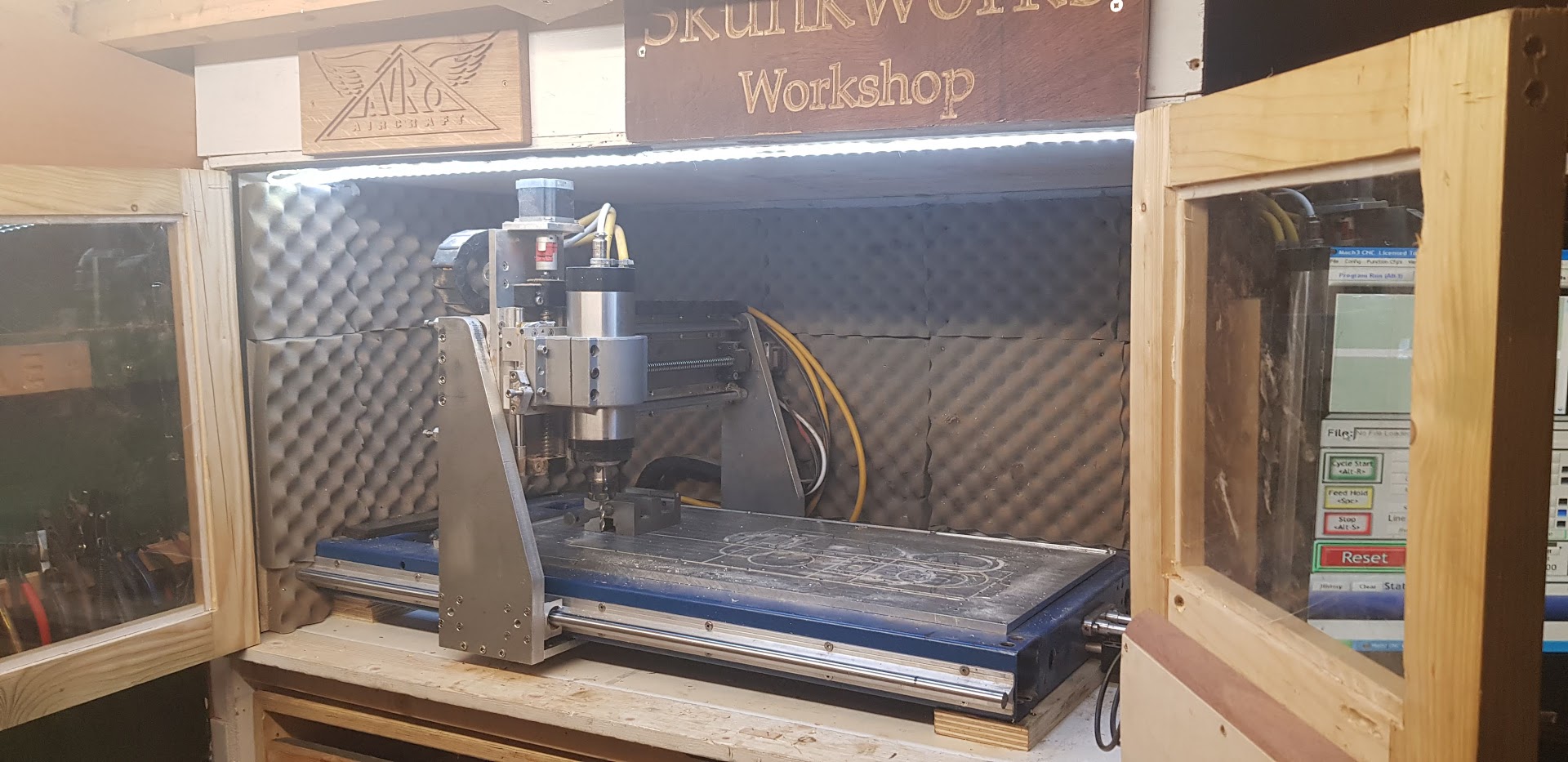

    Quote Originally Posted by RobC View Post
    Holding 0.01mm most of the time, often can be on the measurement I wanted. But my machine is far from perfect, I've had to do a lot of tramming and shimming to achieve such, I built my machine using a drill press and a myford lathe which too isn't perfect. The goal is, if you can't make it perfect, make it adjustable!
    This is my first build from no knowledge at all to being able to run it without a single problem which has taken me a few years.
    Attachment 28302
    Machining within 0.01mm (10 microns) sounds a little optimistic with those slideways and what about ballscrew accuracy and vibration?

    As I said, the bottom line is actually putting a piece of steel etc on the machine and cutting the damned thing. A proper test piece will exercise the machine in all axes, with internal and external surfaces, circular and flat features etc.
    Effects like backlash and machine flex happen when cutting real parts rather than on unloaded machines cutting air. Measure how the test piece compares against the model including circularity, flatness, perpendicularity, dimensional accuracy etc. It would be interesting to hear how the lunchtime legends got on....
    Attachment 28302
    Another one who's in La La land with Hanermo.! . . . Thou unlike him you have at least shown us your machine with its nice cheap Chinese round rails which tell us everything. If you are getting those readings then Suggest you get new measuring devices.

    People just need to get real and keep the BS in their own little fantasy land. It's like Muzzer said the difference between moving around in fresh air and pushing through a material is light years different and most of those quoting micron tolerances have a machine which couldn't hold the claimed tolerances if pushing through butter..
