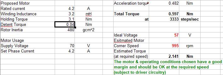

    Hello All, I'm back again and still haven't finished my machine! Anyway, I'm just looking to purchase the steppers and came across these:-
    https://www.ebay.co.uk/itm/Dual-Shaf...QAAOSwHu5b5ADz
    They look almost identical spec to the 3.1Nm ones currently on CNC4You that I saw recommended elsewhere, well all apart from the Voltage?
    https://www.cnc4you.co.uk/Stepper-Mo...YGH301B-Nema23
    It says voltage of 24-48 volts in the spec but my Toroidal power supply should be around 70v when I actually assemble it. Are they a different motor and therefore not suitable?

    Going by the key spec (current and inductance), they are pretty much identical motors.
    However I'd say 70V is too high. The recommended max voltage is 32 * SQRT(L) (L is inductance), which puts the recommended max voltage around 57VDC when running with parallel/unipolar wiring.
    A higher voltage won't have much effect at lower speeds, however if you're running at higher speeds, overheating is likely to become an issue if running at the rated current.

    It's worth doing the sums and working out exactly what voltage you need - for some motors 50V would be fine, for others a big hindrance. Thankfully, @Irving2008 has put it all into a handy-dandy spreadsheet which ties together all the variables (apart from using pulleys/gears with a non 1:1 ratio) for which he deserves a beer - go looky here:
    http://www.mycncuk.com/threads/1524-...tor+calculator
    This is part of my problem...the spreadsheet says the motor has a good margin but will it be ok on a 70v power supply?? Click image for larger version.

    Clive, Are you saying the 57v rated Steppers will be fine with the 68V PSU and either of those drivers? I am sure this is what people have used in the past but m_c says the voltage is too high! I'm a little confused now.
    I have always used 68 V with no troubles, everybody has their own opinion so you have to make your own mind up.
    I saw those drives but was a little unsure....have many people used them? It doesn't look like it has stall detection although I do understand that if the motor has stalled the job will be wrong even with stall detect.
    I found them about 2 years ago and have used about 8 of them Dean (Jazzcnc) I think has used more than 12. re the stall detect you are correct they don't have it. But the AM882 and EM806 does have it but if I remember correctly it only kicks in at about 300 rpm.
    As m_c has stated go with a parallel setup.
