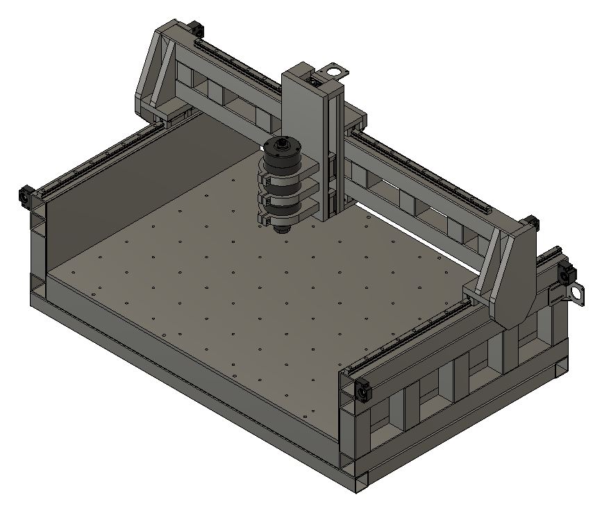

    Hi everyone,
    First let me thank all the posters on this site for giving me ideas and inspiration to try and design and soon build a working CNC router. Special thanks to Neale and his AVOR build /Clive S for his help and offer to assist me ( hope to visit you in future ) / routercnc for his build videos, gave me help with planning with epoxy.

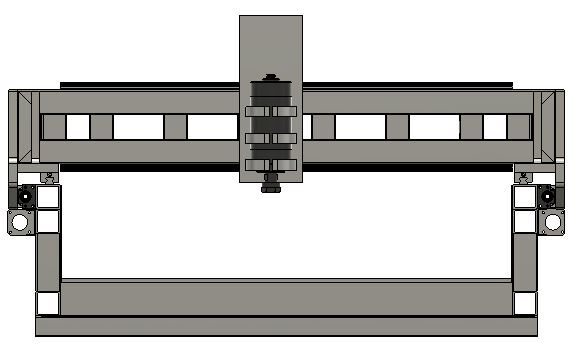

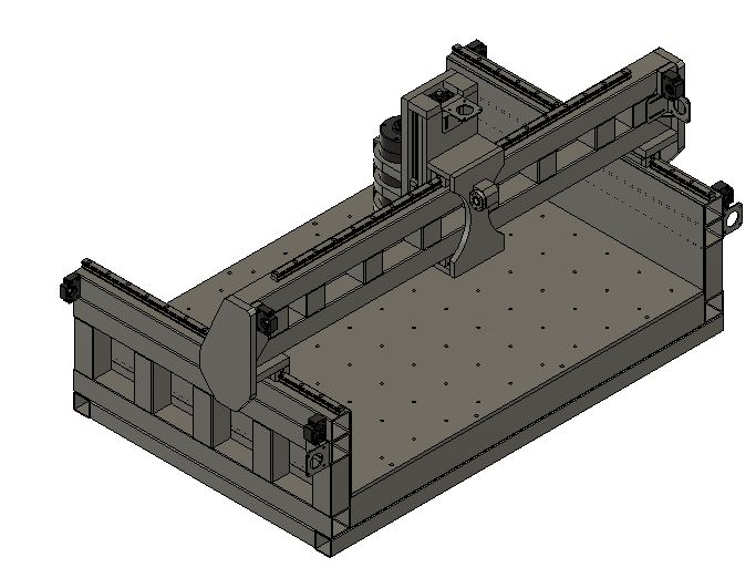

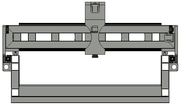

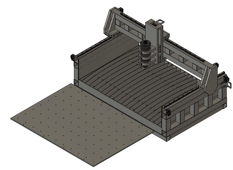

    I wanted to try something a little different by making a removable aluminium bed so it could be used as a plasma cutter - hence project Medusa. Its 2 things rolled into 1.
    Anyways here are a couple of CAD drawings so I could get some pointers and feedback on areas I could improve or change. It is not finished as I have to design bolting holes / plasma holder etc.
    The main body is 60x60x4mm steel welded - the end plates are 20mm Aluminium and the Z axis is a mixture of 20mm and 15mm aluminium. - sorry the ball screws are not on the picture - my computer slows down to a halt if I show them -
    I will update this post as it progresses.

    UPDATE..11.11.18 cost and quality are important.
    Ok here is my list of electrical / mechanical parts I have in my planning stage so far.
    1) BALLSCREWS ...1610 or 2010 x and y axis / 2005 or 1605 on the z.
    2) LINEAR RAIL... usual aliexpress ones.
    3) MOTORS...4x Nema 23 3nm
    4) DRIVERS...4x Am882 or Em806 or anything better ?
    5) MOTION BOARD...1x Csmio ip/m ? ( is there anything better as I have 2x motors on X and is there a problem with auto homing ?? Sorry I am new to all this.
    6) BREAKOUT BOARD.. Not sure... depends on motion board ???
    7) PSU... I have no idea re this at all and dont fully know the parts in the 68v build video. Can I buy 24v and 68v supply and what amp and watt do I need ?
    8) SOFTWARE... I have acess to Mach 3 / 4 and Aspire Vcarve also.
    9) SPINDLE... 3kw water cooled and VFD.
    Many thanks again and take care.
    Mike
    Please can I have any constructive feedback on my design and items selected, everything is just in the planning phase still.
