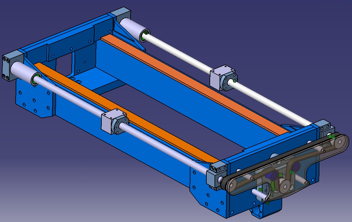

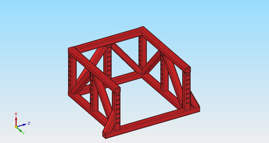

    I was starting from Jonathan and Routercnc designs. Then I tried to find ways to add damping and gantry stiffness without adding a lot of weight.
    The easiest and fastest design to build is Jonathan's frame with Routercnc's gantry , all welded RHS steel and epoxy levelled. But those RHS left empty look so... 'not professional'. The stiffness isn't great and they ring like a bell.
    For the frame, filling it with sand (after moving/assembling) looks like a good idea.
    The gantry needs to remain lightweight. What could be used to fill the RHS to add damping, stiffness without adding to much weight?
