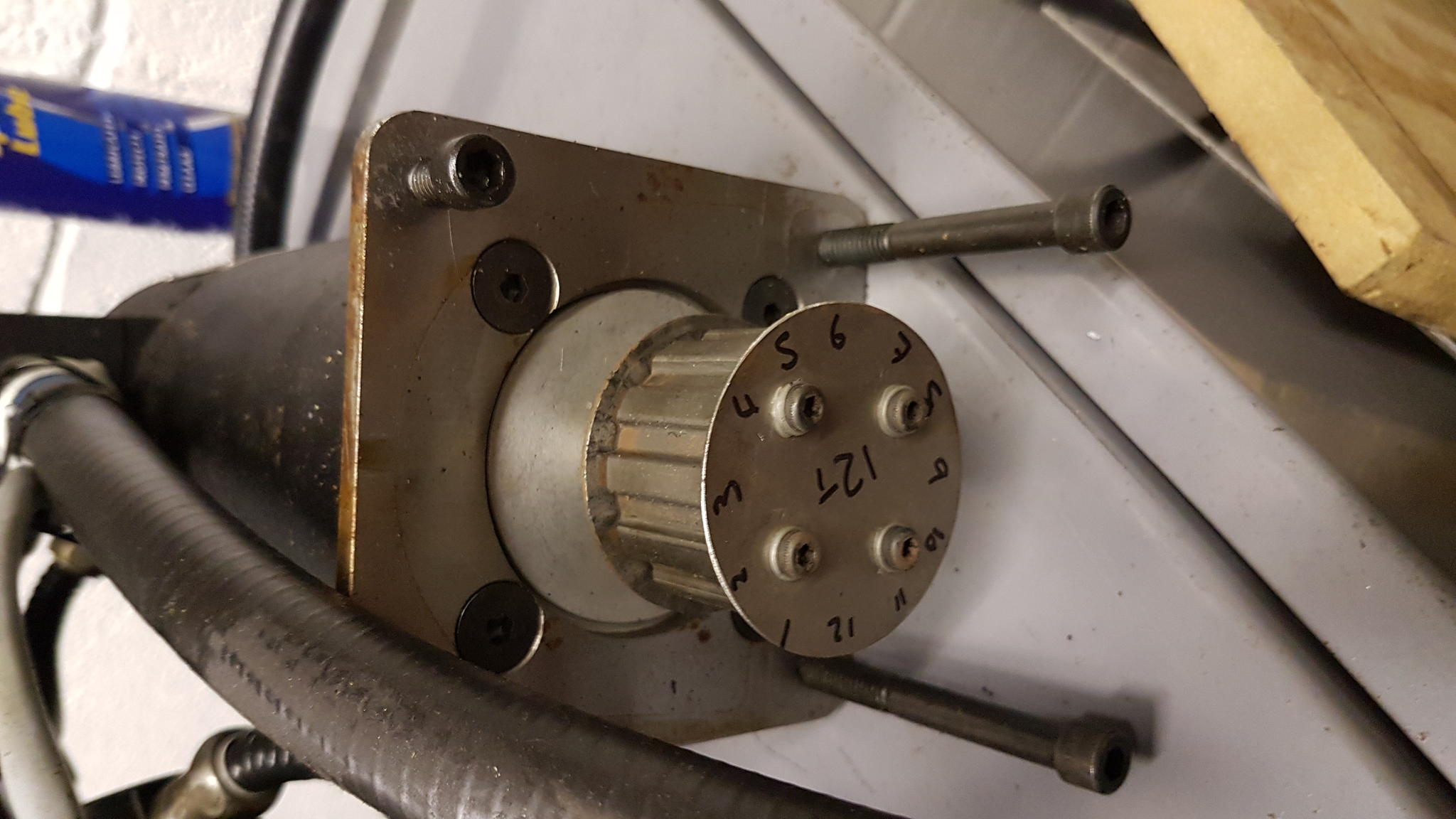

    Had 2 different thoughts on pulleys. ( but that's all they are right now.)
    A) Make a shaft extension piece and stick original gear on the
    end. ( quick & simple, but depends on length)
    B) Make a new gear with an extended boss.
    ( seems a more engineered solution, but more expensive
    and a lot more time to machine from solid. Also I would
    have to make a single tooth form tool. Fortunately I already
    have a H/V rotary table with dividing plates)
    Sickeningly, this would be a great job for the 4/5 axis machine that I hope to end up with ,but isn't that always the way!

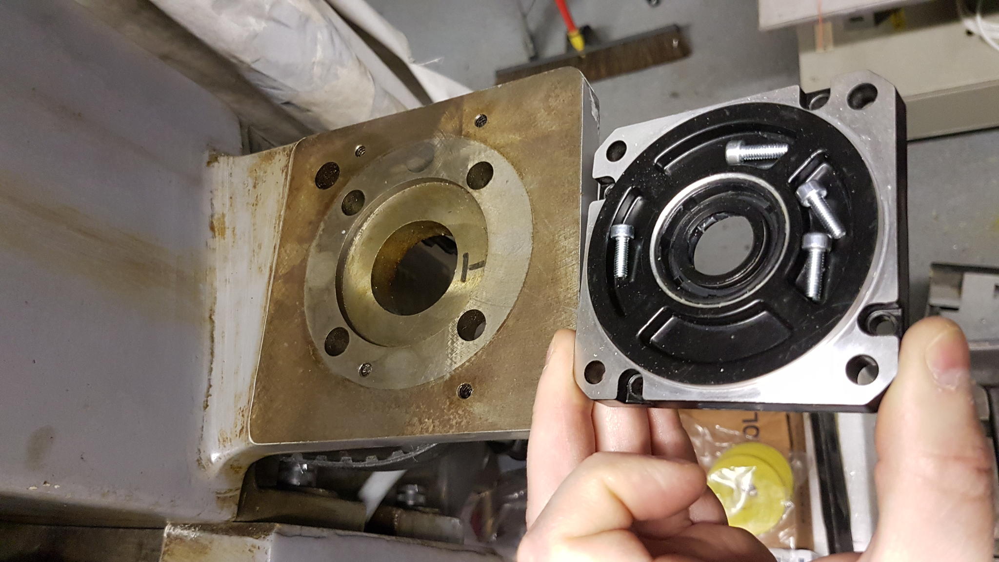

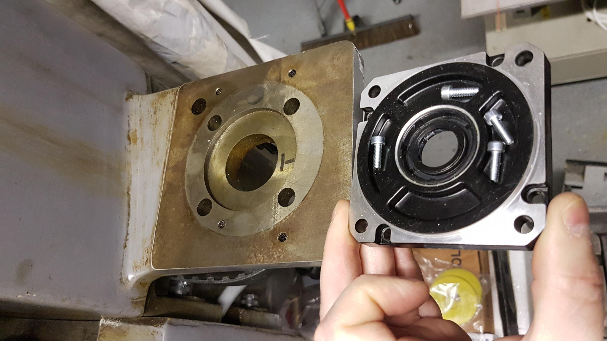

    Re mounting, my servo motors have a stupid raised boss on the front face. Going to turns this off in the lathe.
    X & Y axis should be OK with a flat face.
    Z AXIS mounting plate is part of main head casting and has a circular pocket machined in to accept the old SEM motor. ( no way I am stripping that lot off to mess with. Thinking of just making an exact size disk to drop into pocket to level out the surface. Then bolt motor straight on.
    The bolt pattern on new motors is a little larger, so just thought of rotation the bodies 45°, marking and drilling a new PCD to suit.

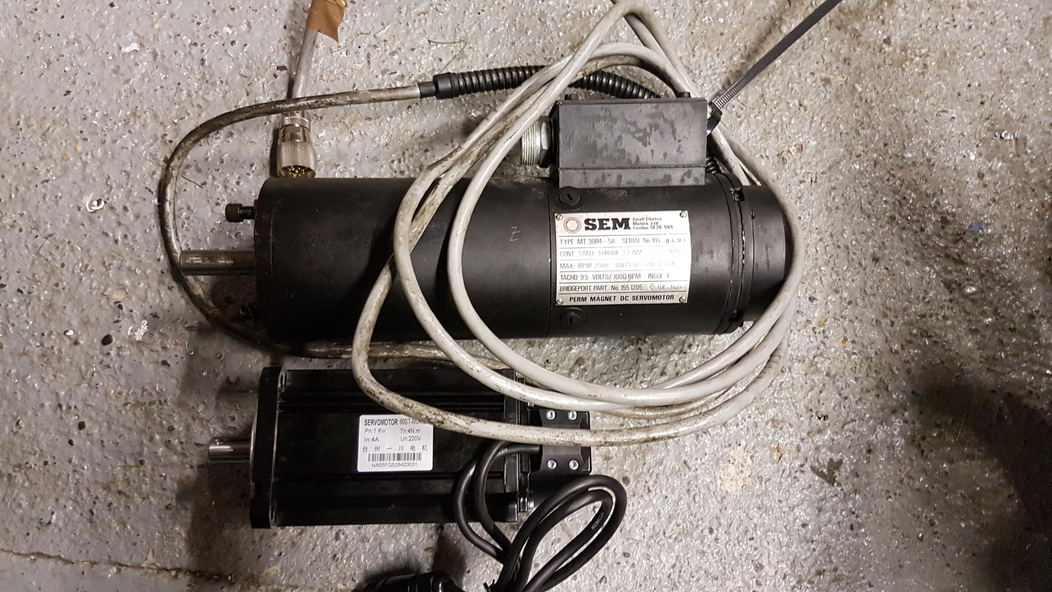

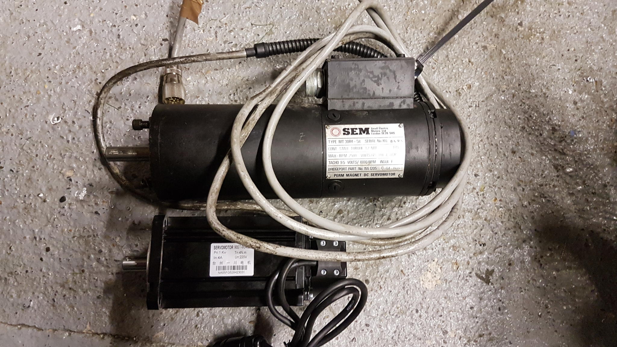

    Old DC SEM motor Top 2500rpm & 3.4NM torque
    and new AC Servo bellow it = 4.0NM torque.
    Also note difference in shaft length.

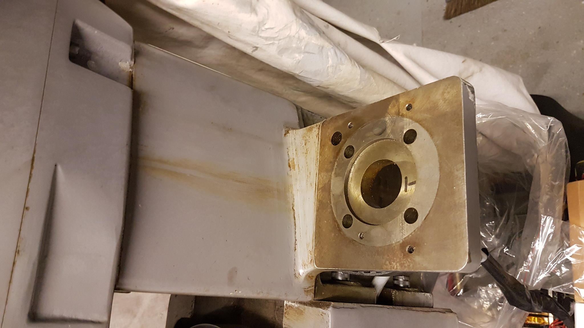

    Z axis mounting bracket part of head casting
    compared to motor front plate (note raised centre boss).

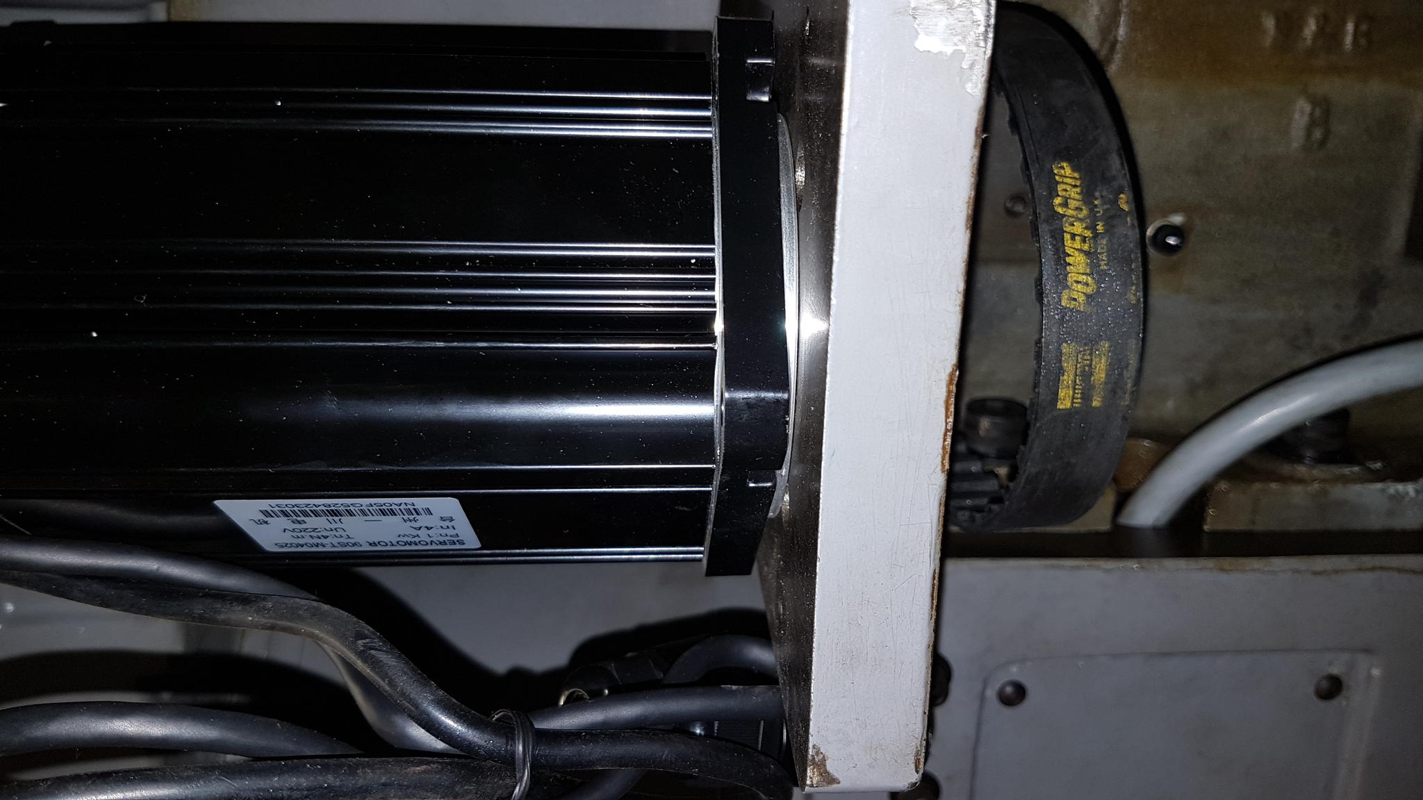

    AC servo in place, showing boss interfering with fit.

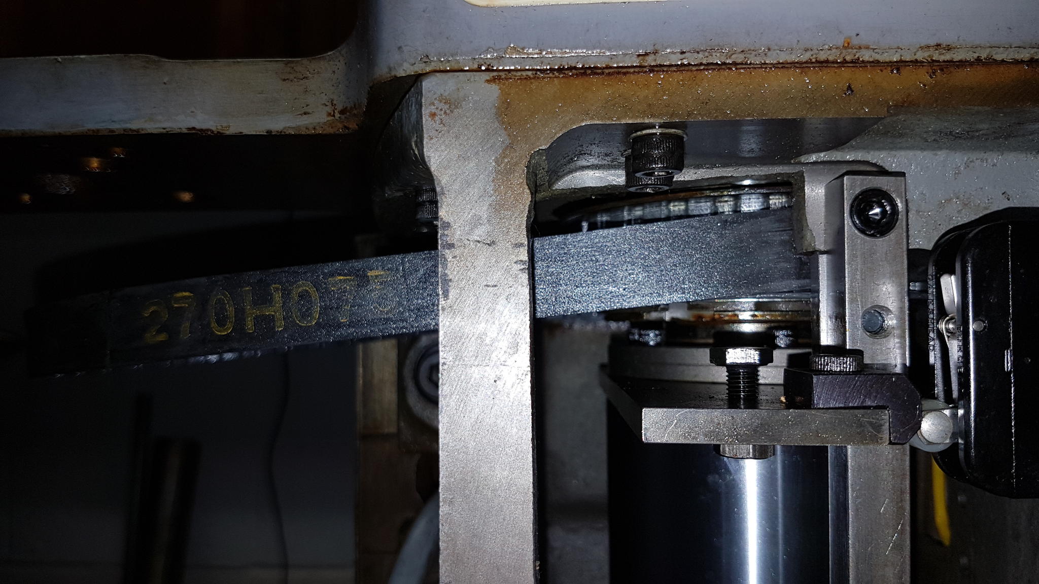

    Z axis pulley, above spindle ( looks a pig to change out)
    original pulley as fitted to SEM motors.

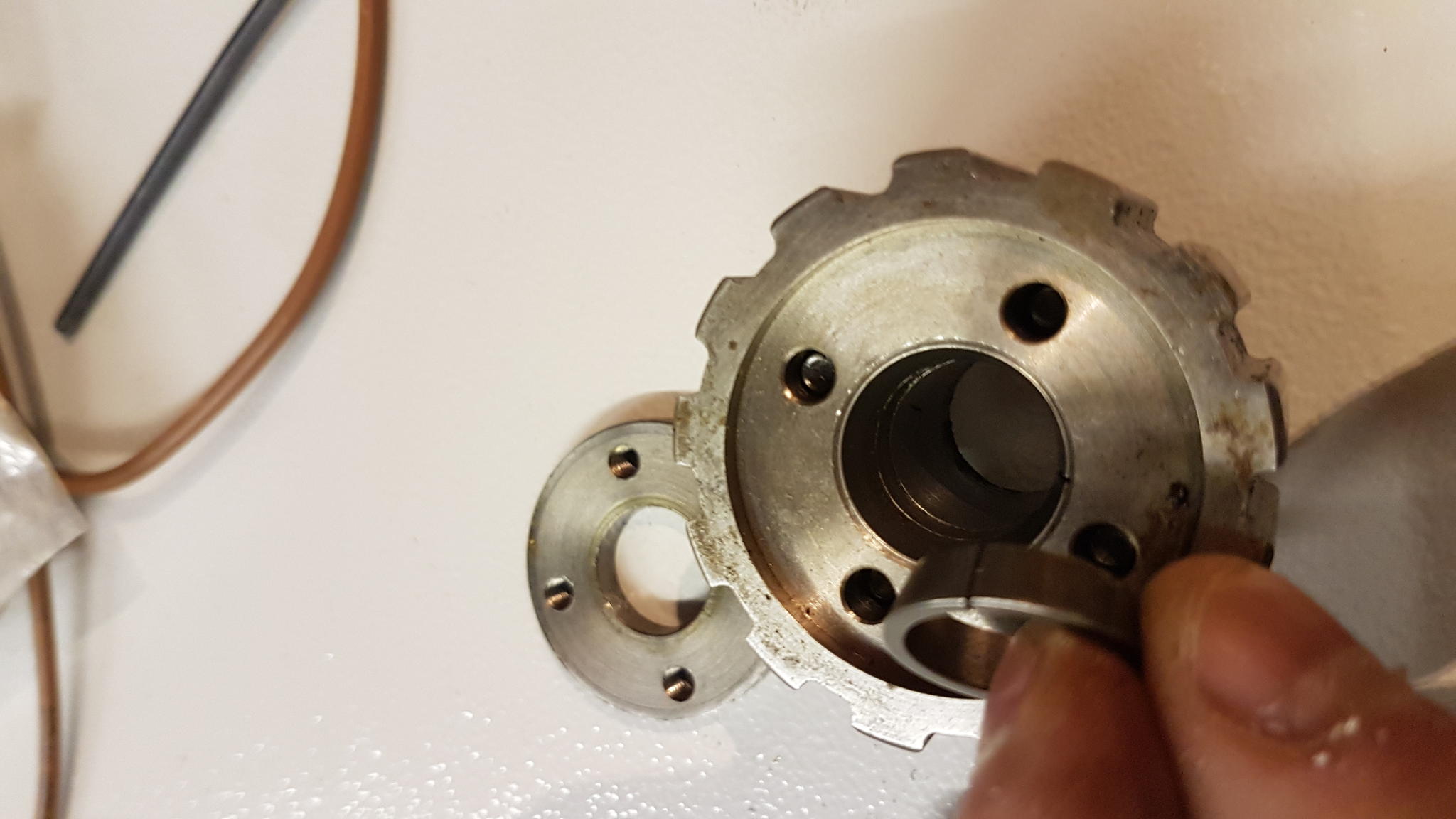

    pulley disassembled.

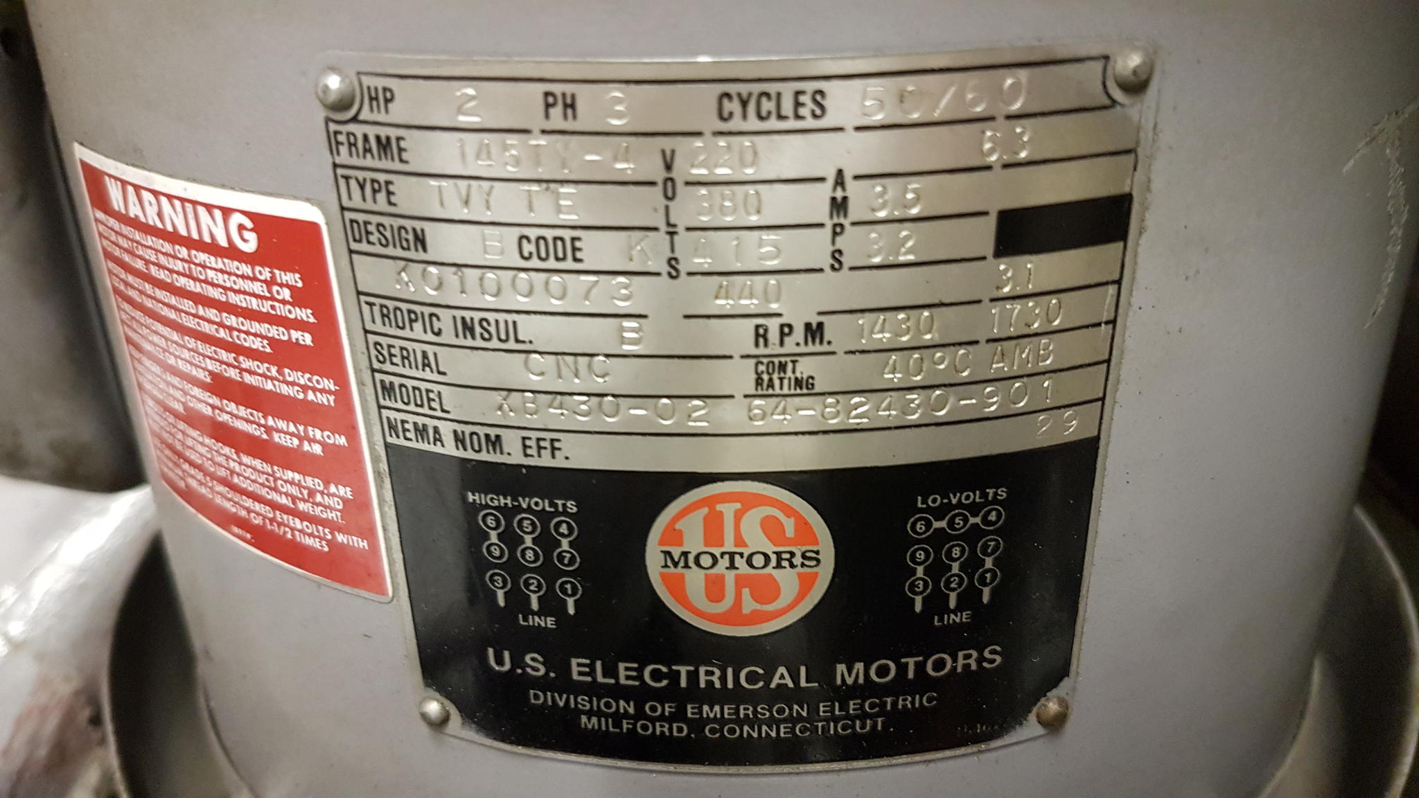

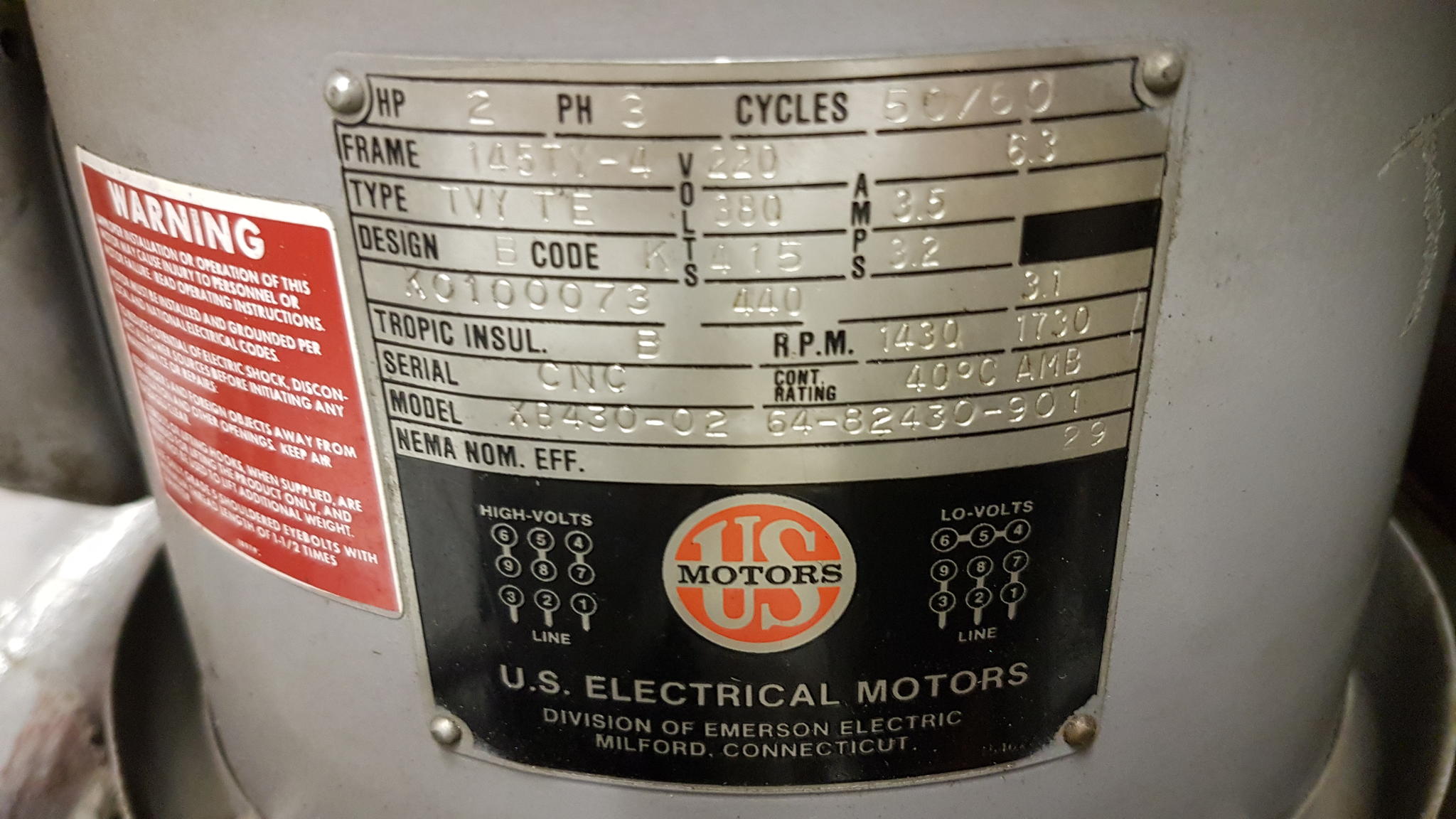

    Spindle motor. although it shows Star / Delta link positions, there is no terminal block inside housing.

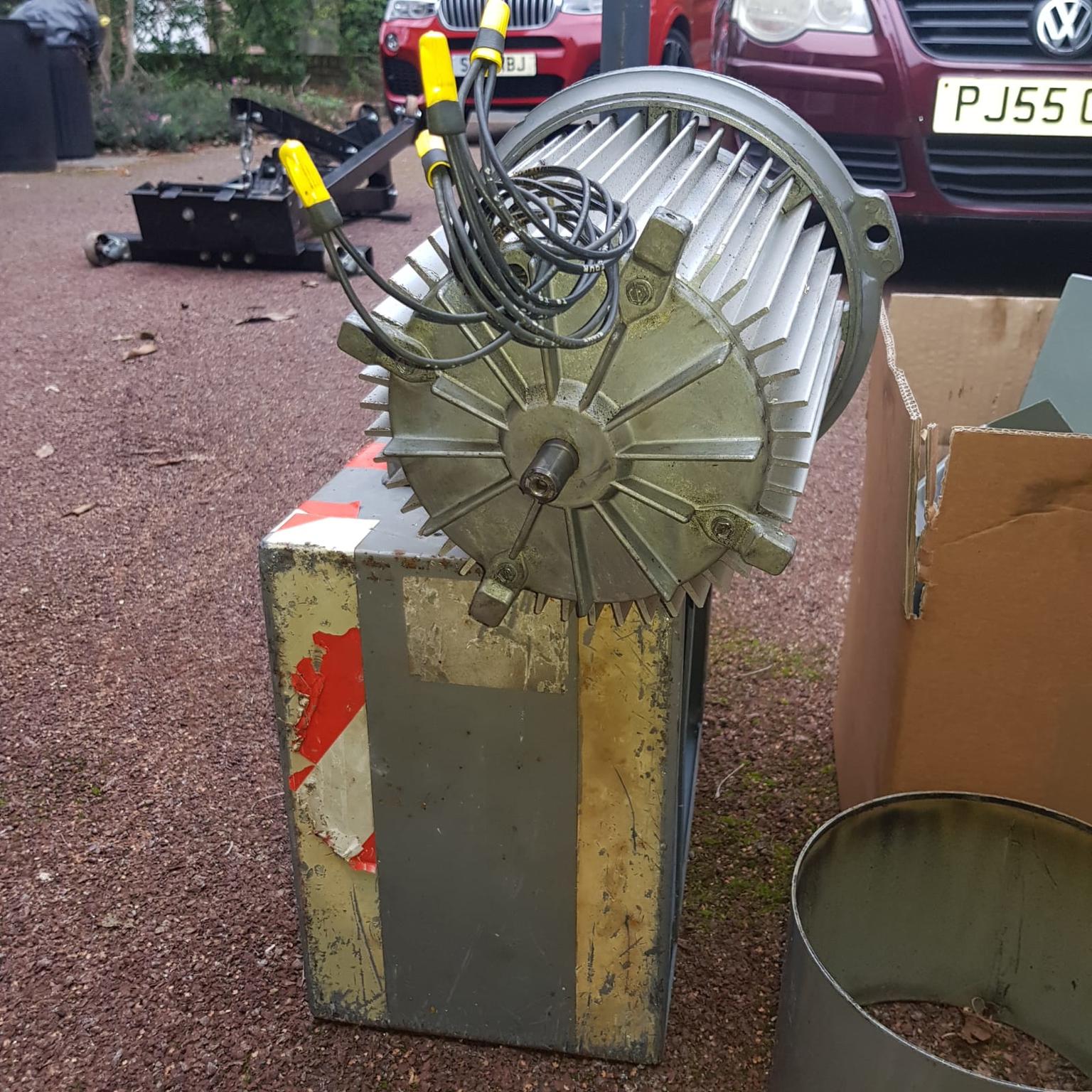

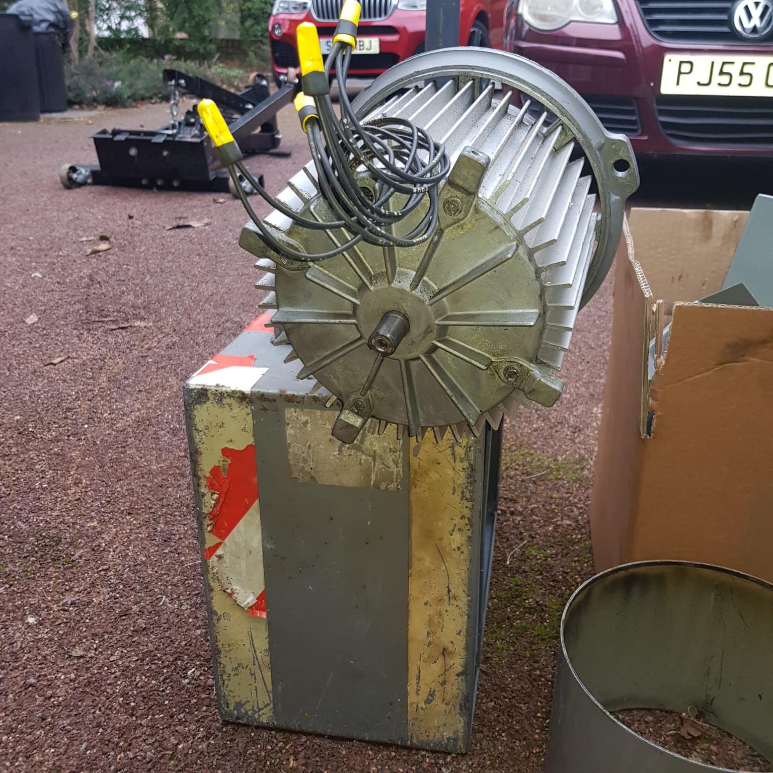

    My motor has wires that allow for different options, but this is with the outer metal shield removed, will take pics this weekend.

  9. #19
    Chaz's Avatar
Name:	WhatsApp Image 2019-01-05 at 17.38.45.jpg
    Pic with the motor's outer cover removed. You can see the wires coming out allow for change in connection.
