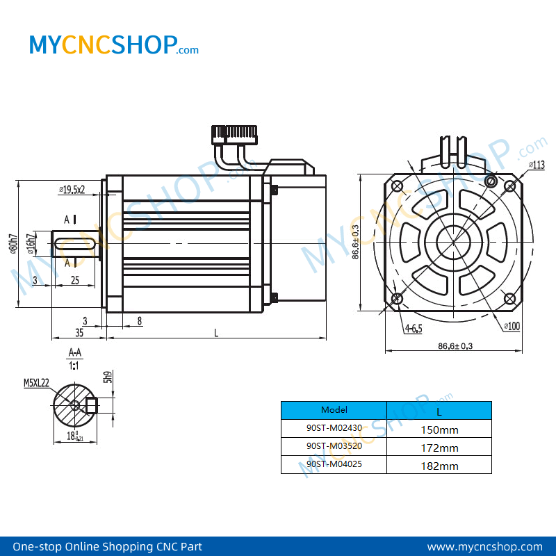

    I have just ordered 3 AC sevo kits. (90ST-M04025 servo & drive kit)
    220V A.C.
    2500 rpm
    4NM torque ( originals were 3.2)
    Same shaft dia as originals
    Motor body is a similar diameter and (shorter too), so they looked to be the ideal retro fit.
    220V A.C.
    2500 rpm
    Its a bit late, but opinions invited on this purchase.

    Almost. Except I got the 90ST-M04025 model, which is 4NM and 2500 rpm.
