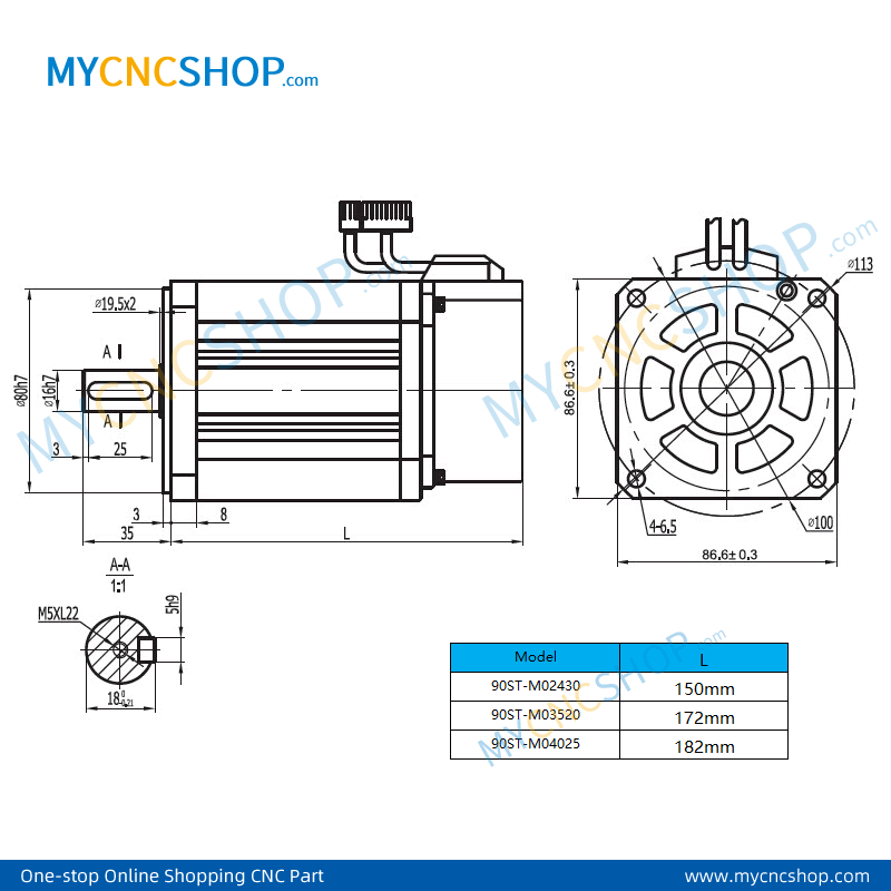

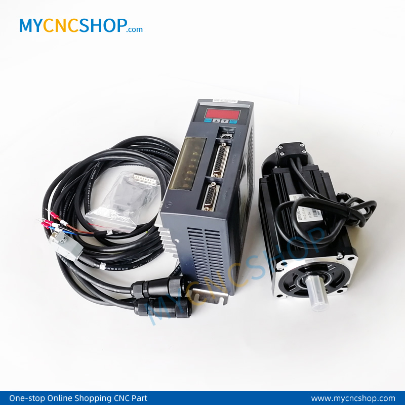

  8. #28
    Quote Originally Posted by mycncshop.com View Post
    Friends, if you need a new servo,please let me knowI will apply for some extra offers for you
    In this link, can see all machines with 80mm flange and 90mm flange
    Attachment 31954
    https://www.mycncshop.com/80mm-90mm-....m-3.5N.m-4M.m
    Do you do anything with longer shaft? Ideally it would need to be 55 - 60mm long
  9. #29
    Hi, really glad to find this thread as I'm currently planning to swap out the motors on my non working Interact 1 series 2. I see the problem with the short shaft lenghts on these new Chinese servo motors. What route did you go? I was thinking of making shaft extensions something like this and re-using the 12t stock pulley but would the over hang be too much? Cheers Ross
Name:	Shaft extension Drawing v1.jpg
    Attached Files Attached Files
  10. #30
    Chaz's Avatar
    Hi. for X and Y I used Panasonics with standard shaft but its not great. For the Z, I used the next motor up (1KW Panasonic, overkill) for the additional shaft length.
    Suppose if you can get the shafts with a good tolerance and some grubs, it would be OK.
