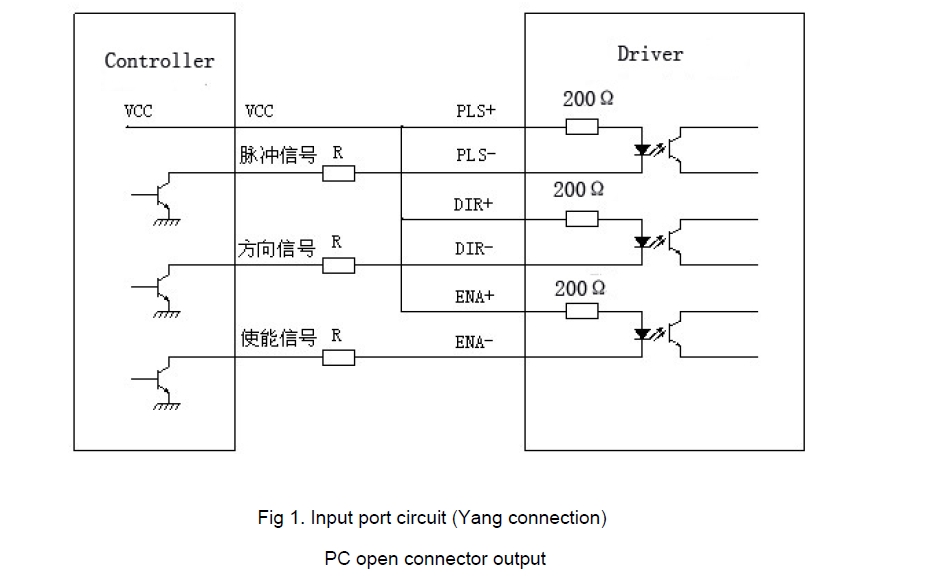

    with stepper drivers like the dm860a that has its own input opto-isolators
Name:	dm860a stepper driver input connections.jpg

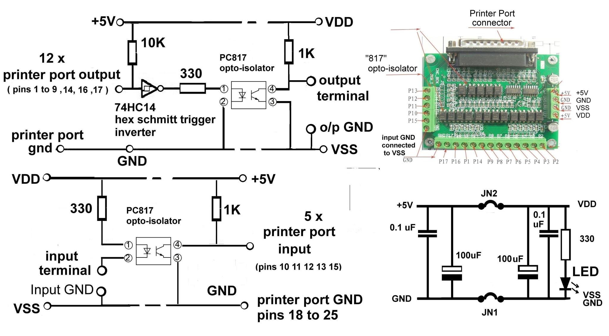

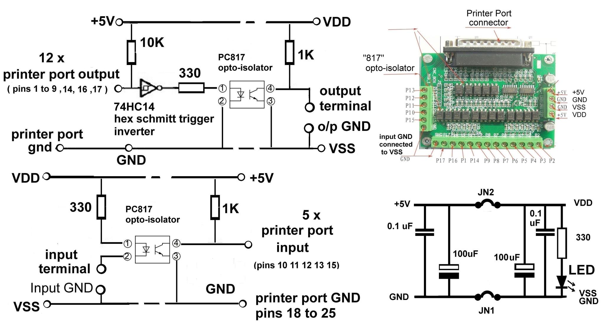

    you don't need a breakout board with output opto-isolators like this supplied in the kit-
Name:	ebay opto-isolated CNC BOB 2.jpg

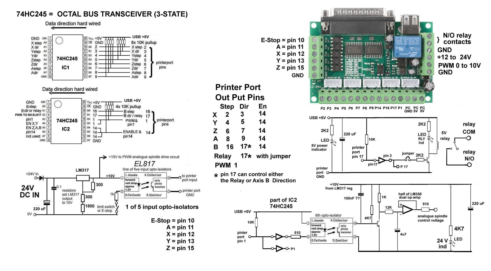

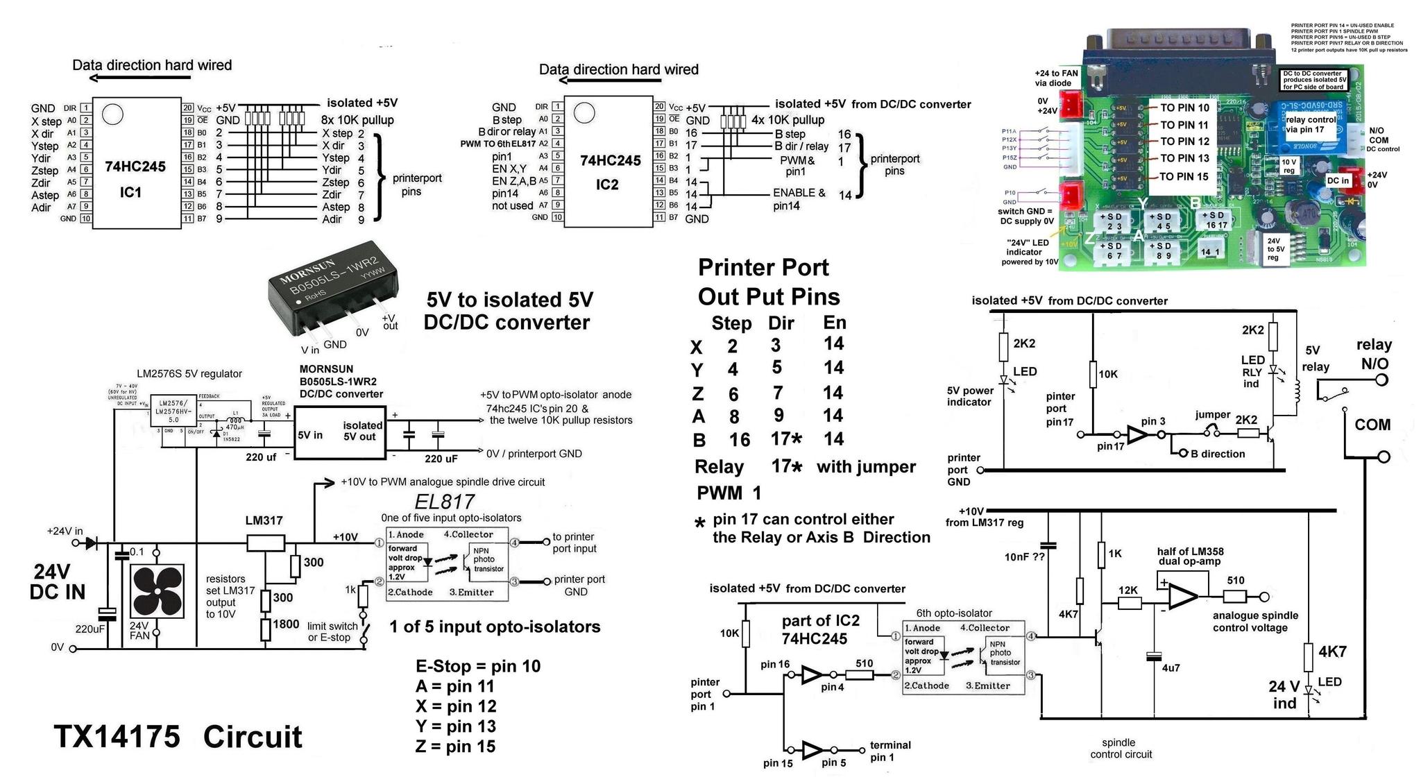

    these two BOB's only buffer the printer port outputs and only opto-isolate the 5 inputs -
    a breakout board like this found in some of the ready made control boxes
Name:	TX14175 circuit.jpg

    note it does not have the 5V DC/DC converter found on the TX14175 and requires another power supply
    the least expensive change will be the breakout board but it may not make any noticeable
    difference when using the original motors and drivers
    As I don't have the longs kit to test, I don't have a definitive answer but
    problems the original breakout board will only show up at high speeds
    the original motor / driver combination may limit the maximum motor speed first
    without going through all the stepper motors , stepper drivers and power supplies on sale
    its not easy to say which is the most cost effective change
    using a higher voltage supply & stepper drivers verses replacing the motors with lower inductance motors
    John

    It's worth highlighting the main reason opto-isolators are added to BOBs is for protection.
    Using a parallel port, get something wired wrong, or have something short and connect power to pins they can't withstand, then more than likely your PCs parallel port (and likely entire motherboard) will be dead.
    With newer motion controllers, the path of destruction from a wiring problem isn't likely to be as long, but it's still potentially a couple hundred pound controller that could be releasing it's magic smoke.
    It's a calculated risk not using them, but at slow speeds, they shouldn't cause any problems. I certainly wouldn't be searching out a BOB without them, unless I was really going to be pushing pulse rates.
