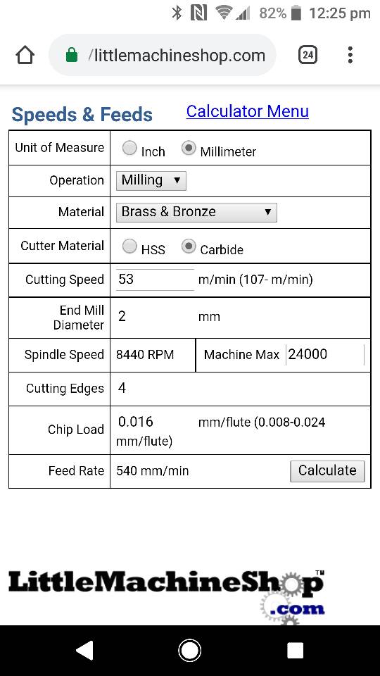

    Just had a new 2mm flat 4fl endmill delivered.
    Out of the box and broken in 3 minutes!

    What speeds and feed? What material?
    4 flute?
    4 flute?
    Exactly this Click image for larger version.

    I wouldnt be using 4 flute for brass / alu. 3 at most, 2 is better. Did it snap on first engagement or did it cut for a bit?

    It got this far but very aggressive. I suppose I should have dragged the feed slider down. But a calculator should be accurate no?

    From the pic, it looks like you plunged directly into the stock or did it do a helix down? If you plunged then that would be an issue, not the best way to engage a cutter into material. When I cut at new speeds I turn the feed down to 10% and then ramp up once I have done the helix down and then started to make the cuts I expect. Sound / vibration / noise is key.

    It's actually a helix entry.

    Material looks a bit gummy. Did it clog up the bit? Id say 4 flute is to blame here (IMHO / 2p).

    Honestly I started with 4fl when I got the machine, this was done with 4fl 2mm a while ago. But without using the calc

    To me (and the pics arent very clear) it looks like the tool lacked lubrication and/or ability to clear material fast enough. A 2 flute is more forgiving.
