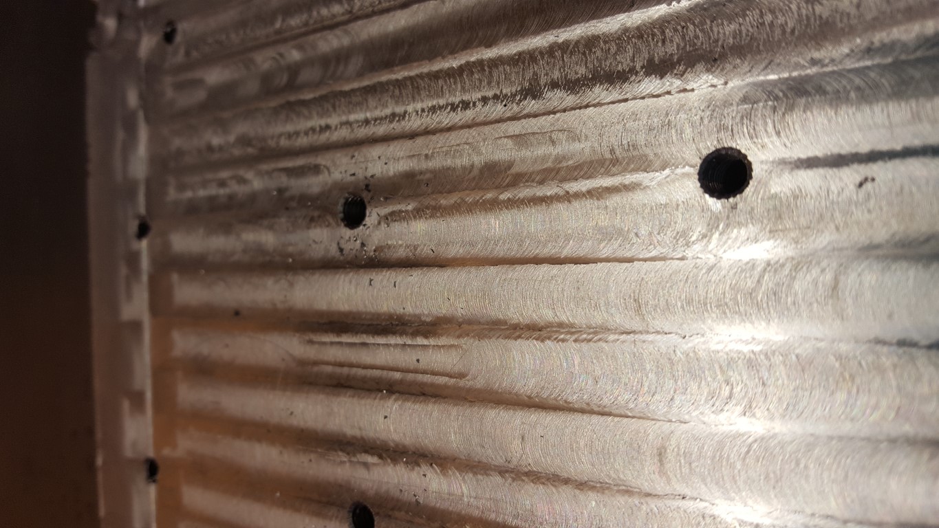

    I just tried 20k rpm. VFD says 326hz and spindle was going at 19600rpm.
    This is what the bed looks like and what the finish was initially and after the tool degraded.

  10. #50
    Lives in East Lothian, United Kingdom. Last Activity: 18 Hours Ago Forum Superstar, has done so much to help others, they deserve a medal. Has a total post count of 2,991. Received thanks 375 times, giving thanks to others 9 times.
    If you've only been taking a light surface cut, then the wear on that cutter would be as expected, especially if chip clearance has been poor along with no lubrication.
    If chips start getting re-cut (I.e. not cleared from the cutter), then in soft materials they will start welding to the cutter. As soon as that happens, your nice sharp edge is now covered by a blunt layer of material, and the problem will compound from there as heat builds up at an ever increasing rate, until something finally fails.
    I never realised you were machining aluminium with that cutter (I'd assumed you were still working with brass), but in aluminium you want polished cutters so there is as little roughness as possible on the cutter to avoid chips sticking (coated cutters are often rougher, but in aluminium coatings make little difference, which is why uncoated polished is usually preferred). You also want a bit lubrication to help stop things sticking. Lubrication can vary from an occasional spray of WD40, to mist, to full flood coolant.
    On something like that bed surfacing job, a light spray of WD40 across the part at the start along with just enough air to clear chips would be more than ample to keep things running smoothly.
