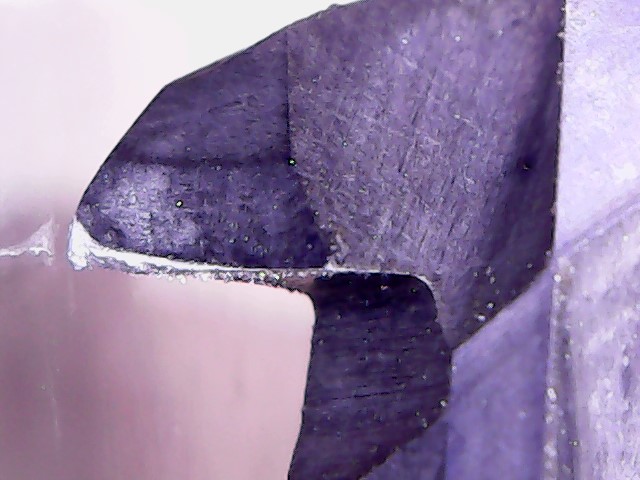

    So anyone any ideas why that carbide endmill is showing so much wear?
    Feeds and speeds were not a million miles away from G-Wizard.
    I am surprised how ali can erode carbide so easily!

    We havent ruled out that you are using cheap / crap endmills. Try with something semi decent first (https://www.shop-apt.co.uk/) would be the supplier for me for something 'OK'. Id select a 2 flute uncoated endmill to start with. Plus, as Mr Ward suggests, the material might be the problem. Dont focus on the blunt endmill.

    Is that end mill coated? Looks like it might have tialn coating, which will cause build up pretty quickly, that's probably not erosion but almost certainly a build up of aluminium on the cutting edge. You want uncoated cutters really for ali. And yes find out what the material is, even different batches of the same grade can cut differently but stuff like 1 series ali is horrible for machining.

    OK, I'll get a 2 flute uncoated from APT and see how it goes. The cutters I have are coated but I don't know what with.

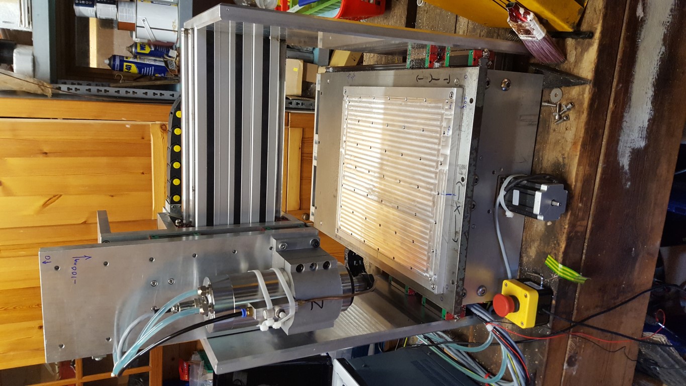

    The part I was machining is the bed of the machine, so no idea what grade it is. I just wanted it flat(er) and level.

    Just for my own interest, if there is build up on the tips of the cutter, how does that erode the tip?

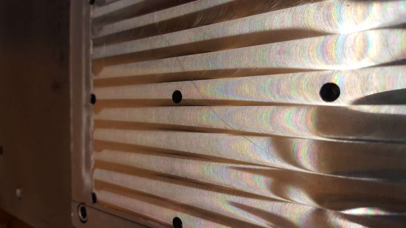

    This is what the bed looks like and what the finish was initially and after the tool degraded.

    Noooo. Don't cut the bed.
    Get a board, sheet of ali, whatever you want to use and stick it on top. The bed is made of several independent pieces of extrusion and even if you machine it 'flat' they will flex independently anyway. Also you're then tied in to the cutting area, you can't really load a bigger piece in and clamp it outside the work area.
