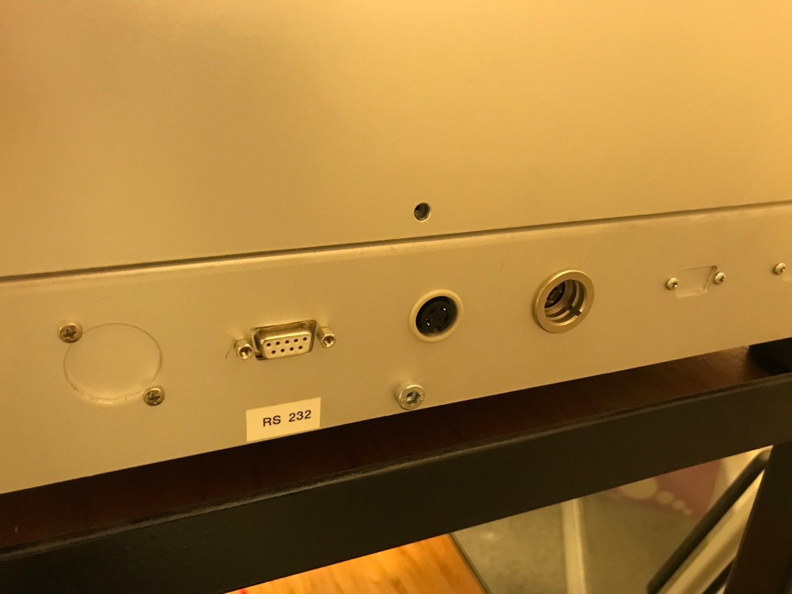

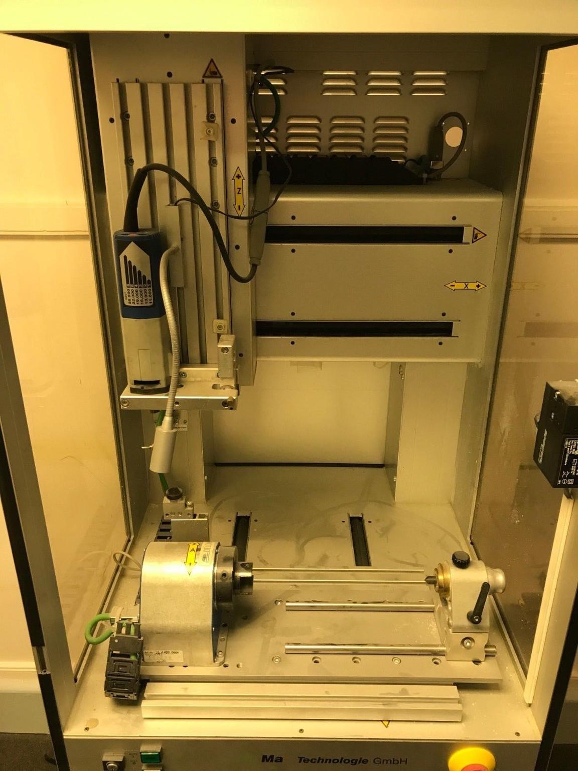

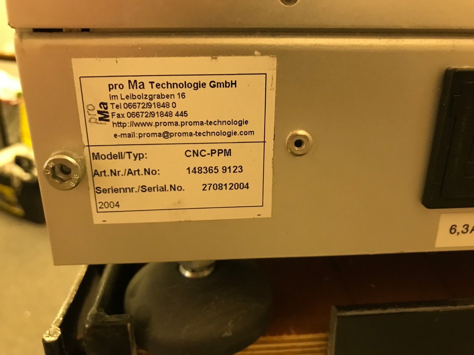

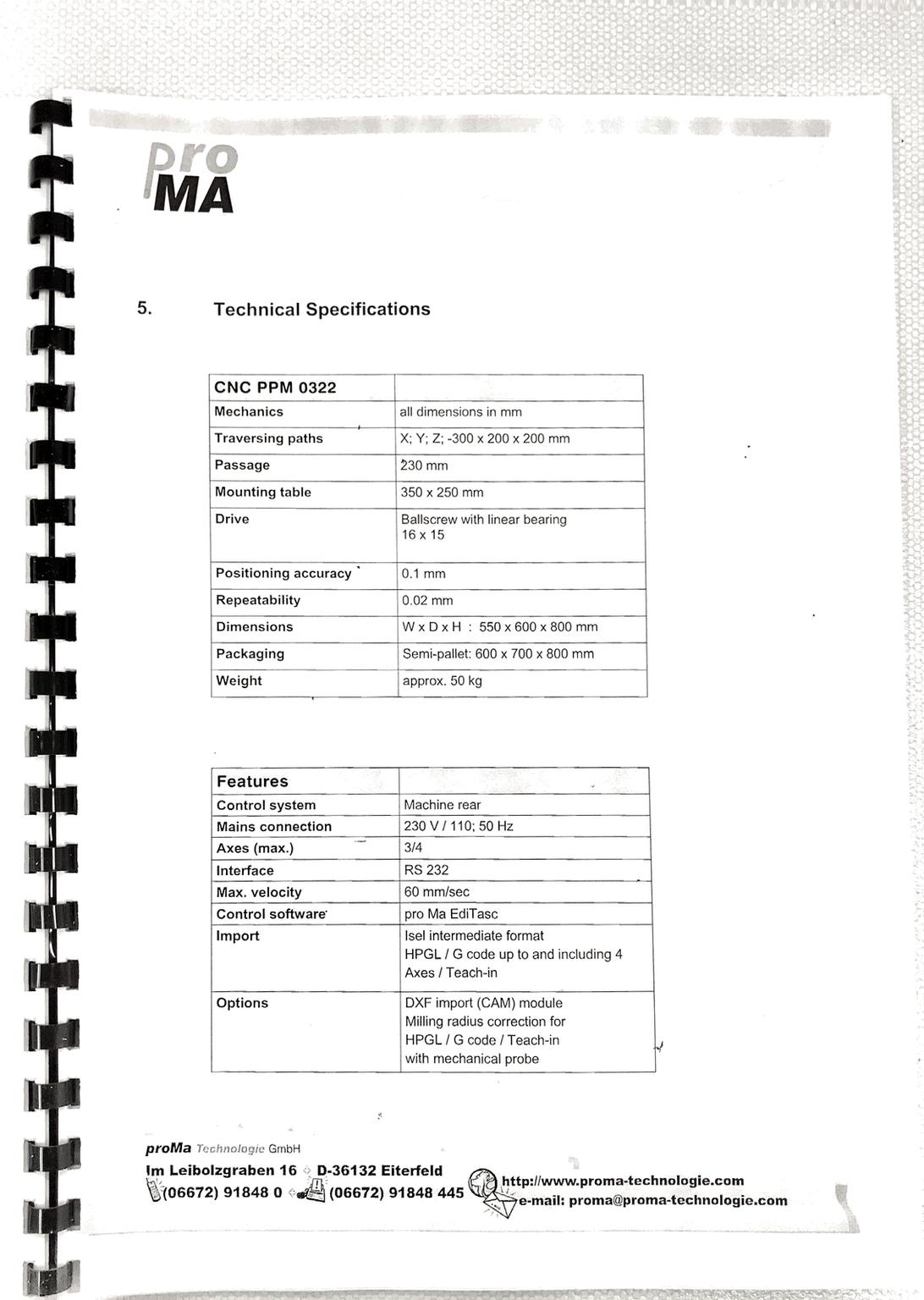

    Completely new to this.... Does anybody have knowledge of these ... what is their controllerboard/driver set up and what software would operate it ... Would also like directions on good controllerboard/driver set up to get for 5 axis milling of metals and minerals in the event of refit project and what 5 axis part to get in the context of jewellery making. Thank you in advance

    hello, do you think you could email me the documentation from this machine?
