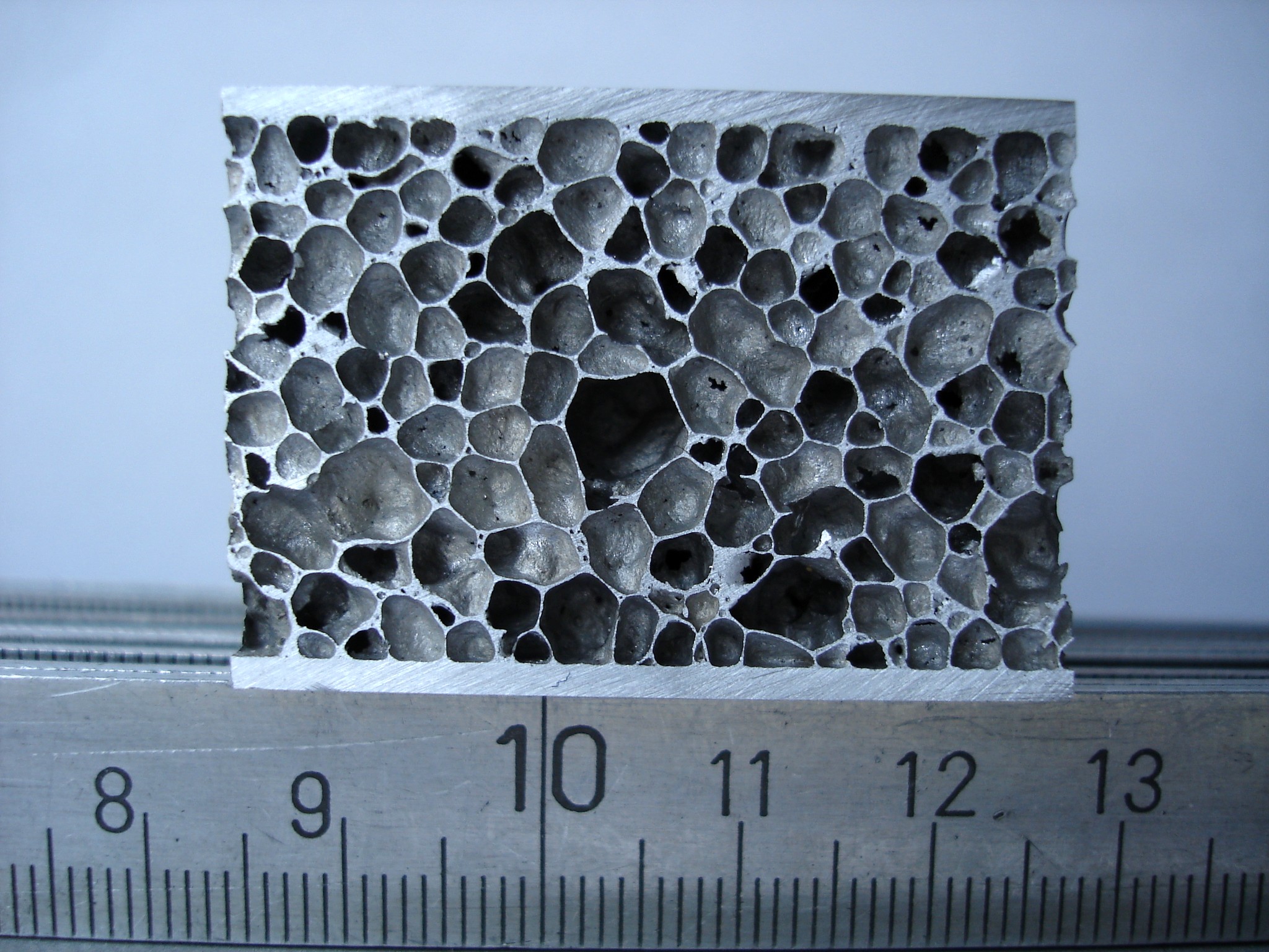

    The gantry needs to remain lightweight. What could be used to fill the RHS to add damping, stiffness without adding to much weight?
    This aluminium foam looks so sexy.. But how is it produced? How complicated/expensive? I couldn't find an answer yet.
    And here's an article about it: Vibration Damping Analysis of Lightweight Structures in Machine Tools
    Another idea is filling them with foam concrete.
    But in both cases the filler will shrink by cooling/curing and maybe detach from the steel walls.
    There are other damping techniques/materials but do we have access to them? http://www.aspe.net/publications/Ann...IS/BAMBERG.PDF

    Thank you all for your input!
    I'm intending to add a layer of foil-faced Tecsound damping sheet inside my gantry extrusion, I've found it very effective in the past on metal enclosures. I may also try some expanding polyurethane foam, either on it's own or in conjunction with the Tecsound: just need a bit of time to experiment!.
    Tecsound looks promising. Not sure how different could be compared with the ISODAMP C-1002 mentioned in the MIT paper. A friend is soundproofing cars for 'dB drag racing' with StP. Not sure how good it is at vibration damping but I'll test it.
    I don't think the PU foam has any damping characteristics. If you knock it the sound is very well propagated.
    The answer is easy, the implementation of it is not, you set up a factory to make the Aluminium Foam filled parts of your choice, it is not an "Aftermarket Filler" choice.
    I see a few books cited on wiki about ally foam manufacturing. I need to get my hands on one of these books.
