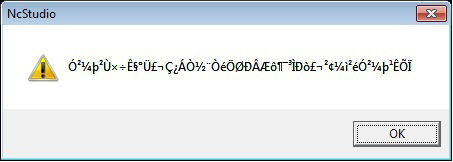

    Hoping someone can help me, I have a Chinese CNC machine running NCStudio. The old Windows Vista machine I used to operate the CNC has given up on me and is irreparable. I have a spare Windows 10 PC which I installed NCStudio on along with the supplied NCS PCI card. After installing NCS I keep getting the attached garbled error message??
    My thoughts are that NCS won't work on the Win 10 PC?

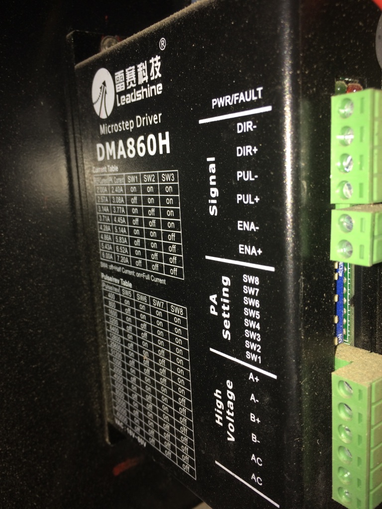

    Stepper Drive - I have 3x identical drives for X, Y & Z

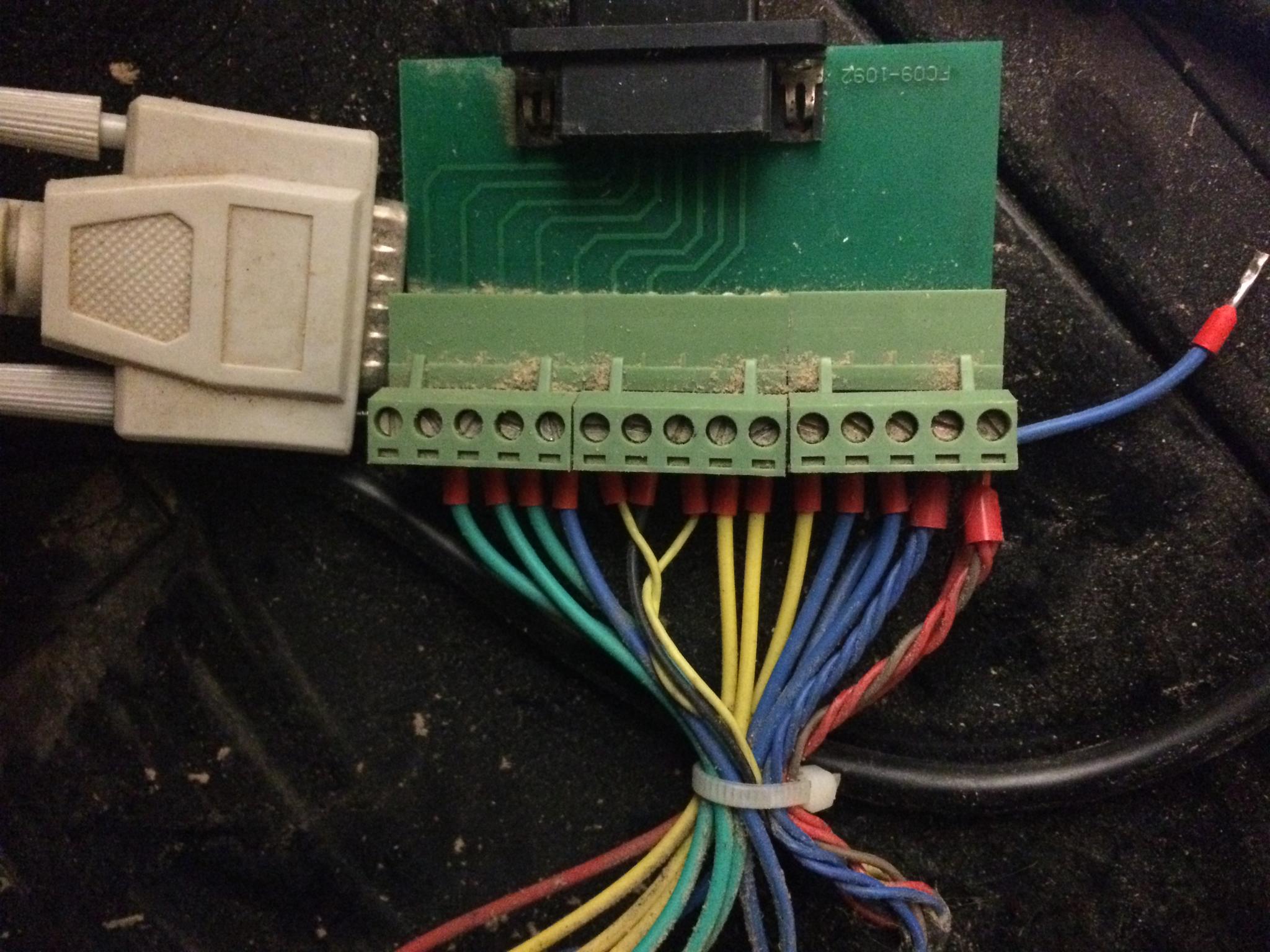

    Breakout Board - The only identification on this is FC09-1092

    I know this is for XP, but it might give you some idea what is happening. You probably won't get the drivers for the PCI card to work in Win10. I'll bet the drivers don't even exist for that card.

    I've just done a quick search, and everything I've seen points to drivers only being available for XP. However I have found an eBay listing that mentions it'll work with windows 7, and windows 7 drivers should work with 8 and 10, although if they've not been digitally signed, you may have to jump through a few hopes to get windows to accept them.

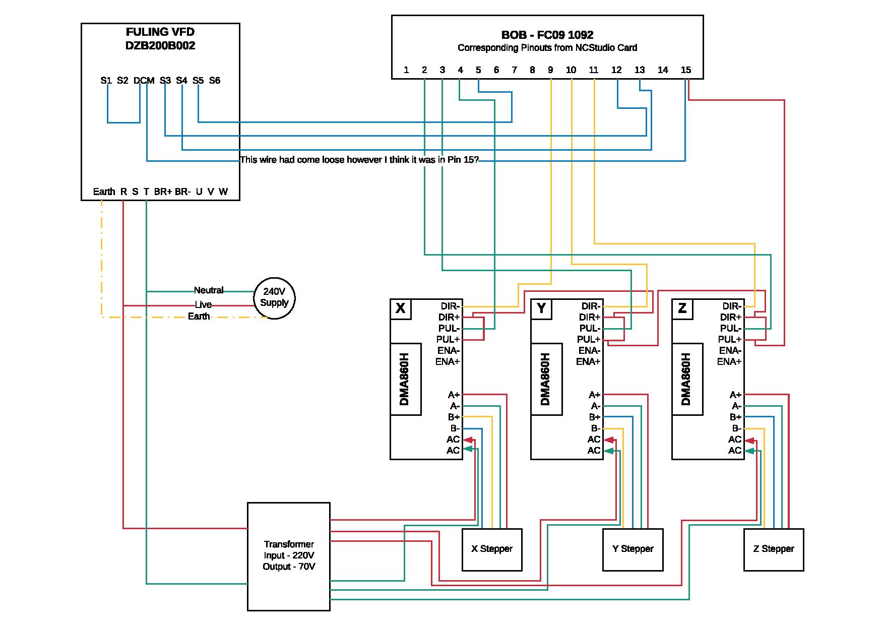

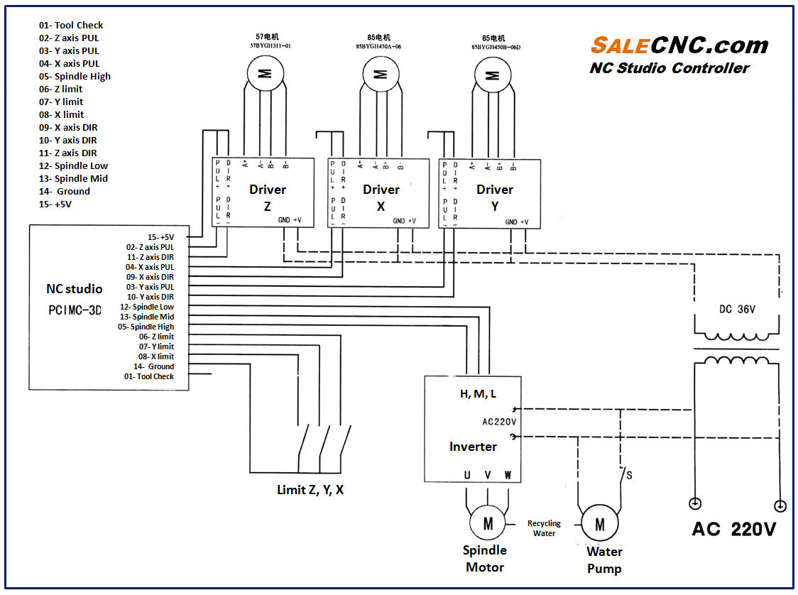

    I have attached a copy of the wiring diagram for my machine. The only thing I'm not sure is regarding the Invertor wire from connection "DCM" which was either disconnected or I've disturbed it tracing the wires, from an old photo it looks like it was into pin 15 but not 100%. As previously mentioned the original spindle was disconnected so I'm not sure why the invertor was also not disconnected?
    I have left out the limit switches, these were connected to pins 6, 7 & 8 with the power coming from pins 14 & 15.
    I have also attached a wiring diagram for NCstudio that I found online which basically matches my setup.
    Hopefully someone will give me some idea of replacements breakout boards and some guides to changing over the boards, to allow me to use Windows 10 and either UCCNC or Mach 3/4?

    Lives in East Lothian, United Kingdom. Last Activity: 14 Hours Ago Forum Superstar, has done so much to help others, they deserve a medal. Has a total post count of 2,994. Received thanks 376 times, giving thanks to others 9 times.
    That should be relatively easy to convert to a different controller.
    Regarding the VFD, from memory, DCM is normally a 0V which I would expected to connect to pin 14. However you really need to find a manual for the VFD. If you were to go for a CNCdrive UC controller, I'd probably suggest the UC400 along with a suitable breakout board.

  8. #7
    Hi m_c
    Thanks for replying to my post, after some research I think you are correct the DCM pin looks to have been connected to pin 14. I found the following video on Youtube
    I have also linked a copy of the user manual for the VFD, if you get a chance could you confirm?

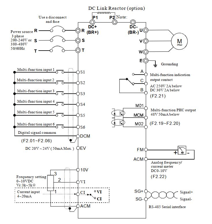

    I'd double check with a multimeter, but I'm pretty sure the DCM should go to 0V (it's been a while since I've had to wire up a VFD!). Hopefully somebody else will confirm.
    BOB wise, I'd guess the usual cheap generic 5-axis Chinese ones available on eBay is as good as any for a basic machine, as they include the needed circuitry to get a 0-10V analogue output for speed control. I'm not entirely sure if there is any difference between the green and blue ones...
    PSU wise, I personally prefer DIN rail mounted supplies, but there are lots of options. I'd think you'll only need a 12V supply, as the UC400 takes 12-24V, and everything on the basic BOBs uses 12V (plus I think you need 5V via the USB for powering the step/dir outputs).

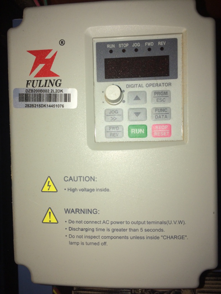

  10. #9
    Typically, S1 and DCM would go to a relay, with the relay closing the circuit between them.

    Not sure what they were doing with S3-S5?

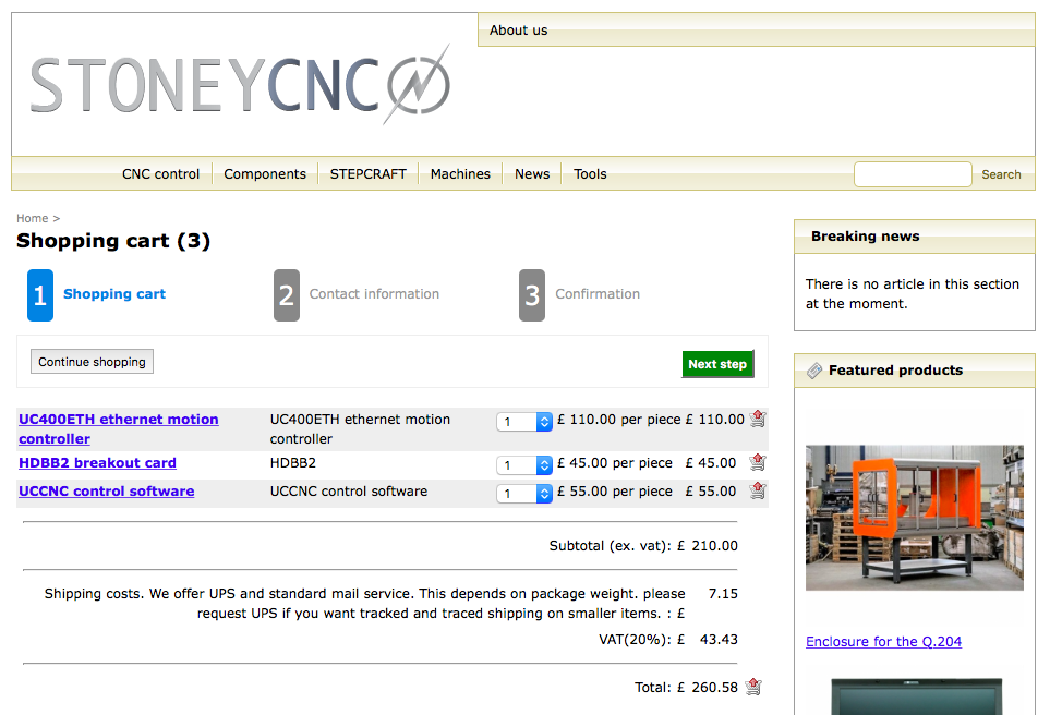

    I am about to order the UC400ETH along with the UCCNC software, however as I will also need to upgrade the breakout board I have found this to be a bit of a headache due to the options available. I have found the following three all on various websites can anyone recommend a BOB that will be compatible, and what the difference is between a £10 board to a £50 board?
    CNCDrive
    CNC4You
    eBay
    I have also found on Stoney CNC using the HDBB2 board (see attached), as they are UK based presumably they would arrive before Christmas, Ideally I would like to get the machine up and running again during the holidays.
