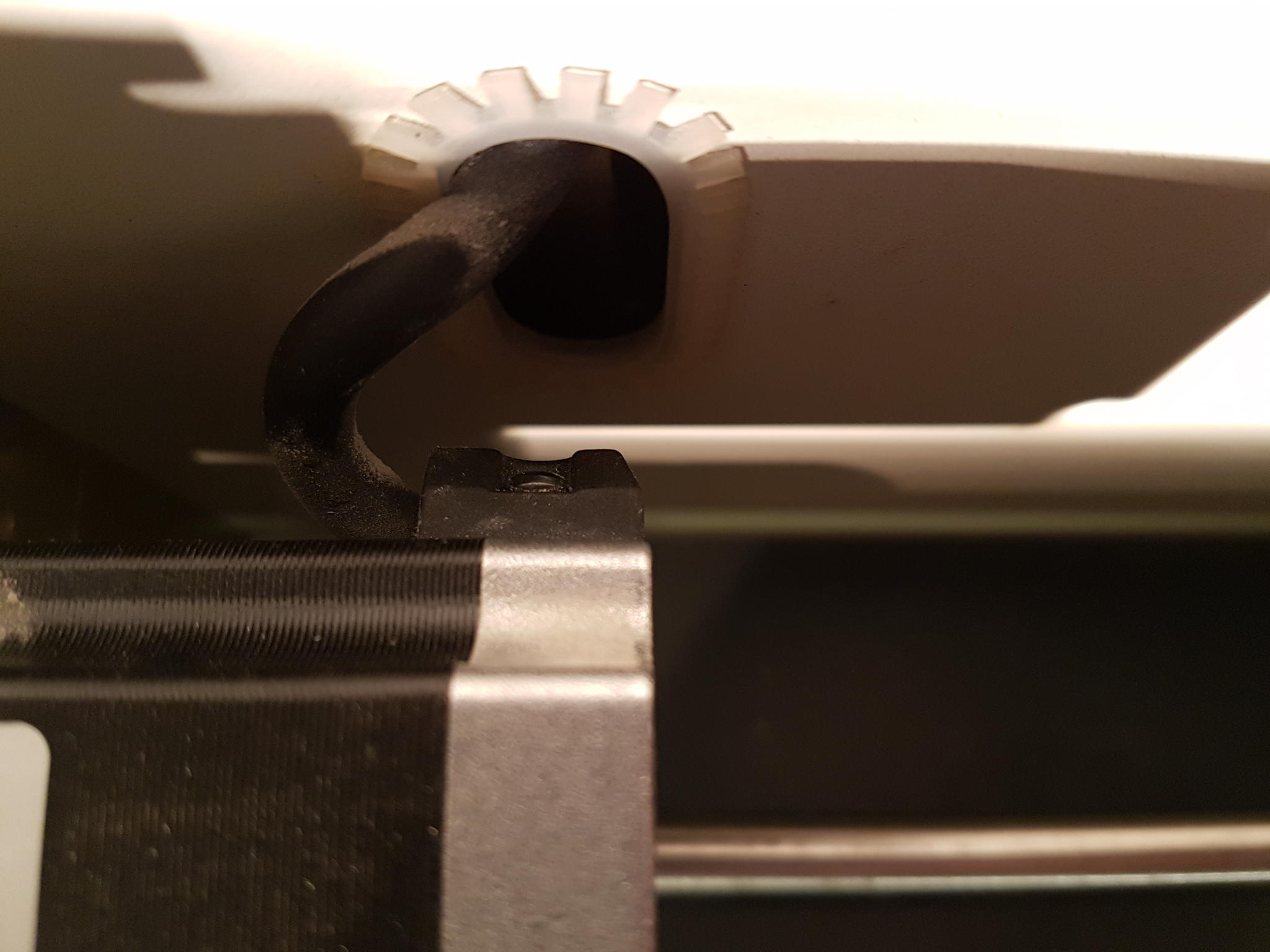

    Here is a pic of the set up....

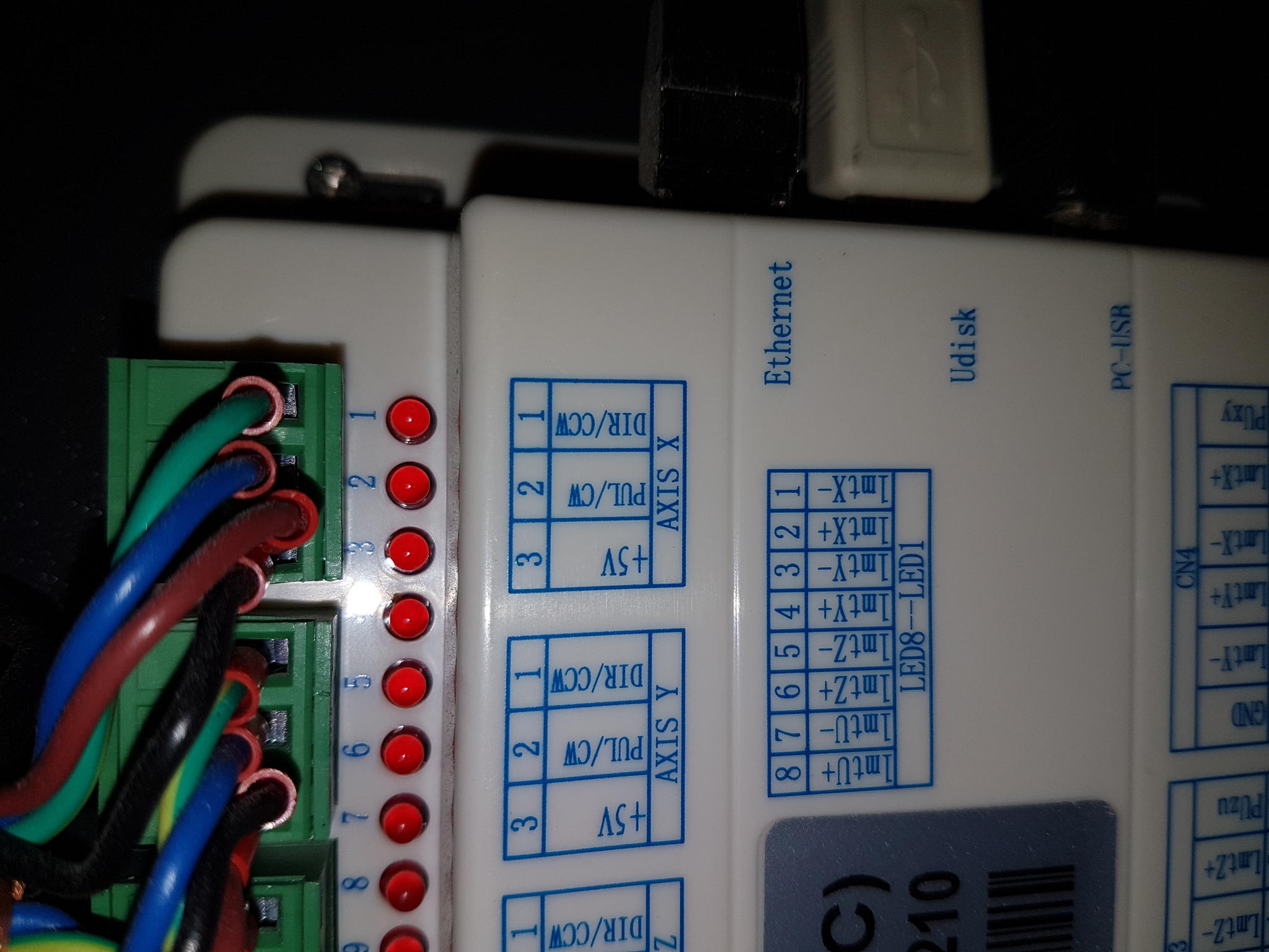

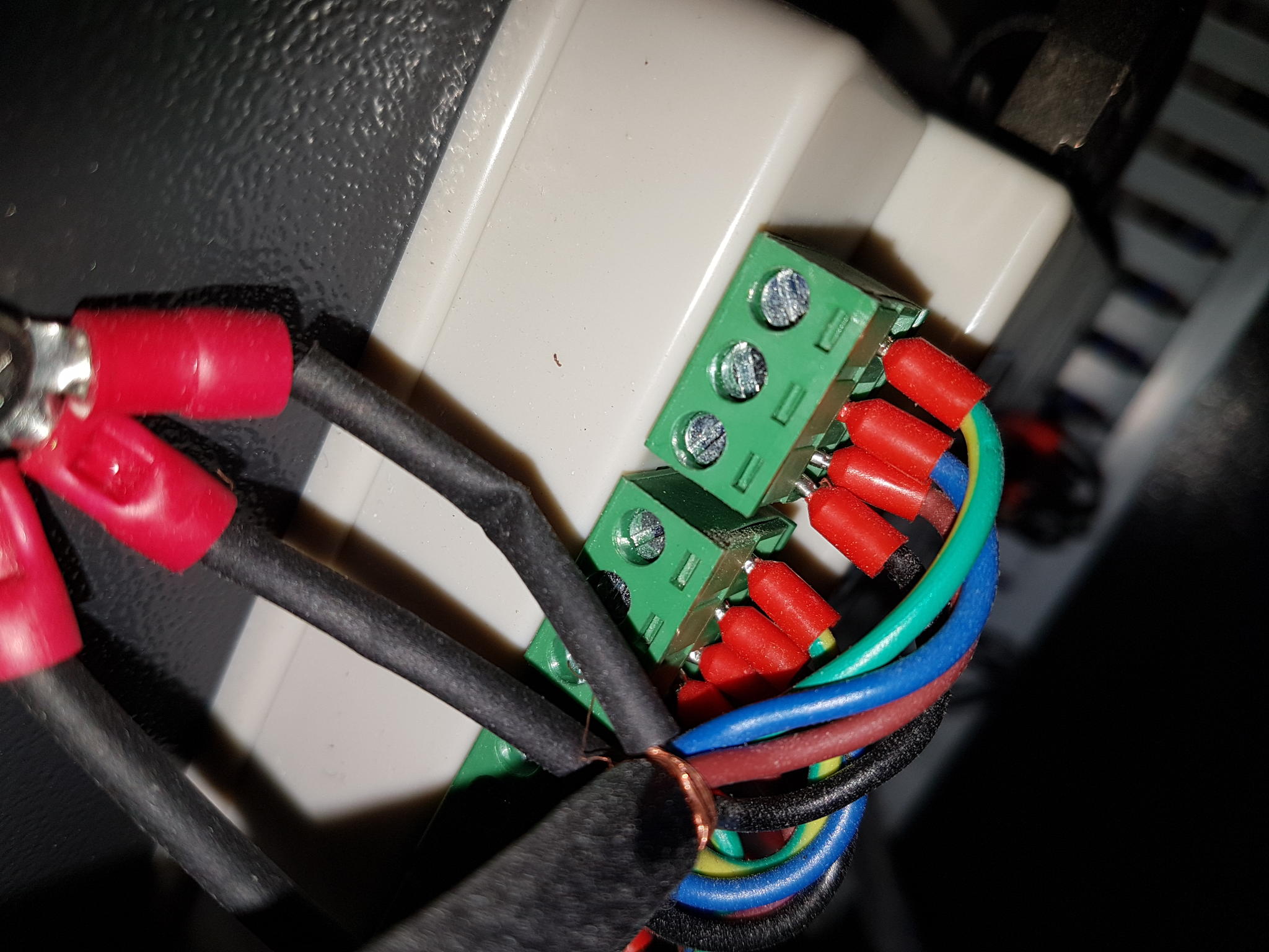

    How is the cable connected at the motor end? Is there a connector? Or are the wires soldered? Does the motor have 4 or 8 wires? If you disconnect it you can check the impedance of each winding with a multimeter on ohm reading and see if you get same values on each pair. Then connect with another cable or 2 cables with 2 wires, anything you may have around.
    By the looks of it at the rear of the motor there is a black block connected to it which has a single black sheathed cable going through the panelling and straight down to the controller unit.
    The wire has 4 strands, black, blue, green/yellow and brown. Black and brown are linked together in the controller, green/yellow and blue are on their own. I've attached a picture of the controller unit so you can see how they enter.
    Can I just take the connecter block off and check or does it need to be at the stepper end?

    Those are not the wires going to the motor but the signal wires going to the drives. The motor wires are connected to the black drives from your first post picture (A+; A-; B+; B-)

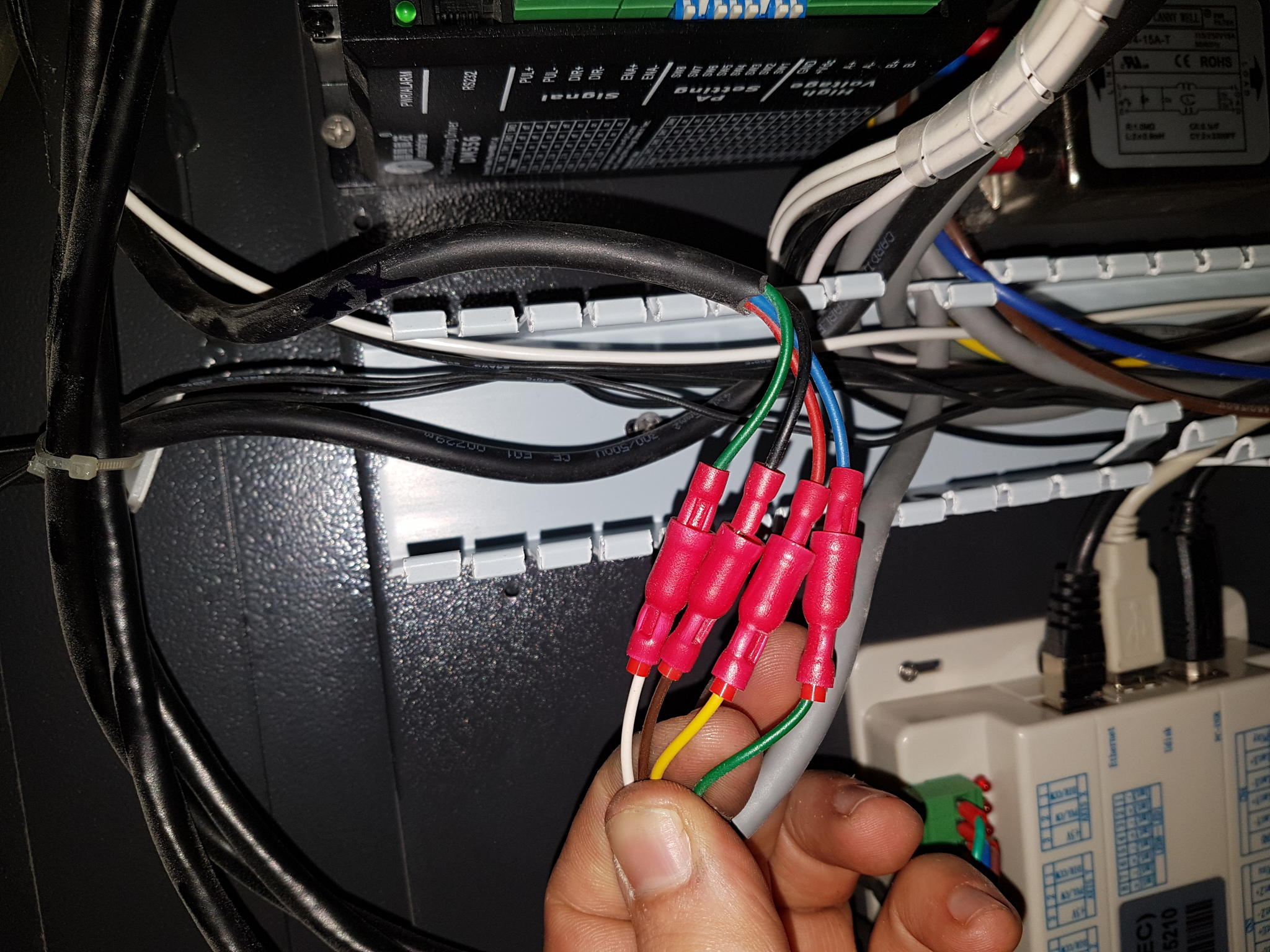

    So this is where I am at. Ive traced the wires back from the motor.....
    1 - Wire direct from Y axis motor, Green, Black, Red, Blue which go into White, Brown, Yellow, Green respectively

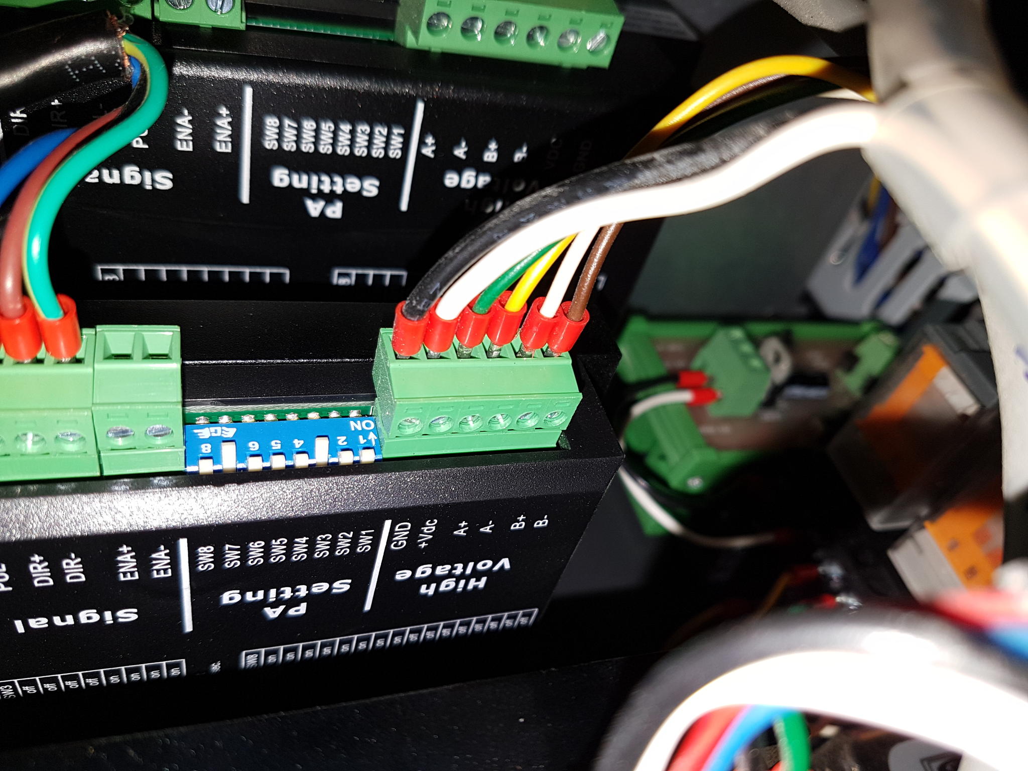

    3 - The wires then exit and come into the controller

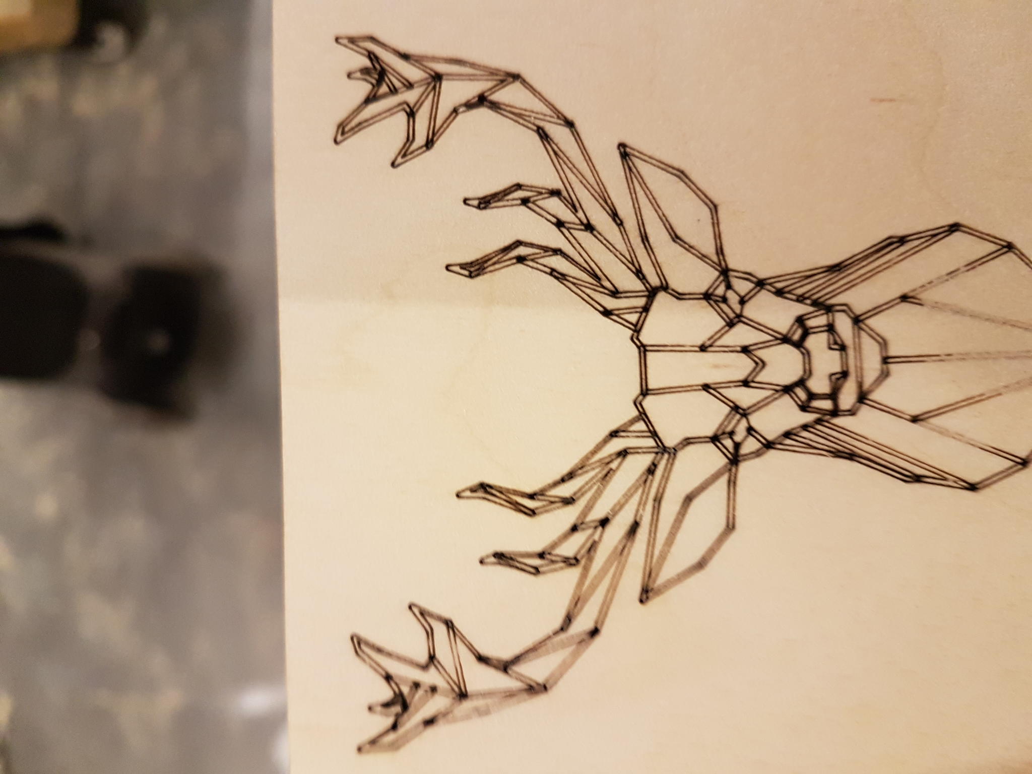

    Just in case anyone is interested...
    This is how a vector cut at 150mm/s looks like when its working correctly...

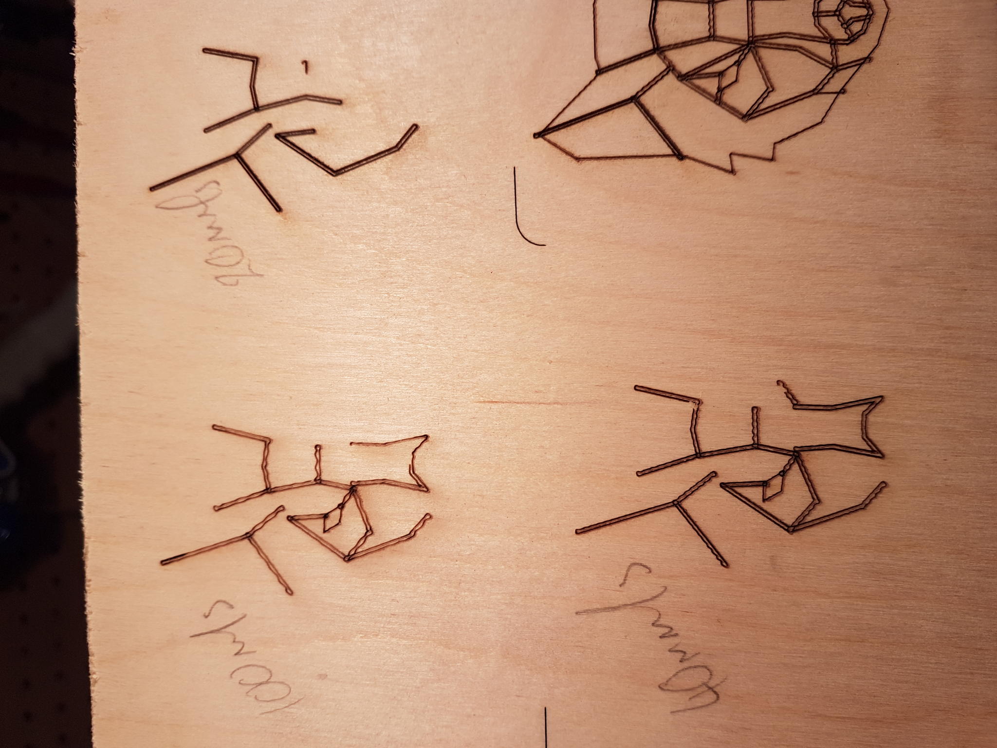

    Here is what I am getting at the moment, the speeds are marked in the corner...
    Could you bypass the relay and connect the motor cable directly to the drive? Blue wire to A+; red wire to A-; green wire to B+and black wire to B-
    edit: You can also check the resistance between blue and red and between green and black after you disconnect them.
