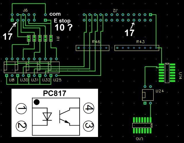

    Hello my first post so please be gentle. I wish to fit a z axis probe to my newly acquired ancient Chinese 3020 mill, I am running mach3 and the controller has the yoocnc t62-3ax board. I have got it working by connecting the probe directly to pin 15 of my parallel port plug on the computer and allocating it in the software, it works ok but I suspect I need to isolate it somehow.
    any help gratefully appreciated
    John
    by adding to the diagram from
    http://georgestone72.blogspot.com/20...for-3020t.html
    this may help
Name:	YOOCNC T62-3AX and pc817.JPG
    john

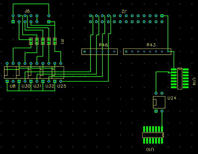

    thanks John but I cannot see that picture on the link you have posted is there another page?
    the original picture taken from
    is this -
Name:	YOOCNC T62-3AX.JPG
    it looks like its the x-ray view looking through the board

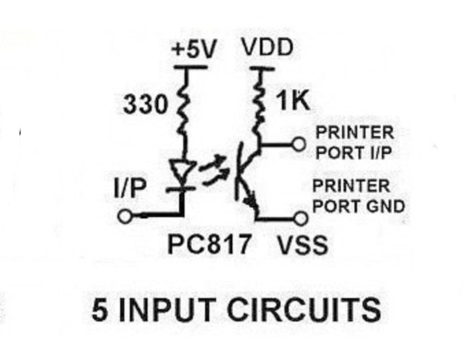

    its possible the input circuit is going to be like this -
Name:	opto-isolated input circuit.jpg
    VDD is the +5V supply for the printerport side of the circuit
    the common 0V being the input common

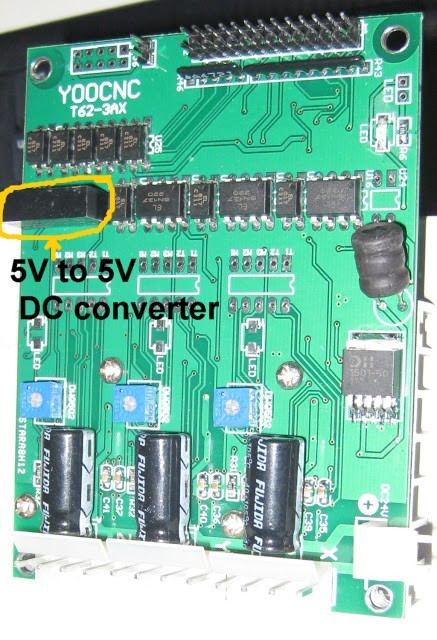

    on another picture you can see a DC/DC converter to provide the isolated supply for the input circuit
Name:	DC to DC converter.JPG
