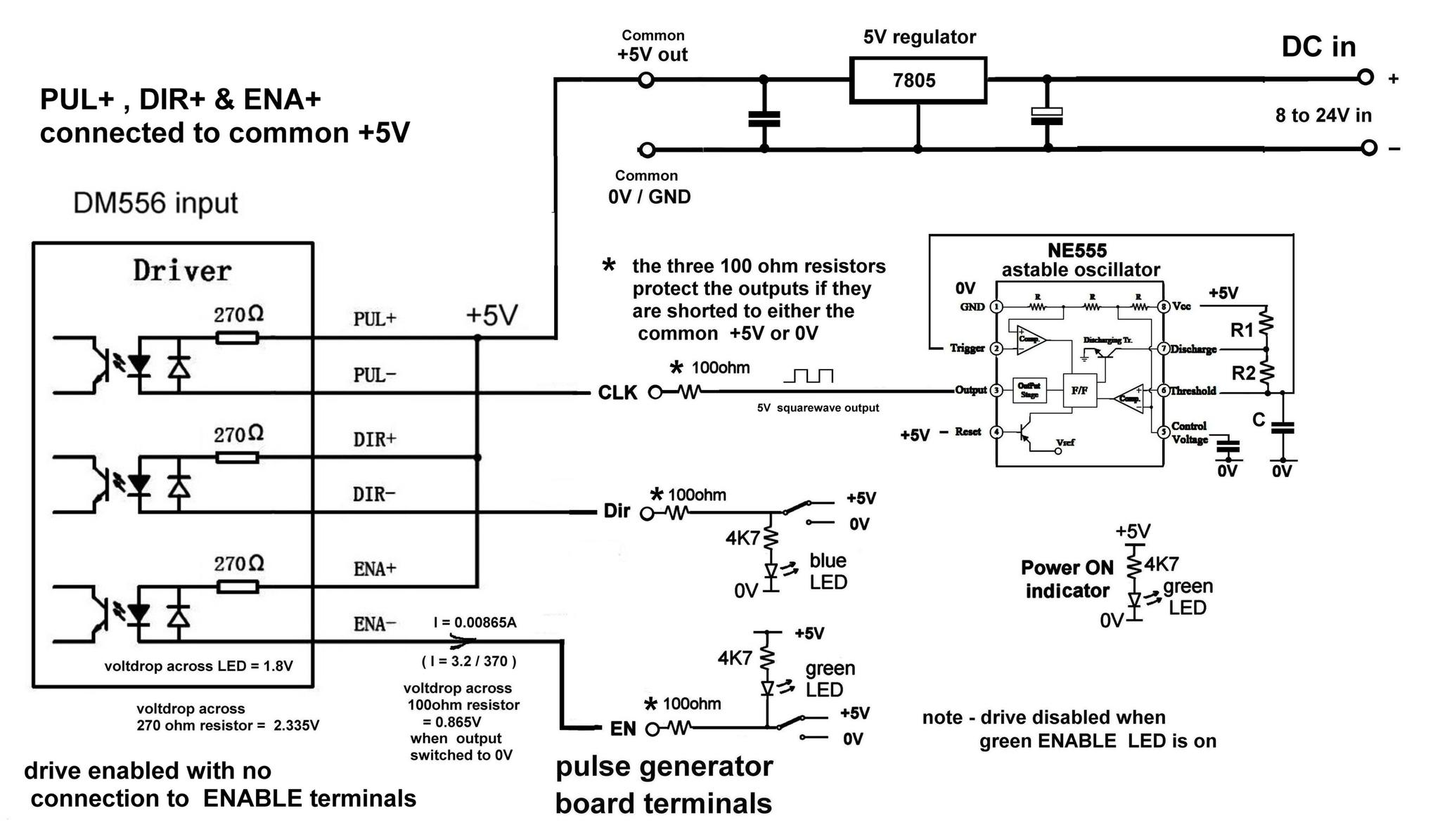

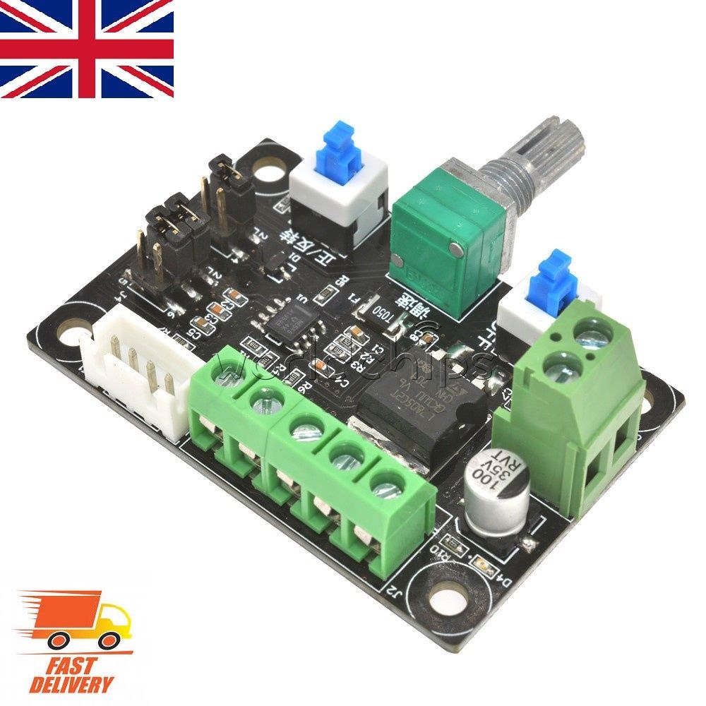

    But I came with an alternative idea. I just ordered a Stepper Motor Controller PWM Pulse Signal Generator in which I can control the speed of the A axis manually

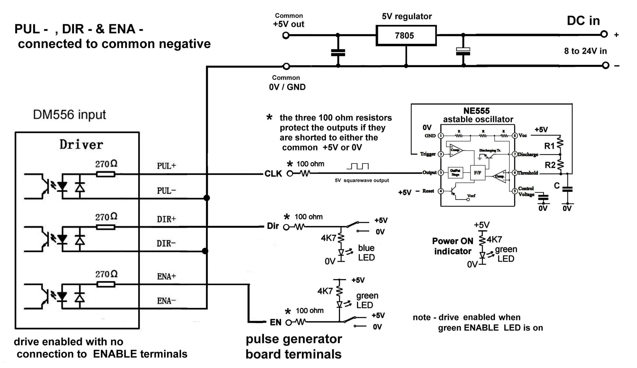

    Hi Ladybreaker
    do you have the pulse generator ?
    and did you get any instructions with the board ?
    two possible ways of connecting the pulse generator to the stepper driver

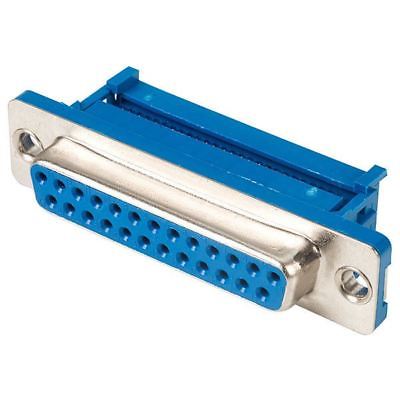

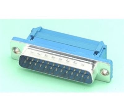

    are you fitting the pulse generator inside of your CNC control box as a permanent fixture
    if your connection to the control is via the parallel printer port
    its possible to make a modified printer cable to make a temporary connection between the pulse generator and the CNC control box
    to save soldering 25 wires
    connect an IDC plug and socket to a ribbon cable

    then cut a ground wire and the step & direction wires for the 4th axis from the plug
    then connect the pulse generator to the 25 way socket

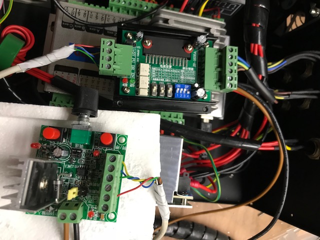

    I'm very please with mine , it was strait forward and it worked , yes i do intend to fit the pulse generator inside my existing cnc box with the preset at the rear and two holes on the side to get access to the two push switches.
    I used my existing motor controller which is a JP-1635A as you can see from the photo, I used the same connection from my controller to the pulse generator 5V P+ DR EN.
    Hi
    I see the pulse generator board you have bought
    has a wide range of Power supply voltage: 15-160V / 5-12V
    so it can be powered by the same supply as the stepper driver which simplifies things
    John
    If you make 6mm holes for switch access you can make neat little Top-Hat shaped buttons to fit from the inside of the case prior to fixing the pulse generator, it makes the job neat, the buttons easy to access and leaves no ingress for chips and muck.
