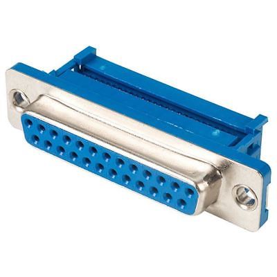

    are you fitting the pulse generator inside of your CNC control box as a permanent fixture
    if your connection to the control is via the parallel printer port
    its possible to make a modified printer cable to make a temporary connection between the pulse generator and the CNC control box
    to save soldering 25 wires
    connect an IDC plug and socket to a ribbon cable
Name:	25 pin IDC plug.jpg
Name:	IDC socket.jpg
    then cut a ground wire and the step & direction wires for the 4th axis from the plug
    then connect the pulse generator to the 25 way socket
    John
