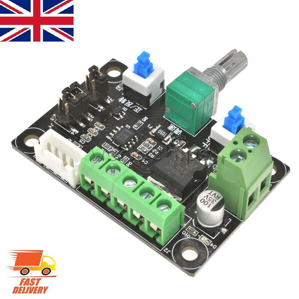

    I'm very please with mine , it was strait forward and it worked , yes i do intend to fit the pulse generator inside my existing cnc box with the preset at the rear and two holes on the side to get access to the two push switches.
    I used my existing motor controller which is a JP-1635A as you can see from the photo, I used the same connection from my controller to the pulse generator 5V P+ DR EN.
    Hi
    I see the pulse generator board you have bought
    has a wide range of Power supply voltage: 15-160V / 5-12V
    so it can be powered by the same supply as the stepper driver which simplifies things
    John
    If you make 6mm holes for switch access you can make neat little Top-Hat shaped buttons to fit from the inside of the case prior to fixing the pulse generator, it makes the job neat, the buttons easy to access and leaves no ingress for chips and muck.
