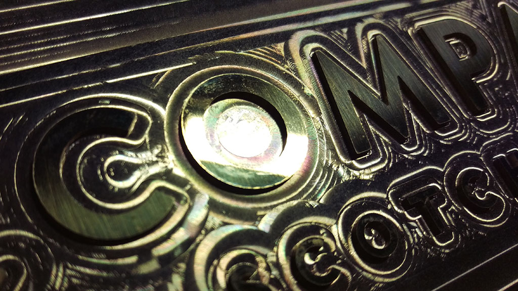

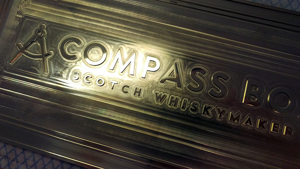

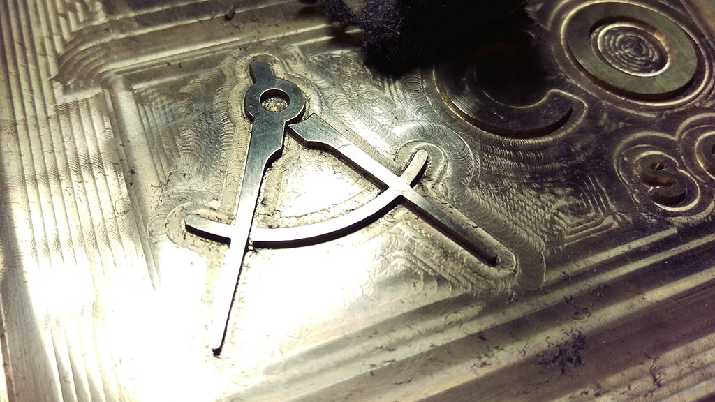

    Hello all.
    Had a recent commission to make a one-off brass sign with a rather large area that needed gloss black resin... I did the metalwork on the new(ish) gantry router that Clive and I built last summer (with his help I'll be upgrading it to two screws on the long axis in the not too distant). There was a bit of resonance, but nothing that caused any problems. I'm happy to go slow to keep those cutting forces low...
    I used 0000 Grade steel wool to de-burr and 'relax' the sharp machined edges before polishing and cleaning it a few times over.
ID:	25187 Click image for larger version.
ID:	25188 Click image for larger version.

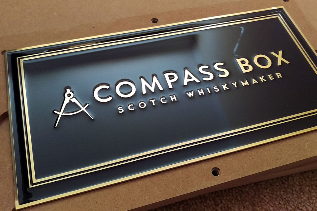

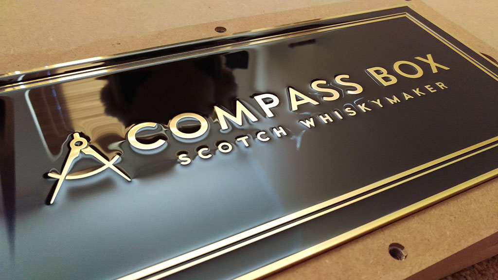

    My DIY resin approach is fine for smaller scale stuff, but for this rather large job I took the resin work out of house to a company in Hockley, Birmingham - Capricorn Coating Services - the results are superb. A few pics:

    Before commencing work I drilled and tapped four shallow M6 holes to the rear of the plate - these will accept 60mm studs that will get epoxied into four holes drilled in the wall. Overkill..? Probably..
    Wal.
    Lovely job Wal!
    Though we expect nothing less of you ;-)
    - Nick
