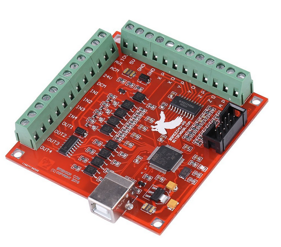

    Here the picture of the board:

    In the manual it says that you have to connect limit switches to the I1 - I4 inputs (as printed on the board - common to all switches is the "DCM"-called input ). In mach3 you then configure these inputs in such way that you define the input in relation to the axis - like I2 for X, I3 for Y and I4 for Z.
    Interesting enough - in mach3 these Input pins now have different names. As far as I found out I1 correlates to a pin 10, I2 correlates to pin 11, and so on. You can also configure in this section (Ports & Pins...) if you are using a NO or NC switch.
    Theoretically you can view your Input setting at the Diagnostics-page but nothing reflected there.
    So my general question:
    Has anybody experience with this kind of "Chinese Controller" and give me some guidance to get this machine up and running properly? For those who possibly can - be sure to be includes in my evening prayer!!

    I have no experience with those Chinese controllers but I'm sure you could find on google the info you need. I think your only problem is assigning in mach3 the corresponding port and pin number for the input you need.
    If you suspect something wrong with the controller you could check at least that the input signal goes through the optocoupler.

    Mach3 was designed to work with the parallel port. There the pins are straightforward, numbered from 1 to 17 and if there is one parallel port it is port 1.
    With the USB and ethernet controllers, the inputs and outputs need to be emulated so that mach3 thinks there's one or more parallel ports. Each controller manufacturer can assign what port and pins number they want to their inputs and outputs. For example the CSMIO IP-M controller uses the port 10 in mach3, if I remember well.
    edit: So the manufacturer should provide for each input and output the corresponding pin and port to be assigned in mach3.

    Hi paulus.v,
    have checked the couplers - working fine. 24 Volts the input swing, 5 V the output swing. Detected with mach3 a page where the USB-Contoller is checked. Shows, besides other things, the behaviour of the inputs of the USB-Board. There you can see the switches work!?
    Now whats preventing mach3 not to read this!?
    Maybe I contact the mach3-provider?
