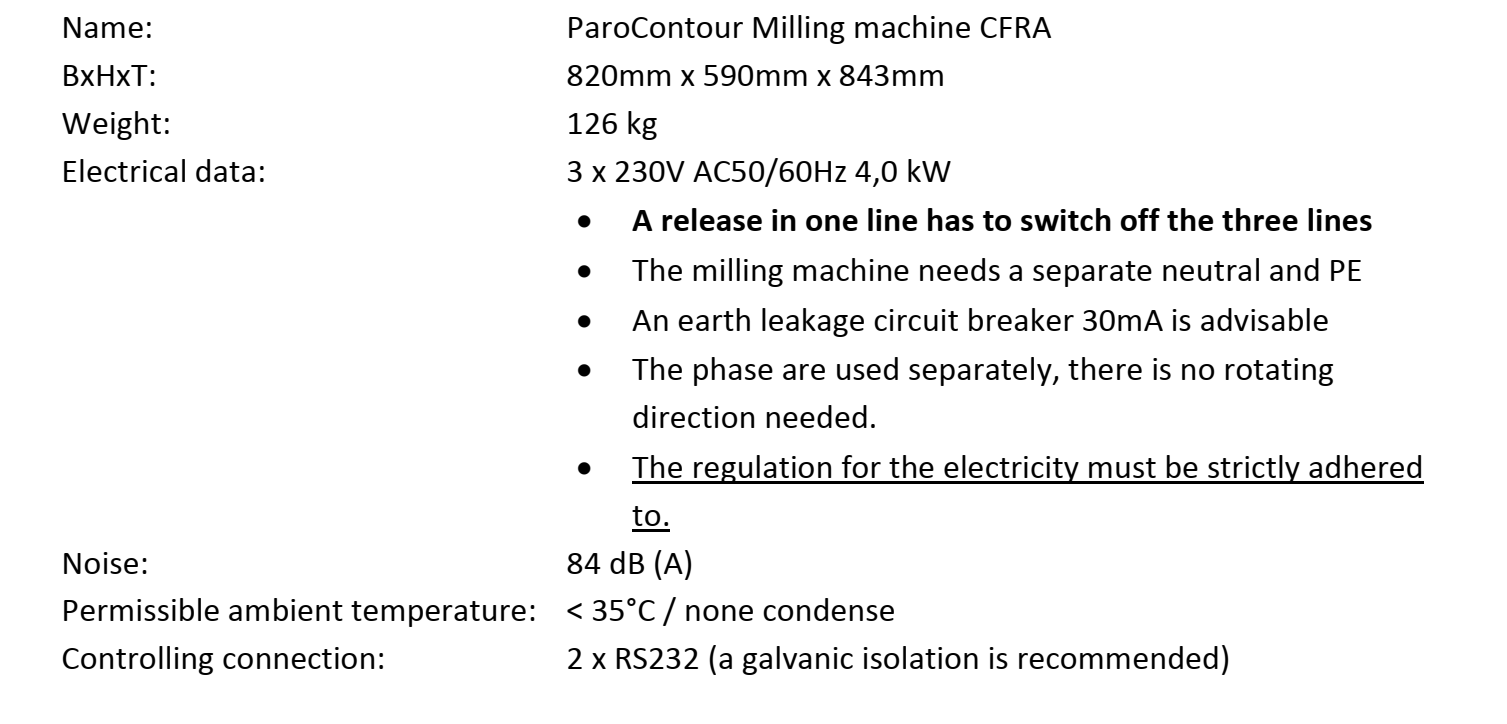

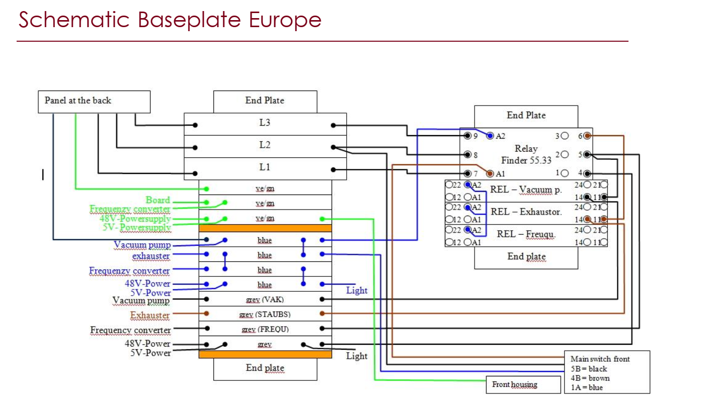

    Long story short,
    Snaffled a Mill, moving table with 2 axis gantry, Informed it was 3 phase also using an external vacuum pump and extraction. I may be able to get hold of the PC (running XP) that ran the system but all software is in German.
    Evidently, a reluctant somewhat difficult operator stated one day 'it started smoking' and it was abandoned and forgotten about (the person left the organisation shortly after) until a decision was made to dispose of it.
    No specs or decent manual and none forthcoming from manufacturer (I've checked)
    At present I can reach through the underside and the spindle turns but the bearings don't feel good. I can see a stepper/servo and all axis are belt driven. I cannot open the 'user' door as without power the interlock is in operation. The mains cable has been hacked off and the remainder stuffed back through the grommet. I do not have any other cables.

    My questions are what can be deduced and what suggestions are forthcoming. I admit to having pretty serious wishes to get this machine running, either in this form or by cannibalization to reuse in a DIY Build.

    The door interlock will need power to release. Some have a way to manually override (that's provided you can get into the main latch), failing that you might need to unbolt it (can be easier said than done!).

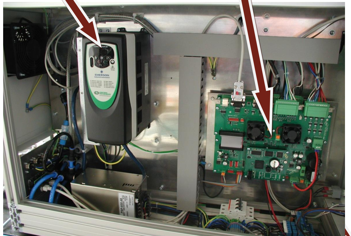

    Some photos of the machine would help. Also a close up of that control board on the right. I'm going to guess it's a stepper driven machine, in which case the worst case scenario are a few new drivers, a new controller, and possibly a new VFD (can you get a photo of the label on the side of it?).
    Photo's I can get, as soon as I can rustle up the help to get it upright. I have just been told that the side it is sitting on can be removed which will give access to the VFD and main board. I will upload as many as appear worthy of inspection.
