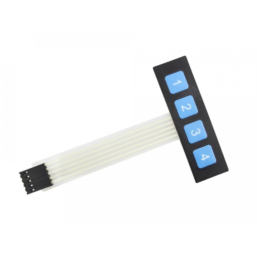

    What I could not find is function nr 3, or moving the steppers in the way I want. I've also seen keyboard modules with 4 buttons which can work as great as a joystick module. It is the same for me. Pressing button nr1 gets the steper at 0 degrees, nr 2 at 90, 3 at 180, and nr 4 at 270. Click image for larger version.

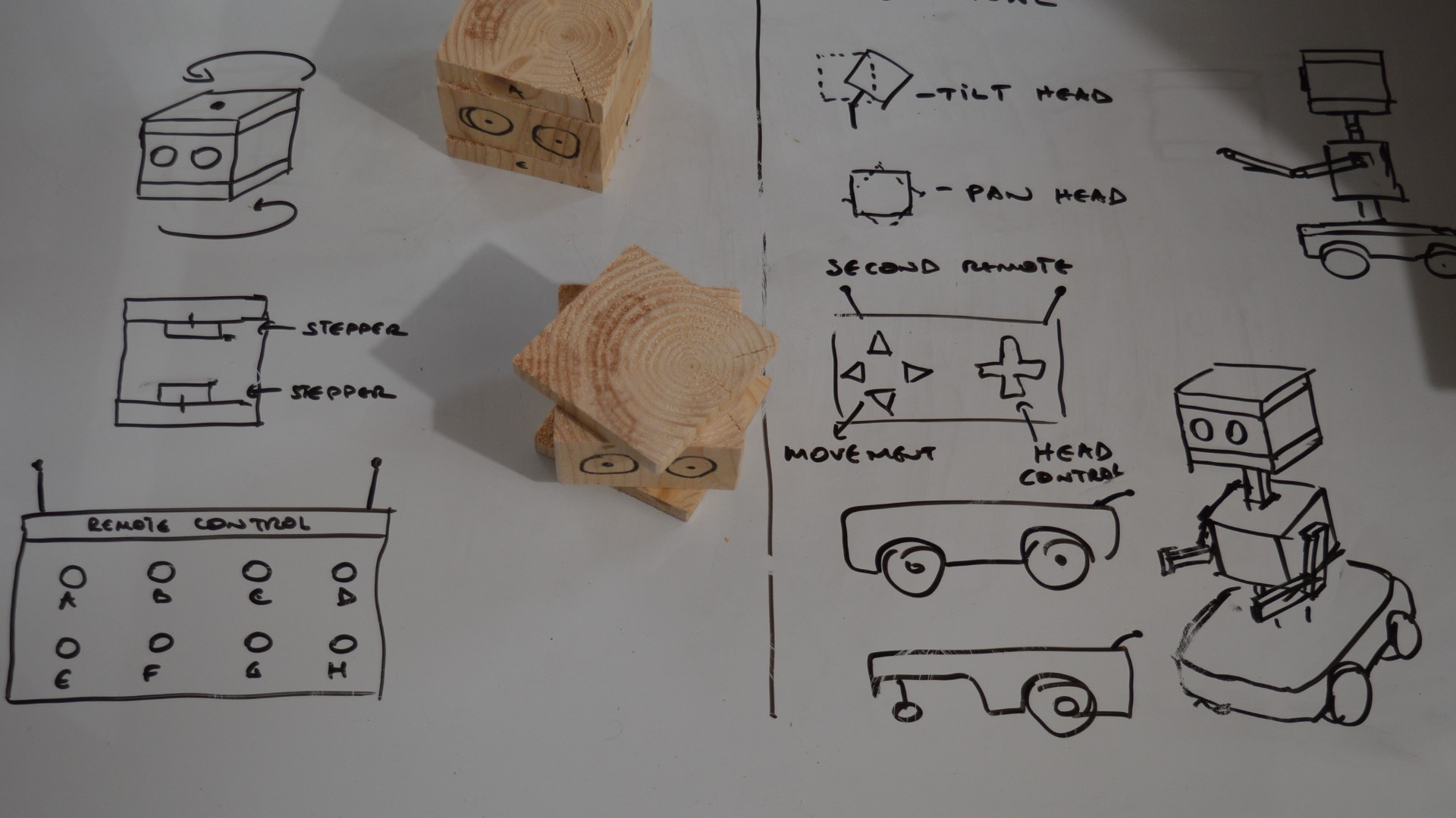

    I can use this function in many things (ex: furniture secret compartiments operated by a mixture of electrical and mechanical parts), but for this specific case, it is as you can see in the foto in the left side. Click image for larger version.
ID:	26757. I need to rotate parts of his heads, and might also be useful for body configurations, on 4 sides. It might be as simple as some writing on this 4 sides, but for now, I don't know exactly all the details. I just need the function done. (wiring and programming). The body and the case, I'll figure out after I find out the exact size of the electronics needed. (which does not have to be arduino, it can be anything else. If it works as intended, then I'm fine with whatever).
