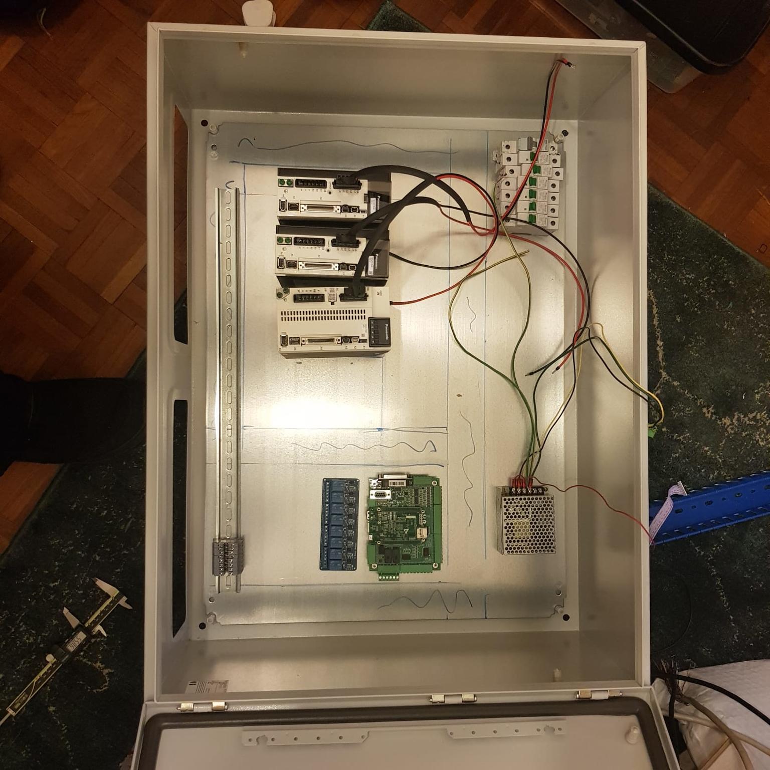

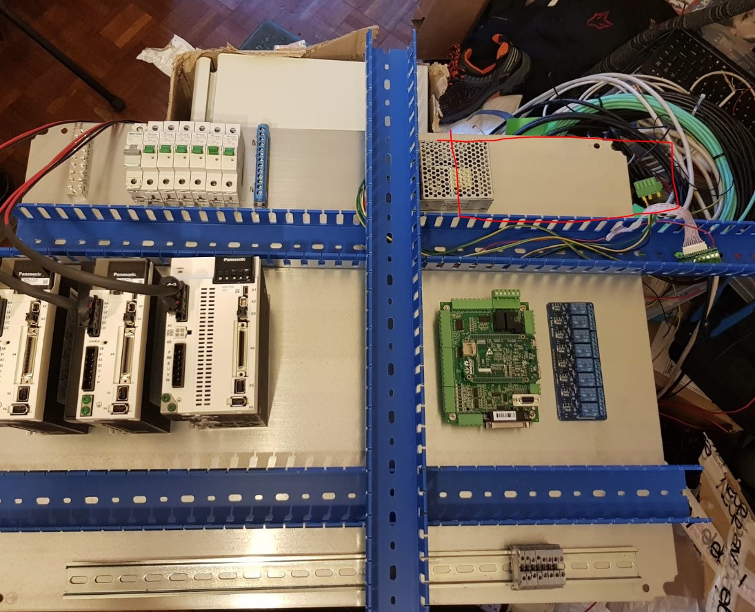

    Chaz's Avatar
    Managed to get two of these 800 x 600 x 300 enclosures for fairly cheap. Perfect for this (I was thinking to use the original box), but this will work too.
    Testing a layout. Any thoughts / concerns with what I am proposing? The VFD will be placed externally.
