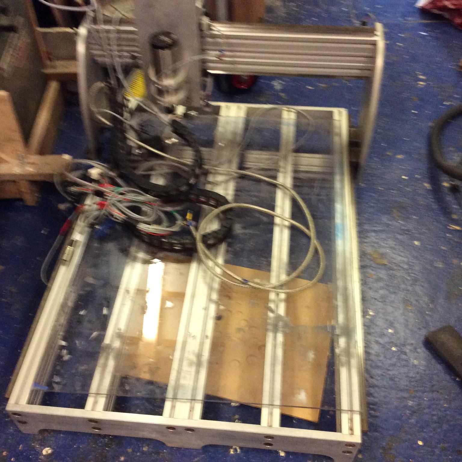

    Every days a school day. Yes I must have inadvertently turned on soft limits. I have them configured, so I think I may leave them on as it didn’t seem that much of an inconvenience especially when I sped up homing. Btw - here’s a picture of my machine, which I am remiss for not sharing it’s been finished for almost 18 months.

    Dinky little cyclone separator there - any more info on it? Does it work well?
    This looks like one of Deans designs.
    Well spotted... this is what it looked like when I got it. A lot of phone support followed from Dean to get it working.
